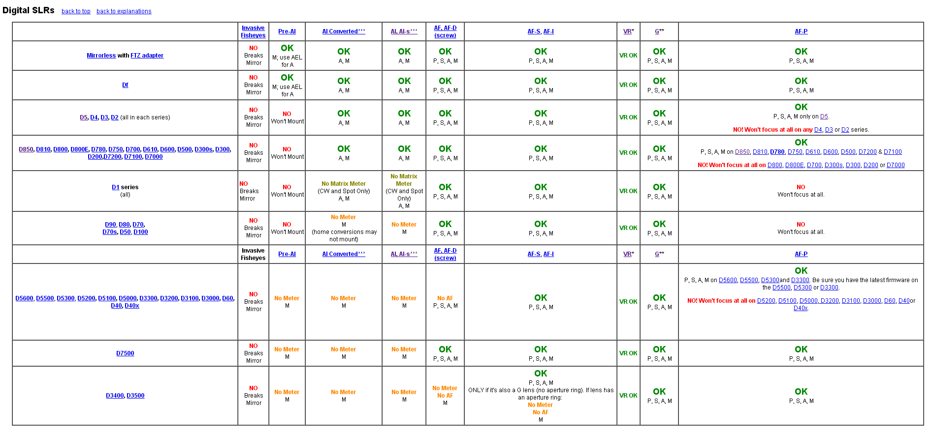

You have extensive information here:
https://www.kenrockwell.com/nikon/compatibility-lens.htm
For the record:

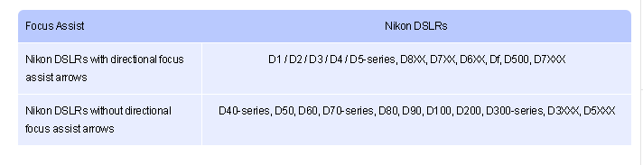

You may use the focus assist feature:
https://photographylife.com/using-manual-focus-lenses-on-nikon-dslr-cameras
I would use single centered point focus mode to check focus with the focus assist, as you see all those DSLRs have focus assist, but in the more Pro range you are also informed the direction to what the ring has to be rotated, while in the more consumer models you are only informed about if focus is nailed or not. At least in my Nikon D3200 I have to half press the shutter button to make the green circle appear in the viewfinder bottom, it only appears if focus is nailed, so you half press and then you rotate the ring, when focus is nailed then the circle glows, then you fame and shot.
