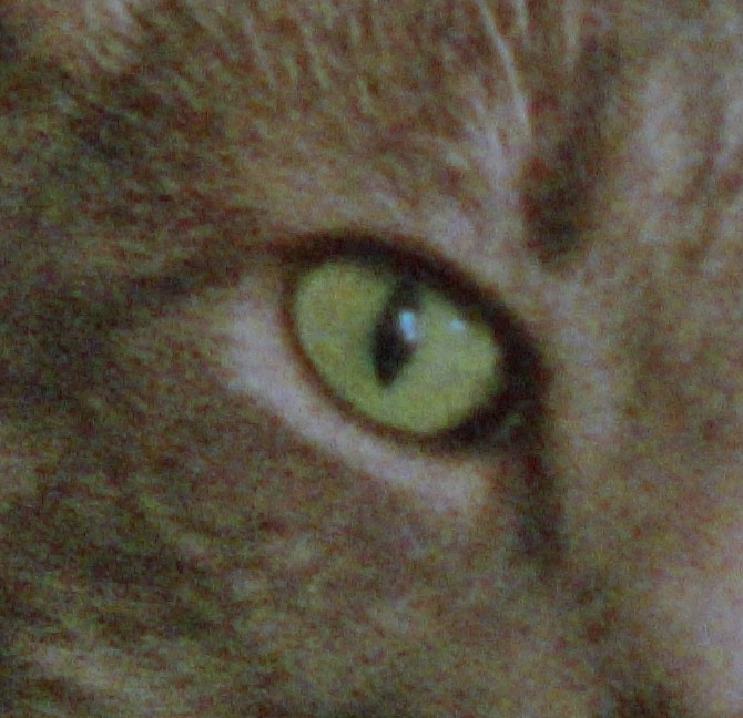

First, a 100% crop from the Epson V800, scanned with Silverfast SE+ at 3200 PPI (~ 14 megapixels). Negafix was the only active module. Sharpening applied in post. My personal opinion, there is more apparent detail in the eye on this photo, than anything I've been able to manage on the DSLR.

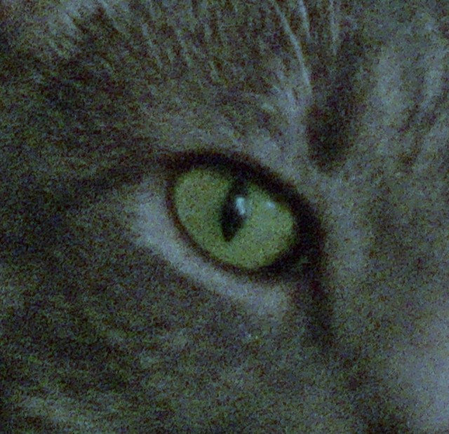

Next is a processed image (28 MP) from the 90D + 100mm f/2.8 macro @ f/5.6 (Shot RAW, processed with Canon's DPP 4, inverted via Darktable+negadoctor, dust removal and sharpening applied via Affinity Photo):

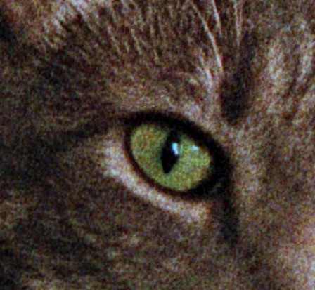

And then just to be paranoid, here's a 90D RAW f/8 shot, inverted only, no color correction:

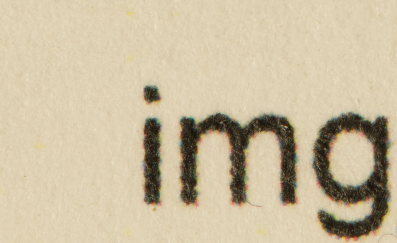

I considered a possible sensor or lens issue-- I'm using an inverted tripod with a horizontal beam, leveled with a 2 way spirit level in the hot shoe, and a very nice, heavy, level, workbench. I'm focusing using 10x zoom ('micro focus') and I'm focusing on the grain itself. Still, I did drop my macro lens a couple months ago, so I thought I should check it:
Just a scan of my proof sheet, but the detail is pretty good-- you can even see the yellow anti-counterfeit dots if you look closely. So I don't think it's my lens.
Any ideas? I don't have the light issue totally surrounded (so to speak), so as I said, there's what I consider a mild lack of contrast, but I wouldn't think that would rob detail as much as I'm seeing.

Is there any chance that the lens focuses correctly on the piece of paper but is slightly missing focus on the negative for some reason? The DSLR images to me look more like missed focus rather than vibration blur.
I did make one change which improved the detail somewhat-- I flipped the negative over so the emulsion was up.
Looking at them again on something other than my phone, I think that missed focus is a highly likely cause. Is the camera using phase or contrast detection, or a bit of each in live view mode?
I don't disagree-- but my method has been to use live view, zoom in to 10x focus, and set focus purely manually based on the film grain. I had read elsewhere that this prevents the potentially out-of-focus areas of the negative from confusing the sensor(s). The film has a bit of curl lengthwise, but the gates on the pixl-latr should be holding that relatively flat. Side to side curl is negligible.

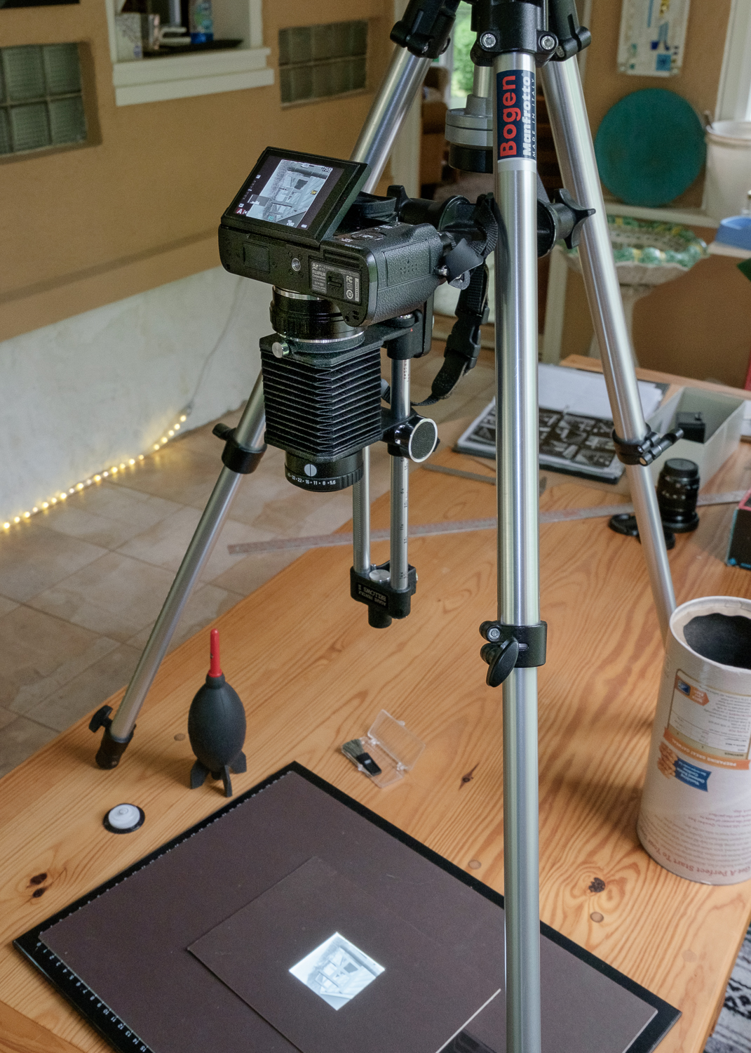

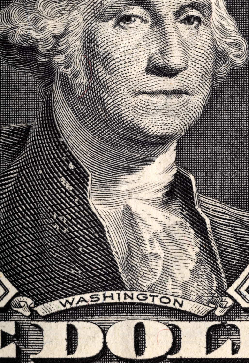

As for using a tripod as a camera support when copying film - they are fussy to set up, but it is possible to get sharp results. Before I switched to a copy stand (for convenience), I used a tripod with inverted column, and I tested it for sharpness. At first, my results were very soft because I was pressing the shutter on the camera, but after I switched to using a 2 second time delay for the shutter release, sharpness was good.
My tripod is an entry level Bogen/Manfrotto 3001 which is not particularly robust. And the light source that I was using at the time was not particularly bright, so my shutter speed was often in the 1/8th second range. The 100mm enlarger lens on an APS-C camera resulted in a sensor-to-film range of about 42-43cm to get the magnification needed to copy a 35mm negative. Below is a photo of my first copy rig and a test shot at about the required magnification. (I just noticed the photo shows 120 film being copied, but what I said was about copying 135 film.)
Since then, I have switched to a copy stand, a better lens, and a brighter light source that results in shutter speeds in the 1/60th second range, and my results improved only marginally.

Your tripod is a weak link. A wood tripod or copy stand will be a worthwhile investment if you plan to do DSLR coping of your negatives regularly. ,

that is missed focus. I have a 90D that I use for scanning. Your 90D has dual pixel AF that is extremely good when using live view. At the start of the roll, put the edge of the first frame inside the focus box and push the AF on button until you get focus confirm, then simply scan the roll. Depending on how you’re triggering, you may need to go into the menus and change the settings so it doesn’t try to focus when you take a photo. While you’re in there, change to first curtain electronic shutter if it isn’t already on.
secondly is your aperture, 5.6 is pretty much the minimum I’d consider as you need enough to DOF across the whole frame. If you can, shoot at f/8 or smaller. A little diffraction is more desirable than not in focus because the DOF is too small. It’s all a balancing act.
third, your lens of choice isn’t ideal for APS-C. The rendered resolution in the center of the frame is less than 20MP. What makes your lens so great is it maintains its resolution performance all the way out to the edges on a full frame camera, so for full frame, it’s quite high performance, but for APS-C, there are better choices.
