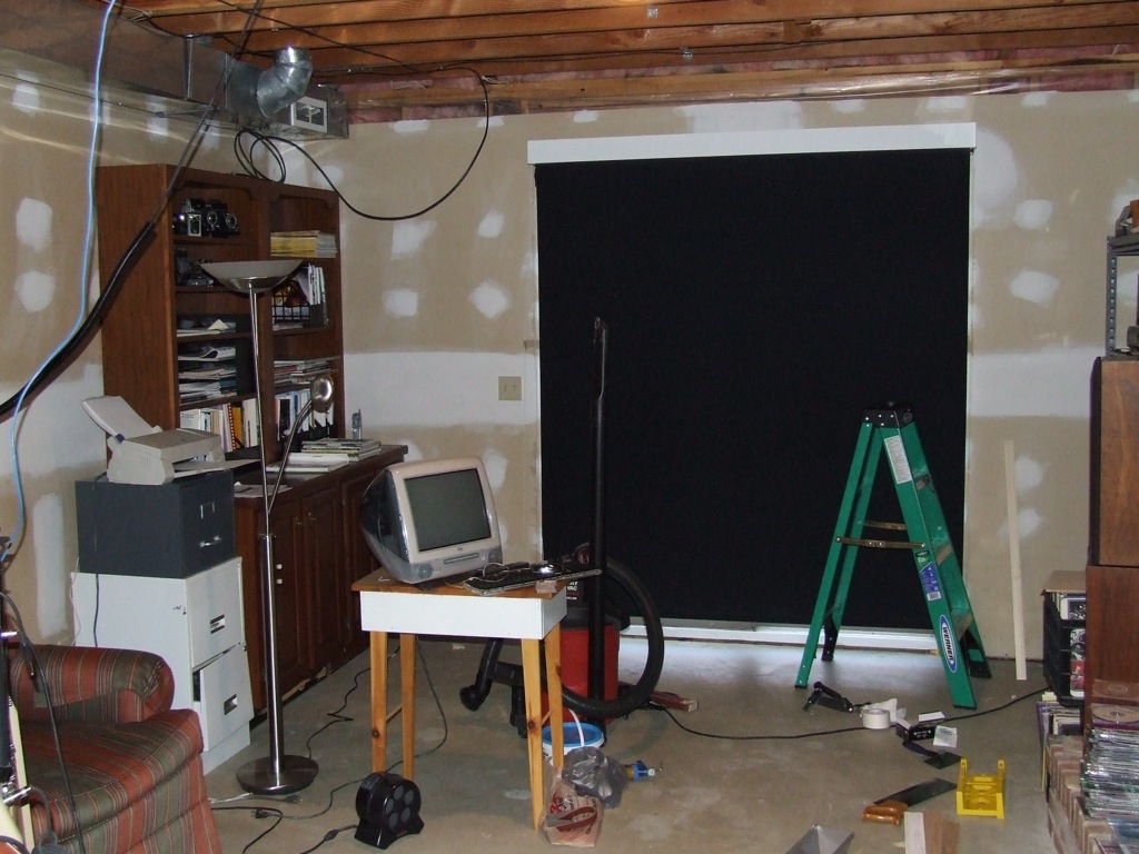

My photographs of the process don't show much. The texture of the plaster (or lack thereof) does not really show up. Anyway, here is a "BEFORE" picture. Realize that this is NOT my darkroom it is the room adjacent to my darkroom.

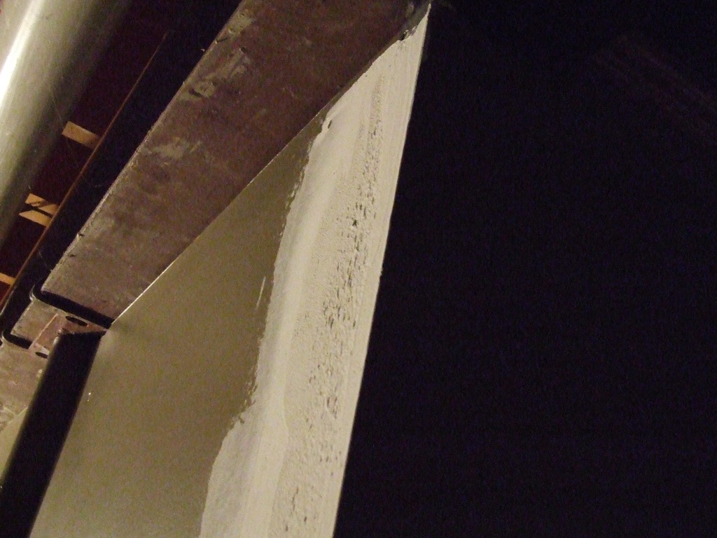

Here is an area on which I was practicing. This is dry plaster. Realize this is a test to see if it would be at all possible to smooth that bad of an area with the sponge...
