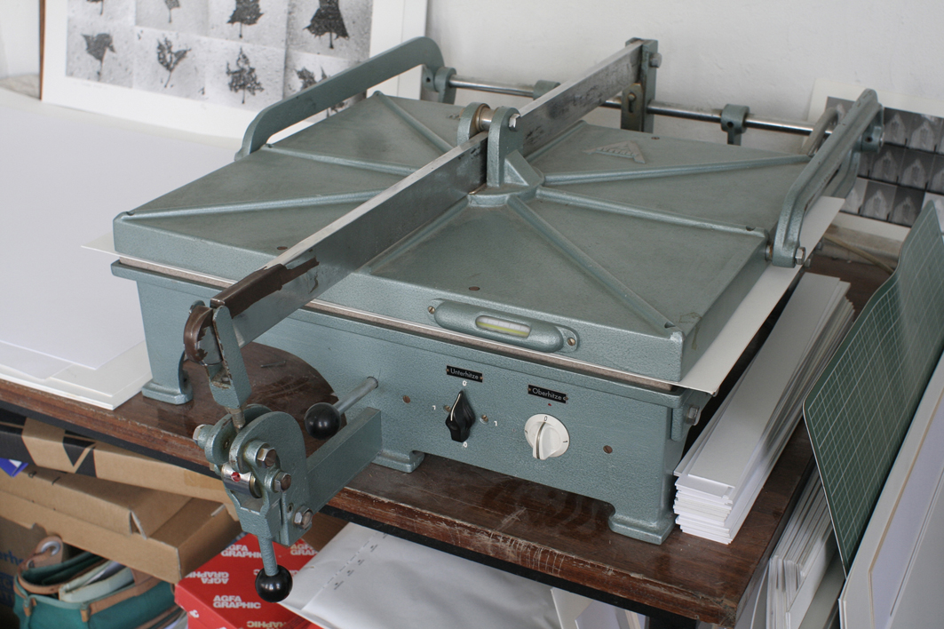

Attached a photo of my Büscher 50X60 press. I just brought it up to a new workspace, it weighs a ton . . .

I did not know that (to be sure I even locked at the Büscher site, to no avail).
That lock alone of your Büscher dry-mount press is amazing!
I know off at least three sizes for which Büscher made these presses: 30X40, 40X50 and 50X60cm. The press platen is always slightly larger than that. For years I had the 40X50cm version in which you can also do 50X60cm prints by pressing them in parts. The Seal 210 does that too.
I got the Seal 210 for the smaller sizes to take the workload away from the Büscher. The Seal is the more easy machine to work with, as it regulates the heating: turning itself off when the set temperature is reached (in my case 90 degrees). The Büscher has a switch for the upper part with three positions, you start heating by setting it on nr 3, and you go back to nr 2 when you reach the right temperature. I do not use the switch to heat the bottom part. When you find a press like this, just check by setting the switch to nr 3 - it should reach 90 degrees after about 20 minutes.
For all dry-mount presses it is important to set it to the right tension. Seal and Büscher are quite easy in that. Sometimes you put a piece of hardboard under the sponge pad. I prefer less than more tension, it is better for the machine and it allows me to press a print for 2 - 5 minutes. That's a more relaxed way to work than pressing flat with high tension in half a minute.
Büscher has abandoned this story, just like Leitz did with the Focomat enlargers. They simply got rid of their remaining parts. The amazing quality made sure you have a machine for a life time. These were expensive machines to buy new, I always found them second hand and don't know until when they were made. I guess until the early eighties. With the Seal presses there's a better situation (in the US for sure) as they're still made and many parts are still available, now from D&K.
