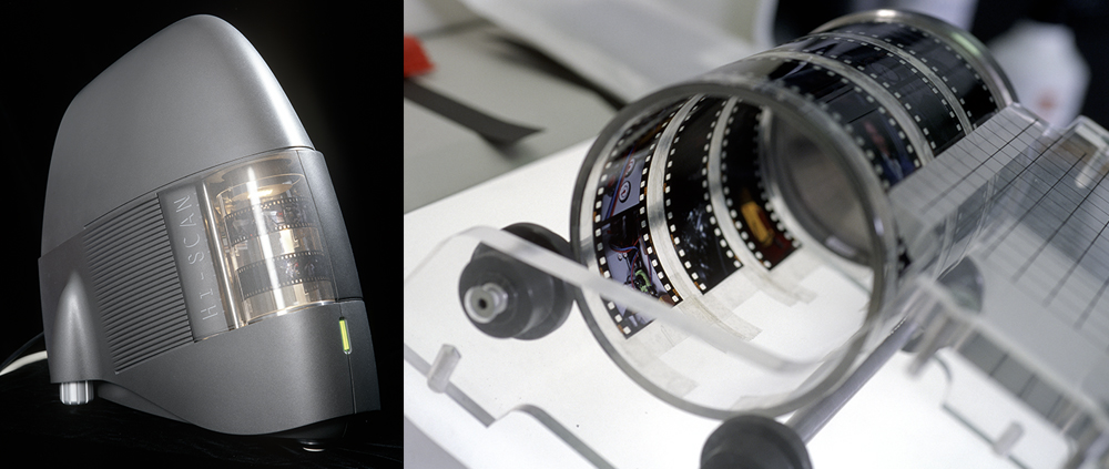

...is it possible to use a Nikon Coolscan 9000ED instead - sticking together separate scans to cover your 6x17 cm film original? These can be driven by a PC or an early Mac. Desktop drum scanners were made in the past - I used one myself for several years. The drum was big enough for two 5x4in films - but it's not like a 'fixed-carrier' - you just tape films to it. All sizes can be accommodated or even different formats simultaneously.
The software ran on a Mac and was straightforward to use once you had learnt to wet-mount your films onto the drum. The scanner itself had a small footprint (vertical drum), but you need a space for mounting and cleaning-up. There was lots of sticky sellotape and solvent type smells, but the results were fabulous. Great dynamic range from it's 3 PMT tubes and suppression of scratches from the mounting fluid. The films could fly-off the drum rotating at high speed sometimes with terrible consequences - the drum rotates at over 1000rpm, but these occasions were rare once you got the hang of it.
When purchased it cost about 10x a Nikon Coolscan 8000.
...is it possible to use a Nikon Coolscan 9000ED instead - sticking together separate scans to cover your 6x17 cm film original?.[snip]
Yes, you can make two separate "6x9" scans to cover the full image, then stitch the two together using Photoshop.
....i know the OP has gone very quiet, but i've even found a photo of 'it' in action. Fantastic 'Alien' appearance. A 'visitor' once saw it working and said:
"i don't care what it is - i want one!"

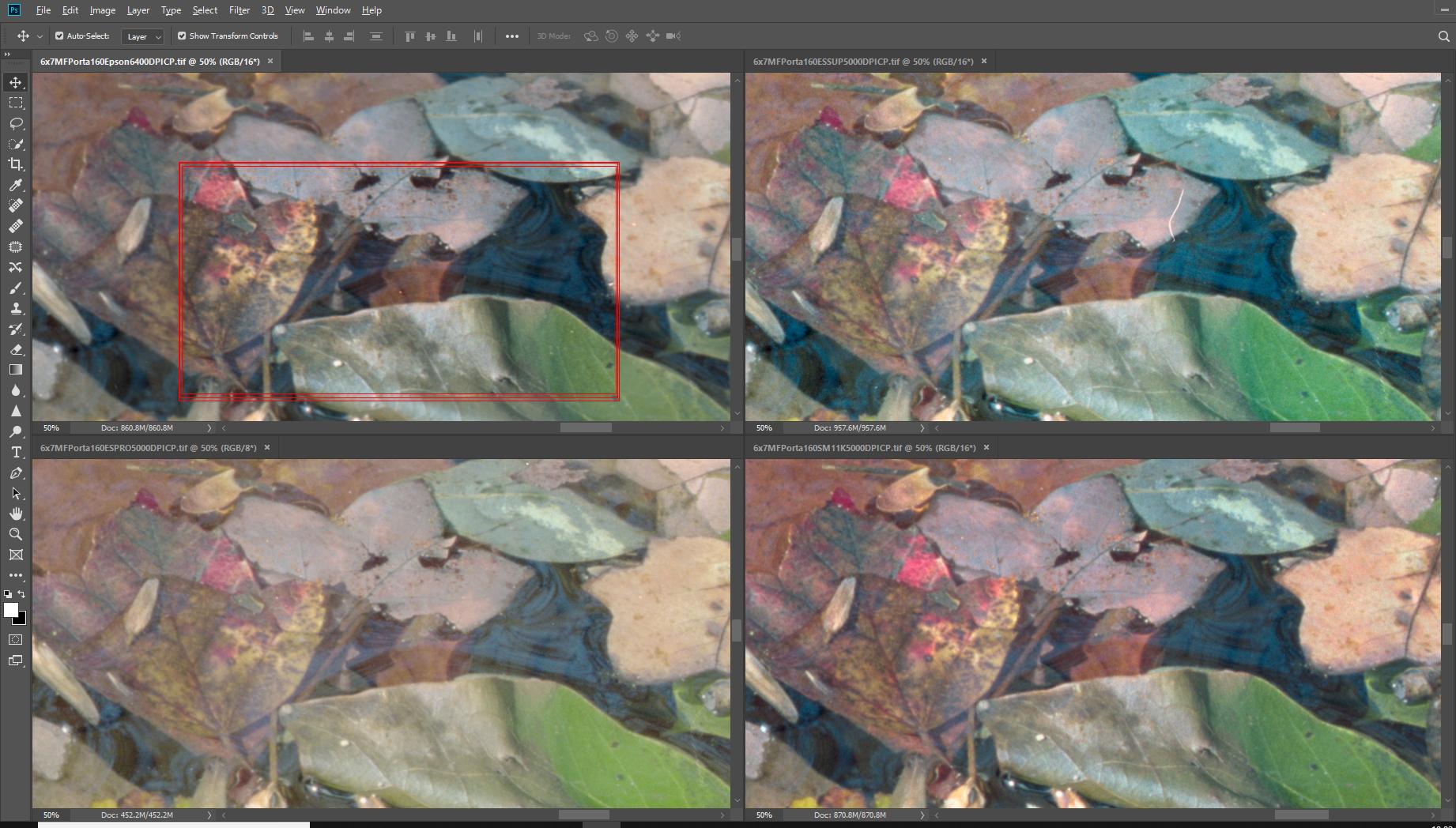

You can find the comparison here in another forum between the Epson V850 and Howtek 8000 with 4x5 BW film. https://www.largeformatphotography....wtek-8000-Drum-vs-Epson-V850-flatbed-scanners
I also did a lot of scanning of 35mm and medium format with a V600. You can find those on my FLickr pages linked below. The folders are labelled with film format type.
https://www.flickr.com/photos/alanklein2000/albums
Oh look, it's the sealion, back to destroy another thread about high end scanning like a repetitively offensive suicide bomber, this time with bad faith insinuations and clueless nonsense about Imatest and MTF.
And this is what Pali K had to say about 138S' attitude towards scanning.
Yes... Pali is an absolute defender of the drum scanners, and he made that test to show the drum superiority, but when a serious test was made (and Pali is seriuos and totally honest when making a side by side) results were absolutely matching, there is no doubt...
Fortunately that side by side was made by somebody wanting to demonstrate the drum advantage, so this result is of great value because for sure it is not forged. Yes, I use the real results obtained by somebody saying that a drum is better, this is the great value of the evidence: the real results he obtained are these (MF Portra 160, 6400dpi 100% crop):
Absolutely no advantage of the Scanmate 11000 drum (Bottom-Right) over the Epson (Top-Left) for Portra 160 and MF.
This is a reliable evidence because this test was made by somebody wanting to demonstrate that de the drum was superior, but reality is reality. You have no way to discredit that result.
This is the result obtained by Pali:
https://www.largeformatphotography....rum-Scanners&p=1479176&viewfull=1#post1479176
And this is after I conditioned his 100% crop properly:
https://www.largeformatphotography....rum-Scanners&p=1479178&viewfull=1#post1479178
What is wrong in that side by side ?
Right now there is total evidence that a V850 scan made proficiently is a totally Pro result, rivaling with high end machines. If you are not able to get those results from an Epson then buy/own drum or a "virtual drum". No problem, we are free to buy what we can. Of course purchasing a drum is no mistake (if no painful breakdown is to happen).
Also I think that Alan is not suspicious to show a forged result, this is his own experience, having Pro drum scanned a negative and later compared to the Epson, with a surprising matching quality. Isn't it ?
