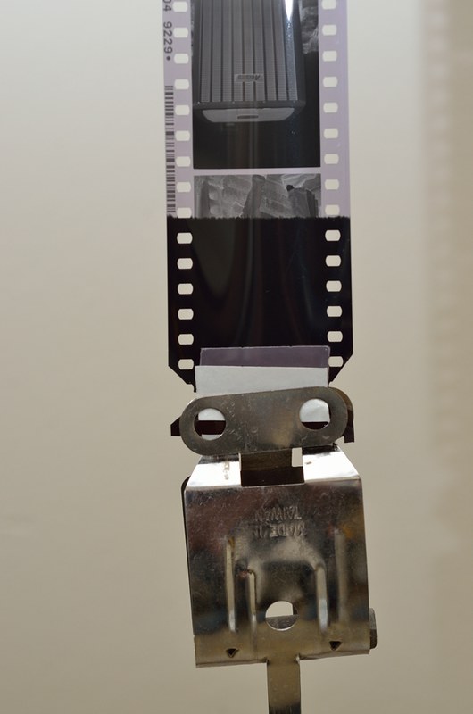

I just developed the roll in ID-11 for 8 min at 75 degrees...look pretty good. However, I'm not sure what happened at the end. I had taken #23 and knew I had one left so advanced the lever-no resistance, took the picture and advanced again but it would only go about 1/8th the distance so, I knew that was it. I rewound and developed. That #24 shot was cut off by more than half. I'll try and take a pic of it before I cut the negatives after drying.
Was that 8 min at 75 deg in 1+1 ID11?

OK-I couldn't wait. This is what happened on shot #24. There should have been a complete negative.
_1DF4495 by David Fincher, on Flickr
This can happen when you use up too much of the leader when loading your camera. Commercial films allow for 3 frames wastage. Use more and the total number of exposures is effected. Something you need to test.
I'm not doing anything different than I always have. I get the top and bottom sprocket holes on the take up, close the back and go through two blank exposures before advancing to the 1st good one. I've never had this to happen with other 24 exposure rolls and I've shot my share of those. One odd thing was once I closed the back(M4) and rewound to take the slack up, it tried to rewind or loosen again. It did that on several tries.

I didn't roll this. It was bought direct in a cassette from Film Photography Project directly from Kodak.
Film Photography Project probably used a bulk loader to manually load your cassette.
I would be very surprised if their operation is big enough to have the sort of film packaging equipment that the manufacturers use.
I think they gave you too little film, but not by much.

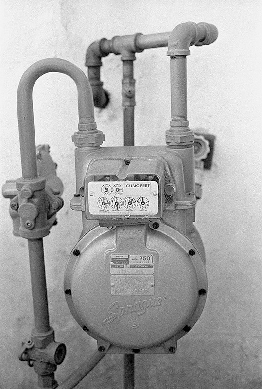

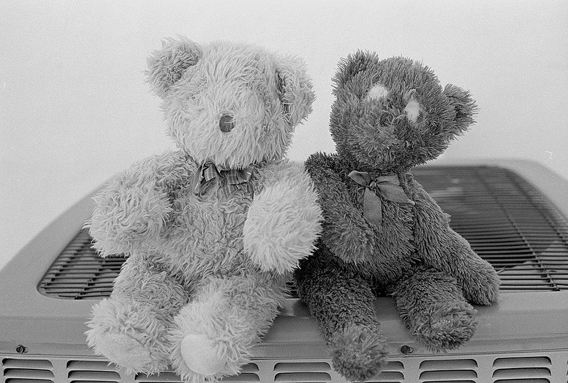

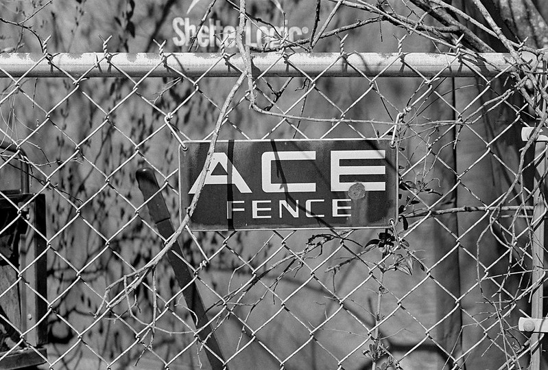

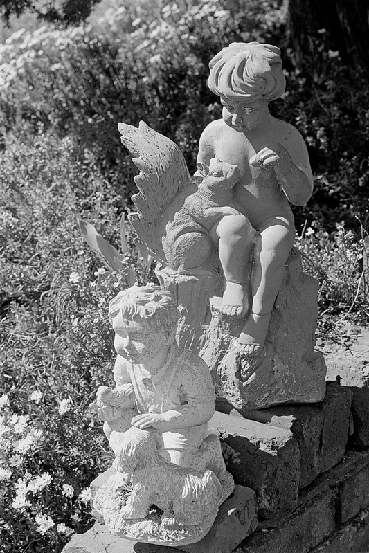

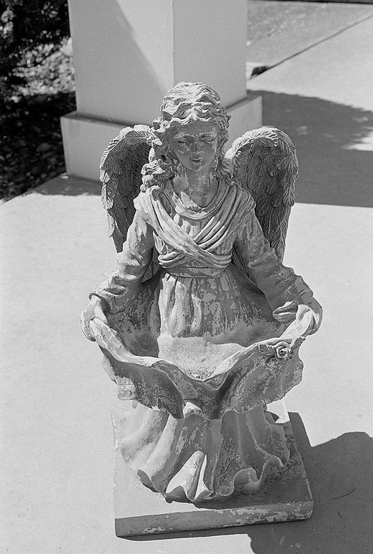

Without further ado, some examples. I shot in bright sunlight, cross light, shade to get an idea how it would handle the shadows and highlights. I'm not disappointed.
Double X(5222 film) by David Fincher, on Flickr
Double X film developed in ID-11 1:1 for 8 minutes. Shot at ASA 250 with Leica M4 and 50 f2 DR Summicron lens. by David Fincher, on Flickr
60@f4Double X film developed in ID-11 1:1 for 8 minutes at 75 degrees. Shot with M4 and 50 f2 DR Summicron lens by David Fincher, on Flickr
Double X10 by David Fincher, on Flickr

I made one mistake on the roll by underexposing a "selfie" from the tripod by two stops. I scanned it anyway knowing what I did when I saw the negative but it didn't come out too bad.
Double X11 by David Fincher, on Flickr
Another one. This one sot with the 90 f2.8 Elmarit lens at about 10 feet at 500@f8.
Double X08 by David Fincher, on Flickr
This one with the Zeiss 35 f2.8 Biogon at 250@f11
Double X02 by David Fincher, on Flickr

One more shot, nice one! I also liked the chain link fence especially how it came out. The rest, it seems this is pretty high contrast film rather than low contrast as some have suggested. I exposed with the camera metering, used about 250-320 ASA and will let it all come out in the wash...
ColColt
ColColt
May 26, 2015
1,824
TN
If you think this is high contrast you should see the same shots with Tri-X and HC-110 Dil H. Looking back over the negatives, I think they could stand a slight reduction in developing time...maybe half a minute or so. that could reduce the perceived contrast as well.
I like it. Think I'll order more and try some experimenting. It did very well with the shots taken in the shade but in the cross lit sun condition, maybe a touch contrasty. The lowered developing time would take care of that.

Negs might be a bit hot; my chart says 7 minutes would be a good starting point @75.
ColColt
ColColt
May 26, 2015
1,824
TN
I agree. I think the next roll will be 7 minutes. 75 degrees is much easier to use here year around and that's what I've chosen over 68.
The shot of the two bears and the gas meter seem to be right on for 8 minutes with that flat lighting but too much for contrasty situations. It's difficult to use a "one time for all" on a roll of film with different lighting conditions. Still, not too bad for an unknown film for a first time development.

Anytime you photograph under different lighting conditions, it's always a compromise when it comes to development. All things considered, I think they turned out quite well!
