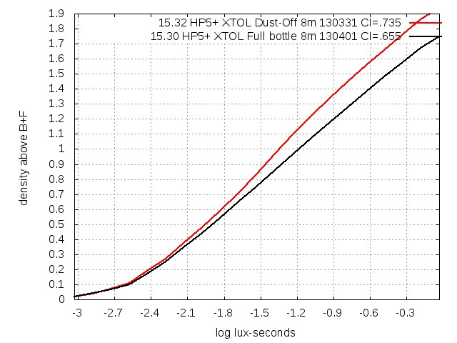

You might be tempted to use Dust-Off (or a clone of it) to drive the oxygen out of a partially used bottle of XTOL. Well, I found the gas dissolves into XTOL and makes the XTOL more active. Here are the curves:
The bottle was 3/4 full, so only 1/4 was Dust-Off gas. XTOL's pH is unchanged, so Dust-Off is doing something else to the chemistry. And it's probably not what you want. The clone I use says it contains difluoroethane. Rudeofus warned me months ago that this is not inert. I should have heeded his warning.

Difluoroethane should be as inert as those banned predecessors used as preservative gas for photochemistries.
And... what did you use? Dust-Off or a that clone?? I'm puzzled.
The Content of Dust-Off is stated as a mixture containing 60-100% Difluoroethane.

CO2 is not inert either, at least not for this purpose. It will decrease the PH.
There is a product called "bloxygen" which is nitrogen and argon gas, it's sold by some paint suppliers and woodworking suppliers for preserving paints and other finishes. It's expensive, but seems to work.
Another possibility is to search CL for someone selling a nitrogen cylinder.
