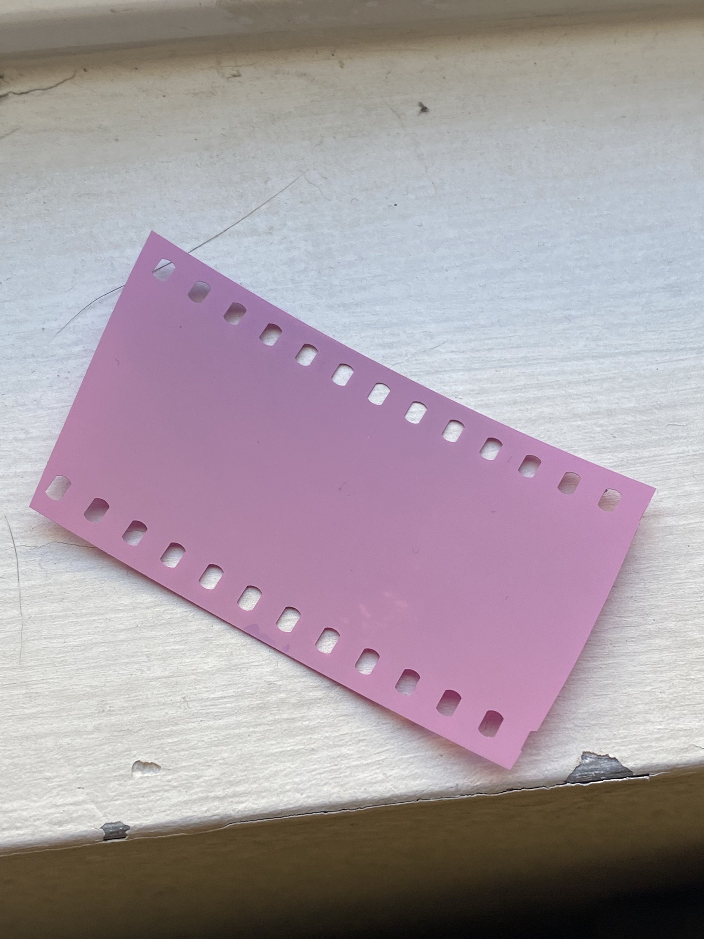

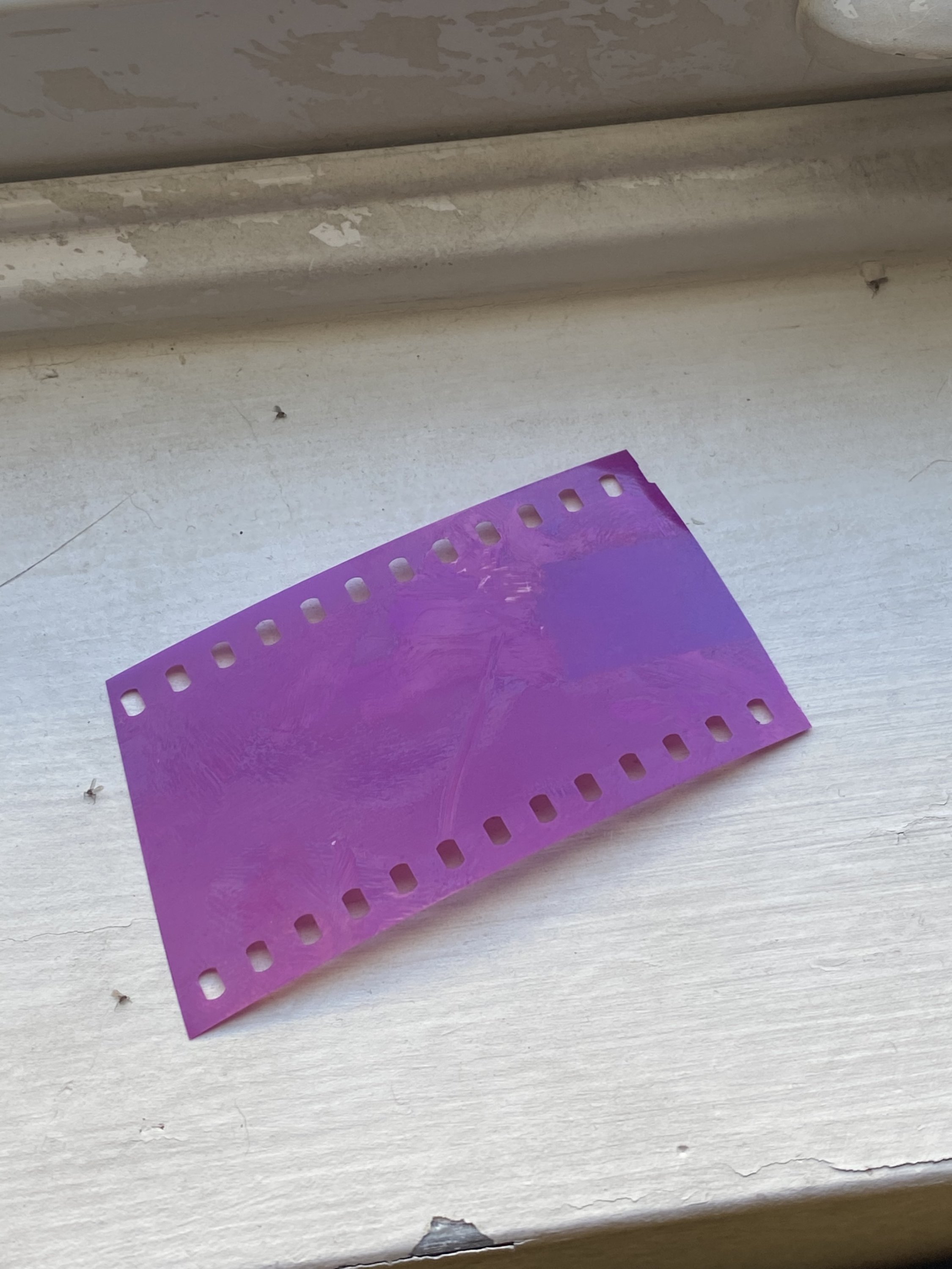

I just took an inventory of all the film I’ve collected and found a big roll in a bag that has no identification markings. Put it in a changing bag and took a snip to check it out and it’s very pink/purple. Looks like I bought a roll of Plus-X on eBay back in 2010 so thinking maybe this is it but it’s on a larger than usual (for 100’ bulk film) center spool and the base seems rather thin.

If you can, take a snip out in the dark, then develop it, and read the edge printing.
Otherwise though, yes it looks like it could be Plus-X.
I'll let the cine film users comment on the sprockets.
Yesss! Plus x
Plus-x was greenish, and then pink.
Or vice versa. But this strikes me as Plus-x.
I’ll process a strip with another roll and see what comes up. If it is Plus-X (fingers crossed), the next trick will be getting it into a bulk loader. This roll is larger than a normal 100' roll since the core is larger. Any tips here?
if it is plus -x, it might be 5231 movie Plus-x which is now sadly discontinued. Movie film has teh B&H perfs, and also might likly be found on a 2 inch diamerter core with a 1 inch hole.

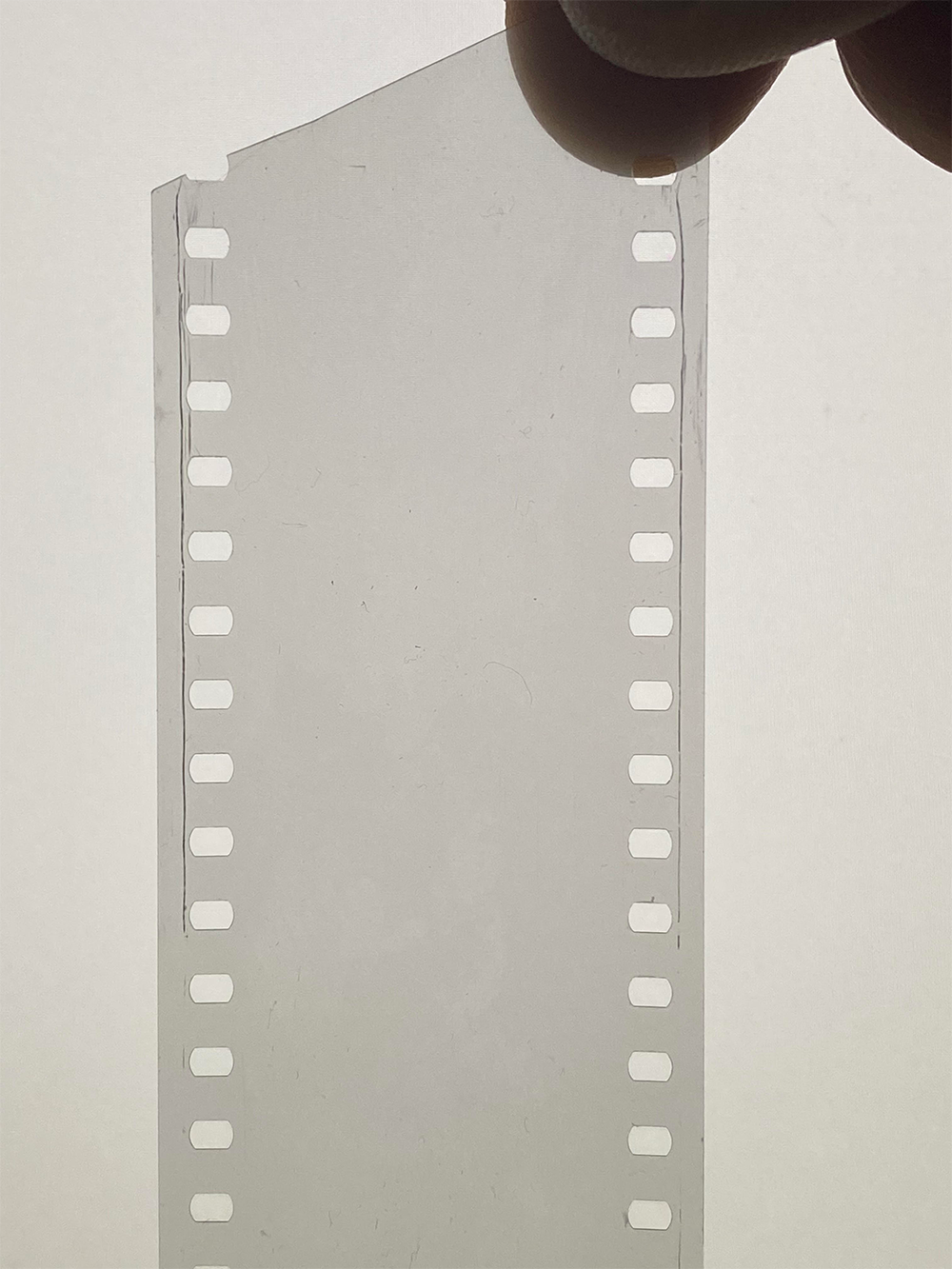

Sadly, no edge markings but here's the processed strip. There does seem to be a stripe down a portion of the side, and the base looks very clear, almost like an ortho film. I have Kodak orhto film though and the emulsion color is vastly different.
I currently have some Kodalith 6556 in 35mm and the emulsion is a dark almost wine-like red. I used a TON of Kodalith in college though, so it wouldn't surprise me but I also don't recall it being so purple.
