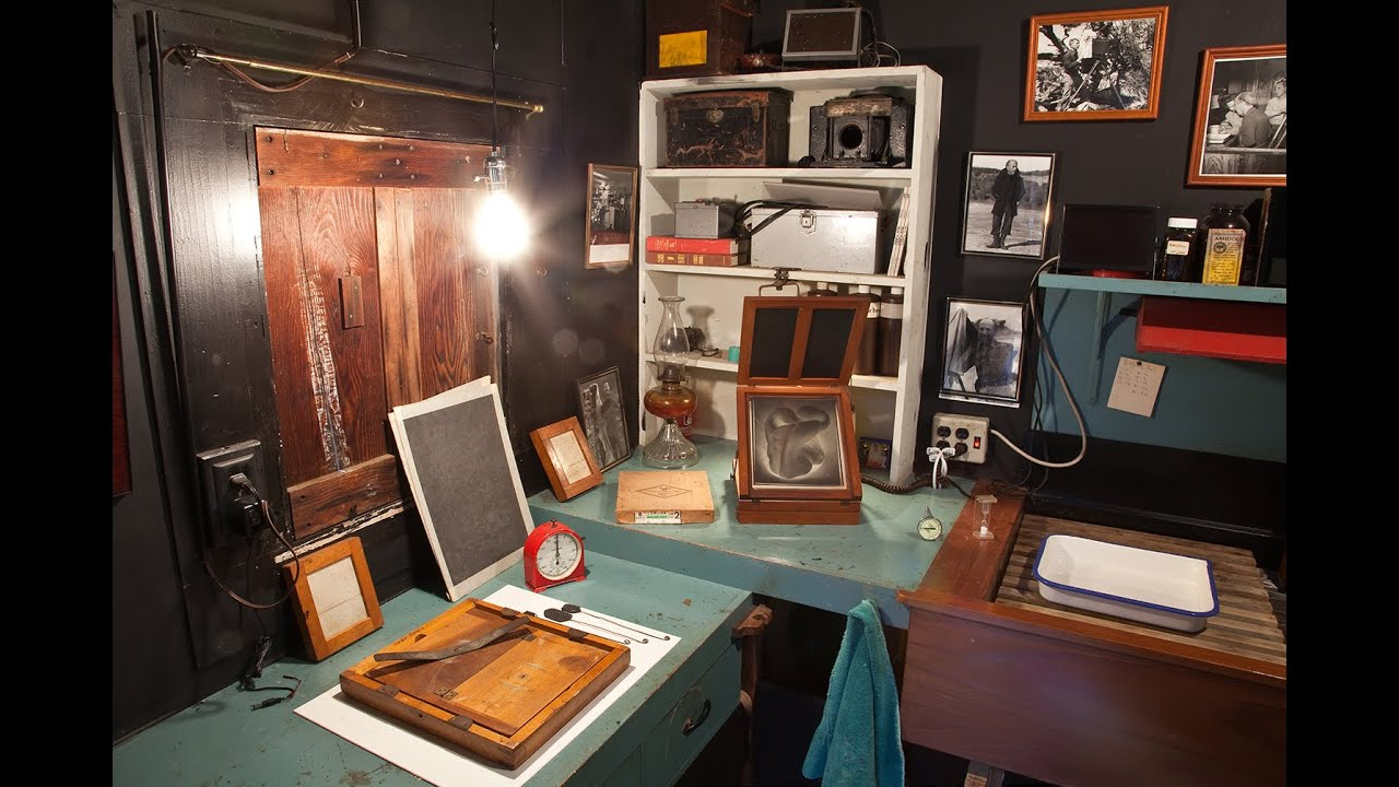

Check out Edward Weston's darkroom . (photo from Kim Weston's website)

From his daybooks, Weston had lots of problems caused by poor equipment. Bellows leaks, warped holders. bad film. He lost a lot of exposures due to fogging and even (because his exposures were hours long) because a truck drove down the street during the exposure. Weston made contact prints and the equipment you see in his darkroom was all he really needed and there really wasn't much "better equipment" to be had. He also lived hand to mouth most of his life.

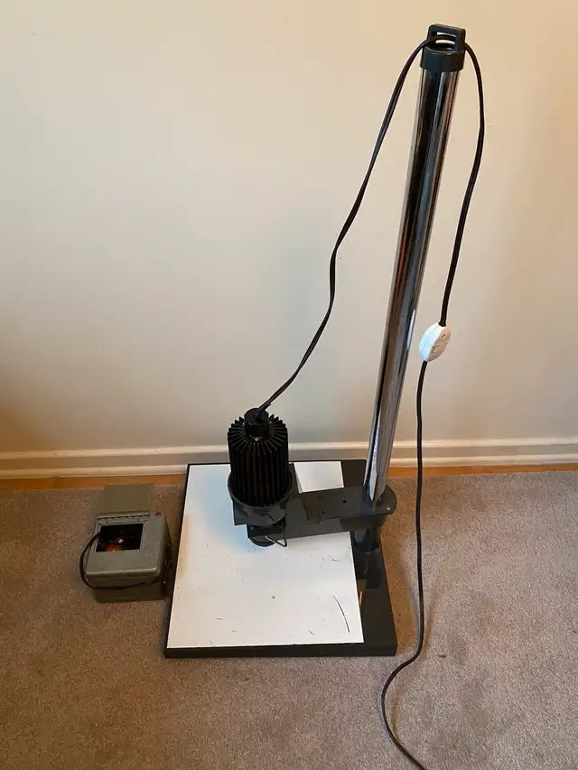

Been getting back into printing the last couple years and i picked up some budget equipment. i think my easel which is one of those all-in-one (Premier 4-in-1) etc doesn't keep the paper flat. so currently i kind of roll the paper on either side to uncurl it before i place it in the easel. i think the saunders 4 blade easels are supposed to keep paper very flat but they are expensive and i got this easel for $20
