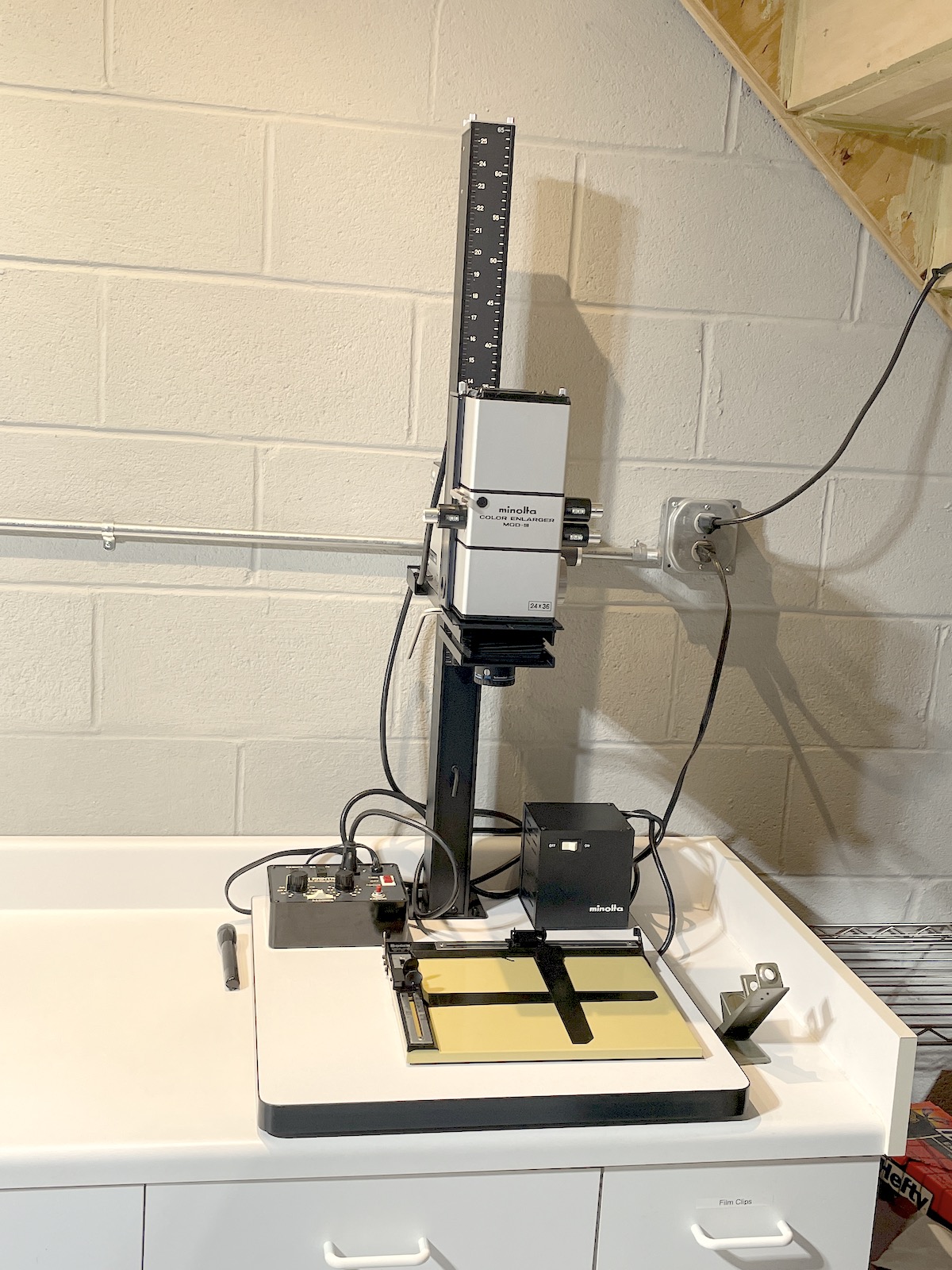

I still remember when I got my first Omega D5500 enlarger. It was to upgrade from a Minolta Mod III I got in 1975.
Since I had no 4x5 negatives, and only had the new Omega set up for the same negative sizes as the Minolta, It actually took a month or so before I started preferentially using the Omega. The prints from both were identical and the Minolta was easier to use, having known its quirks since 1975.

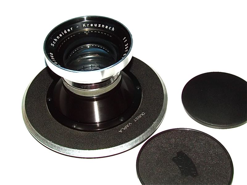

Maybe another way to answer the question, is that once one gets beyond medium format, nearly all the equipment available in the day was "pro" quality.
For example if you consider Schneider's 360mm enlarging lens for 8x10, the did not even offer 3 and 4 element 'student' lenses as they did in the 50mm range .
