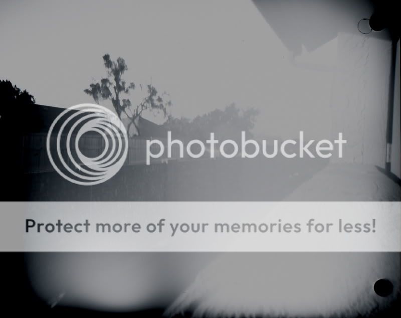

PS: Regarding your posted image, is the fogging coming from the camera, the makeshift darkroom, or both?
Yeah, it looks like some fog; take care that with these long exposures, you need to fuss over all light leaks. You could do a normal exposure with your "lens" covered to see if you have leaks and where they are.
Of course you want to test your camera for leaks, but I'd recommend starting with your darkroom setup. You want to know right up front if your box of paper has been fogged in the darkroom when it's been opened; not knowing this will throw off all subsequent tests.
If you have a changing bag, try removing one sheet of paper from the box in the bag, then remove that paper in the dark room. Then do the fog test for darkroom leaks. There's two ways to do this; the easy way is to simply keep one part of the paper covered by an opaque object (a coin, etc.) and leave the paper exposed in the darkroom under "safe" lights for at least 5 minutes. Then process the paper normally. The other way is to faintly flash the paper with white light (like from an enlarger for a few seconds at the smallest aperture setting), then do the same test with a coin over the paper; this second method is more sensitive for subtle leaks or fogging from safelights.
With either test, if you notice a density difference on the paper between the covered and uncovered parts of the paper, then you have a fogging issue.
There's also the possibility that the paper in the box is already fogged. The only easy way I know to test for this is to put the box of paper, scissors and a daytank in the changing bag; remove one sheet, cut off a strip and place it into the daytank; seal the box of paper and daytank before removing your arms. Then process the paper in the daytank. You can then compare the density of the paper strip and try comparing its tone against the backside of the paper strip, which should be pretty close to the same shade of white.
Once you know that your darkroom and safelights are good, then you can proceed with testing your camera for leaks. I've found with pinhole cameras you can often see the leak by illuminating one side with a bright articulating desk lamp in an otherwise dark room, and put your face up close to the insides of the camera, checking the corners and edges and seams for light. Of course, you can't check the camera's door or lid this way, unless the camera is big enough to fit inside(!), so you'll have to do a leak test by loading a sheet of paper into the camera (in your now safely-proven darkroom) and leave the camera, shutter closed, out in the bright daylight direct sun for an hour, changing the orientation occasionally. You should see fogging on the paper after processing.

I think it was my camera. I looked in the loading slot and ran a high-powered flashlight around. Not only did the flashlight penetrate the foamcore even through both sides painted black, there were several seams with more pronounced leaks. I covered the entire thing in aluminum foil, and now the flashlight doesn't shine through even a little bit. Although my camera now looks like Sputnik.

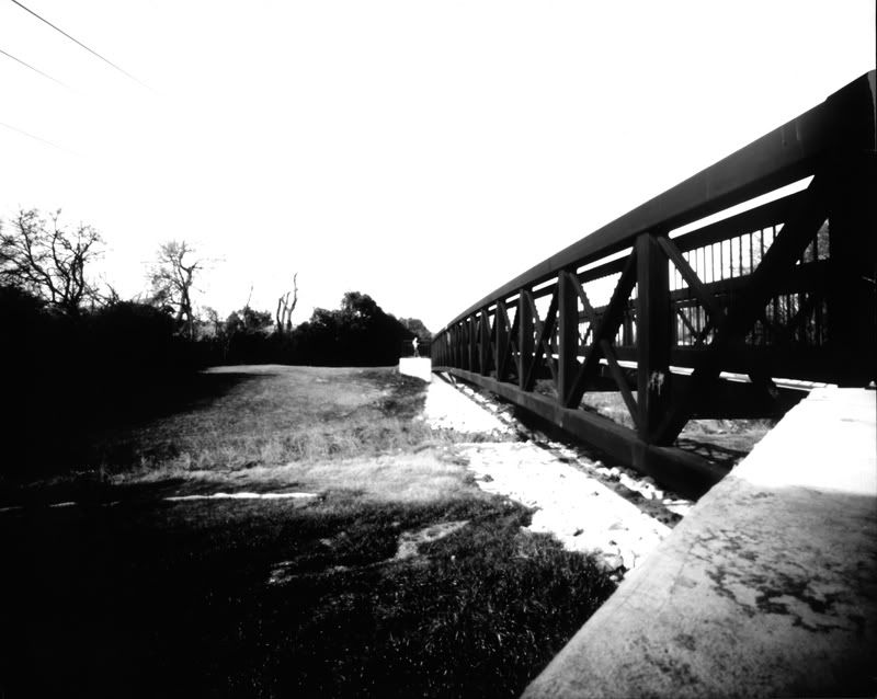

Yay I think the aluminum foil was the ticket, and I had a fogging problem all along. I'm starting to notice bizarre contrast issues with the paper though. The bridge, being red, is underexposed, while the blue sky and rocks are completely blown out. I'm sure this scene would have turned out more normal with film, but then, maybe it wouldn't be as cool either.
Yep welcome to The Contrast Issue. Now you can go back through some of the discussions and see if any of that works for you. I'd say, try preflashing first and foremost, and expect it to increase the sensitivity of your paper by a stop or so.
The other thing, which is blazingly obvious but seldom stated, is that you can meter the contrast of your scene and know straight away whether a paper neg is going to work under "normal" exposure. In a low contrast scene you can get wonderful results. In a an 8 stop scene, well... and of course you can filter blue if that might tighten up the contrast in your scene.
With paper negatives you have to expect the sky to be blown out to white. This is what I call the "19th century" look. Knowing this will happen, it's best to purposefully compose your scene with this in mind.
Those of us who've been practicing with paper negatives for some time tend to employ a variety of methods for reducing contrast. Among them are:
1) Use RC paper of a fixed contrast grade, rather than VC paper. I've been using Freestyle Photo's Arista grade 2 RC paper, rated at ISO12.
2) Use a dilute developer and develop by inspection, pulling the negative when the shadows begin to show adequate detail but before the highlights get excessively dense.
3) Pre-flash the negative prior to loading the film holders, with a faint gray exposure. This will have a tendency to increase shadow detail without significantly increasing highlight density.
4) Use a yellow filter over VC paper. I haven't personally done this, and it does decrease the paper's speed significantly.
One exception to the typical white skies with paper negatives is if you're using a very wide angle pinhole camera. The light falloff toward the edges and corners can serve to give you back some sky detail you'd otherwise be missing; especially if you compose purposefully with this in mind.
