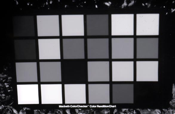

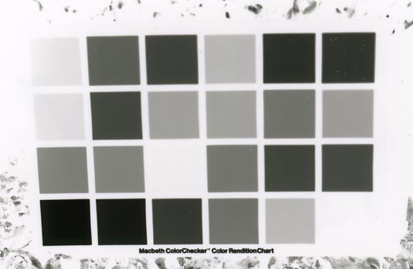

I would bow to the superior knowledge of Photo Engineer almost every day of the week...except today. I have been shooting paper negatives for about 4 months now, and have had my students shooting 4x5 paper negs as well. We are using Ilford MGIV fiber paper and have done exhaustive testing. Everything we're finding is that it needs to be rated at ISO 3. We're developing in Sprint paper developer diluted 1:18. We have not done any pre-flashing. That'll be the next step. These are being produced for contact printing if that matters.
Photo Engineer
Apr 19, 2005
29,018
Rochester, NY
Michael;
I shot mine in a speed graphic outdoors and metered with a Seconic spot meter. The exposure times were in the range of 1/25th and 1/50th of a second. Could it be that we are seeing a speed / reciprocity failure problem. I'll warrant that you are using very very long exposures, a situation for which the paper is not designed, any more than it is for my rather short exposures.
IDK, but the speed I have been using is ISO 25 and my reference in the same camera is /was Polaroid at ISO 100 along with Portra VC at 100. The pictures included a MacBeth color checker as reference.
Oh, I also cut small sheets and placed them in an old empty Polaroid pack and exposed them in my RZ67 with the autoprism set at ISO 25. Same results. The one sitting next to me right now was exposed at f8 1/50". Scans of the negative and print are attached.
PE

Out of curiosity, I just shot a few sheets of 8x10 in the studio, shot at 1/200th of a second with strobes. I compensated for bellows factor, and both shots are within 1/2 stop of each other. They're in the wash...I'll shoot some digi-snaps of them and post when they're dry.
Again...I would bow to your wisdom, and I wondered if I was seeing different things than you were. I have shot paper in the studio and outdoors, and regardless of the length of exposure it always seems to end up at about ISO 3.

The photo above was shot outdoors in full daylight.
The Speed Graphic shots were taken with a vintage lens from the 40s, and the RZ shots were taken with a UV filter over the lens. That is about all I can say. My references taken with the same camera on Portra and other films and the Polaroids came out just fine too at their proper ISO ratings.
If there is something wrong or skewed about my results, I'll be happy to have it pointed out to me. And, BTW, this is how I test my ISO 40 Ortho emulsion. Same cameras, meter and method. I have had 3 workshops with groups of students verify this ISO # with their own cameras - not mine, and also several private workshops that have gotten the same ISO 40 value for my home made emulsion here using my cameras.
My ISO 40 emulsion coated on paper is about ISO 100, another correct value as you gain about 1 stop when you coat a film emulsion on paper base due to back reflection. So, my film emulsion on paper is about 2 stops faster than the Ilford MGIV.
When used on-easel, my film emulsion is about 2 stops faster (or more) than Ilford which is a further point of reference.
I use Dektol 1:3 or Liquidol 1:9 for processing at 68 deg F for 1 minute.

You brought up an important point. You have overexposed to fight contrast. Well, if you overexpose and either under develop to get lower contrast or develop normally, you will be talking about at least 2 stops which is about ISO 6 or thereabouts. This will reduce the contrast nicely, but it will not center a tonal scale at normal development.
All of my photos include the MacBeth Checker and have the neutral scale centered with Dmin on one side and Dmax on the other, and they were given normal development, no under or over, and no flash.
I think that all of this is important. I am trying to get at the full tonal range. To actually do this with a paper, I suggest a grade 0 or grade 1 graded paper.
As for spectral sensitivity, the Ilford MGIV and most graded papers today have a short green sensitizer that is much shorter than I expected. It peaks at about 520 nm as opposed to 560 - 580 for a "normal" green sensitizer. This gives things much more than blue or dark green no detail or image at all and seems to further increase contrast demanding more overexposure to the eye.
Take a look at my images above and see what I mean about centering the density values on the scale.
