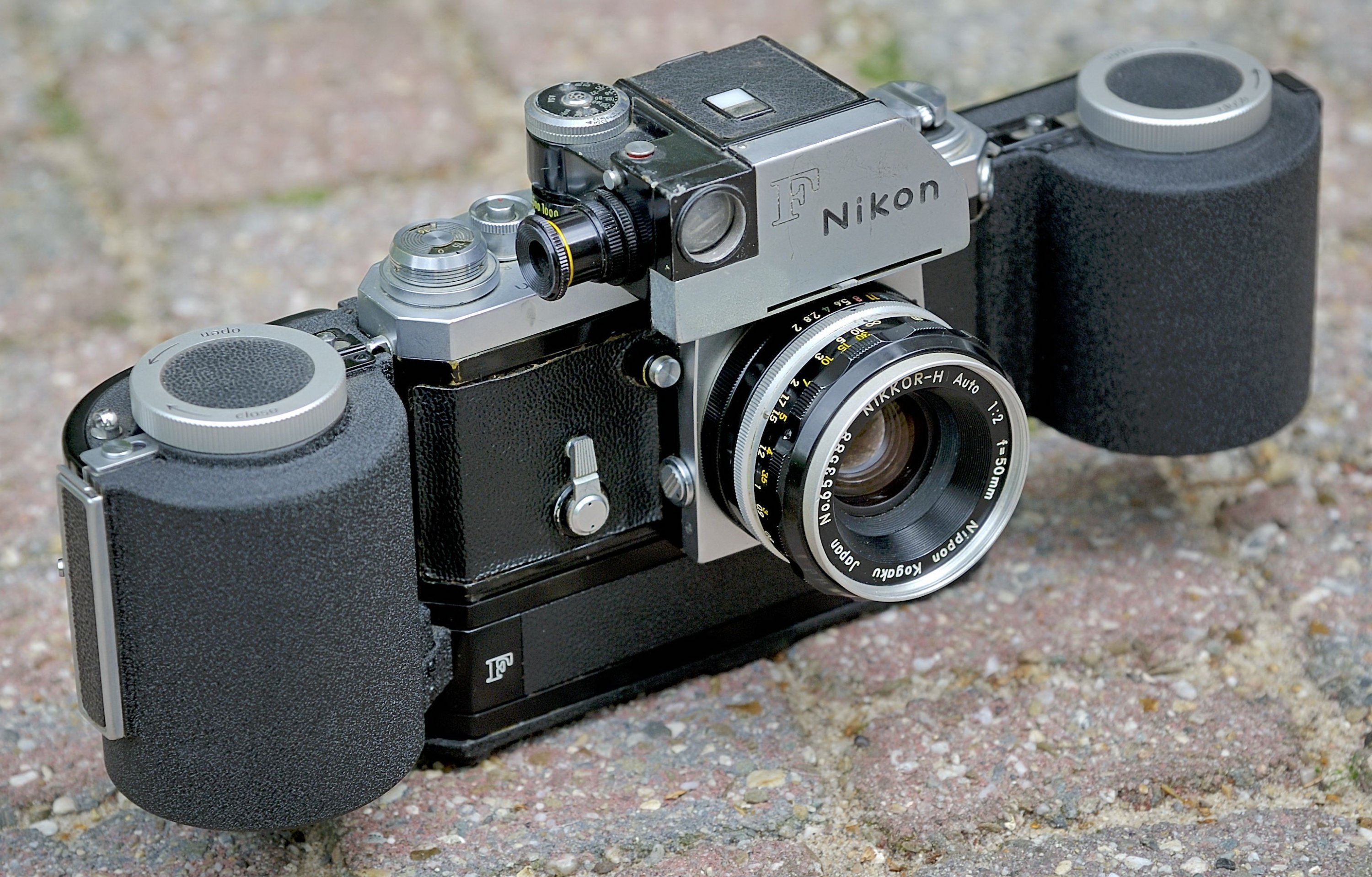

These bulk rolls were really designed for the Bulk film backs of the later Leica III series cameras and the Praktina's usually used with a motor-drive, and later Japanese manufacturers like Nikon, Pentax, Canon, offered similar backs (or adapted cameras).
I think the economics shifted when the major users of bulk film backs shifted to digital and sales declined. If you can get bulk film at a good price differential it's worthwhile, and as Bill says it looks you into learning that film choice :D
