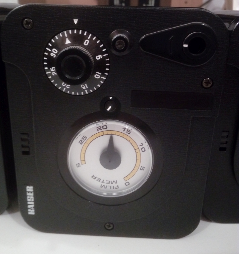

I've been using bulk film loaders for at least 50 years, I've tried various units but the best ones are/were made in Germany; which is where I picked up my first German one, a Kaiser unit.
https://www.google.com/search?q=kai...AUIDygC&biw=1536&bih=710#imgrc=cxV4zSjaBWsnaM:
There are various versions available, Hansa also from Germany. I have three Hansa units, two made in Germany the third made in Asia.
These units are excellent, they have a gate that opens so that the film does not get scratched and as you mention, you can load 3 frames or any variation up to around 37 frames.
As for whether they are worth it, I believe they are, even for colour film and also for any kind of film that you can get in bulk, often this can be motion picture film off cuts. If it is in the same format as 35mm film, then you can bulk load it.
As for film cassettes not lasting, well they do and they don't. I purchased a box of 40 of them around 25 years ago, I use them and use them and use them. Whenever I unload film onto a reel, I place the empty cassette in order of loading and don't move them until I have developed the film, which is loaded into the tank in the same order. If I note a problem, which can be as simple as a thread coming loose from the cassette light trap, then I either trim the loose thread, or discard the cassette.
I have about 10 new cassettes awaiting use. I do admit that these days I mainly use 10cm x 13cm (4x5") film and rarely use 35mm film, but these cassettes have done probably around 100 rolls in most of them. I rotate through approximately 15 cassettes and on the last trip I undertook to New Zealand earlier this year I took 18 rolls in re-loadable cassettes. All of those cassettes had been heavily used over some years.

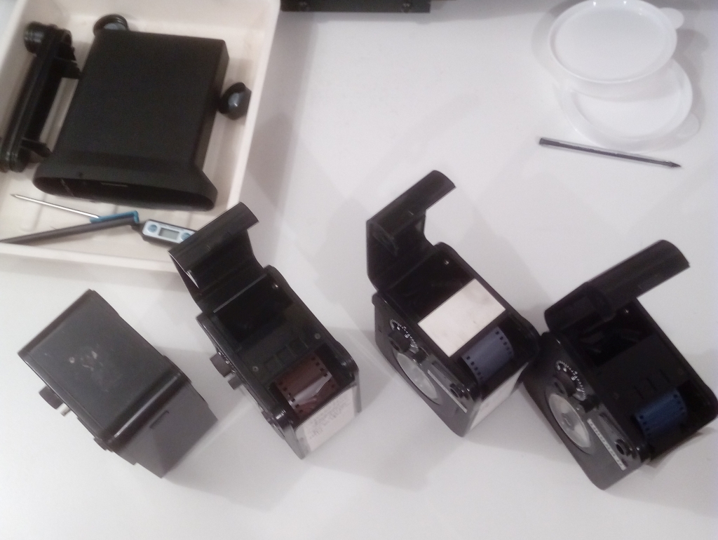

Some of my bulk loaders.
Mick.
