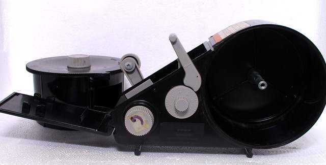

Decades ago, I used Lloyd bulk film loaders and I used Burke & James Watson bulk film loaders for 100-foot 35mm black & white film (primarily Kodak Tri-X) and 100-foot E-4 and E-6 color slide film (primarily Kodak Extachrome). I processed my own film.
Lloyd pros:
Smaller size than Watson
Does not wastes film by producing a long leader
Does not waste film by producing a long trailer
Harder to accidentally expose 100-feet of film
Lloyd cons:
No frame counter; must count winder rotations for frame count
Uses felt for light trap; felt may trap particles that scratch film
Cannot load Nikon AM-1 film cassettes for Nikon F2 camera
Watson pros:
Has frame counter
Does not use felt for light trap; therefore, film is less susceptible to scratching
Can load Nikon AM-1 film cassettes for Nikon F2 camera
Watson cons:
Larger size than Lloyd
Wastes film by producing a long leader
Wastes film by producing a long trailer
Easier to accidentally expose 100-feet of film (I have done this once)
Burke & James Watson model 100 bulk film loader by Narsuitus, on Flickr

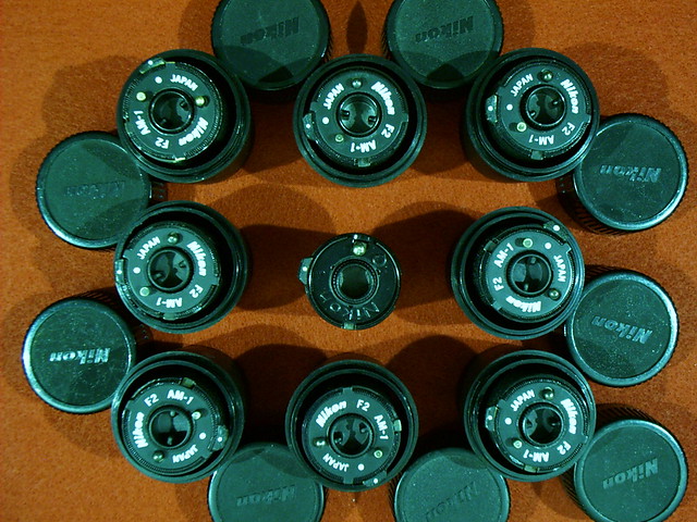

I used the reusable and durable Nikon film cassettes. These cassettes did not have the felt light traps that were found in the less expensive film cassettes. As a result, film could move faster and smoother as the motor drive pulled the film out of the cassette. Also, thin emulsion films were less likely to get scratched as they were pulled out of the cassette.
The cassette in the center of this image is a reloadable Nikon F film cassette that only works in the Nikon F camera.
The eight reloadable Nikon AM-1 film cassettes seen in this image only work in the Nikon F2 camera.
Nikon also made a reloadable film cassette that worked only in its rangefinder cameras.
I was able to load twenty-two 30-exposure rolls in my cassettes from a 100-foot roll.
Nikon Film Cassettes by Narsuitus, on Flickr
