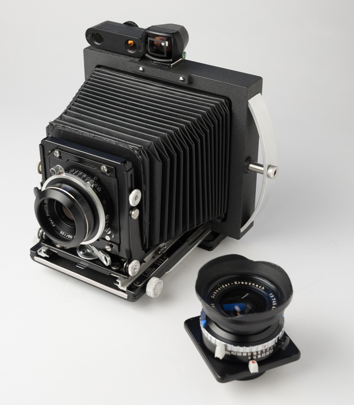

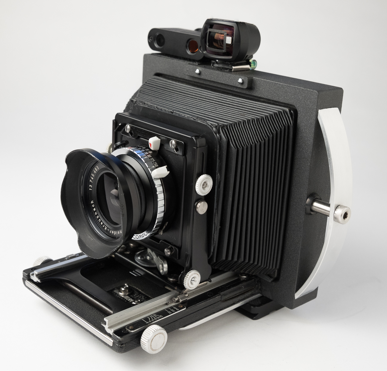

Here a 4x5 camera that I just finished. Its more or less a larger version of the 2x3 camera I built a while back. I wanted something lightweight and compact for occasional 'sheet film outings'. This camera uses the same 2x3 Graphic front end (third camera I've build using one of these) and the super lightweight composite rear standard made by Mike Walker for the Ilford TiTAN 4x5 pinhole.

Cute. But what's the point of the clip-on rangefinder? I see half of the donor Graphic's focusing scale, which isn't particularly useful. If complete it could be used with just one lens. I know, you can always focus on the GG.

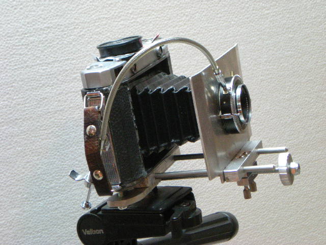

And for something much less attractive ( cheap and simple can be attractive ? )

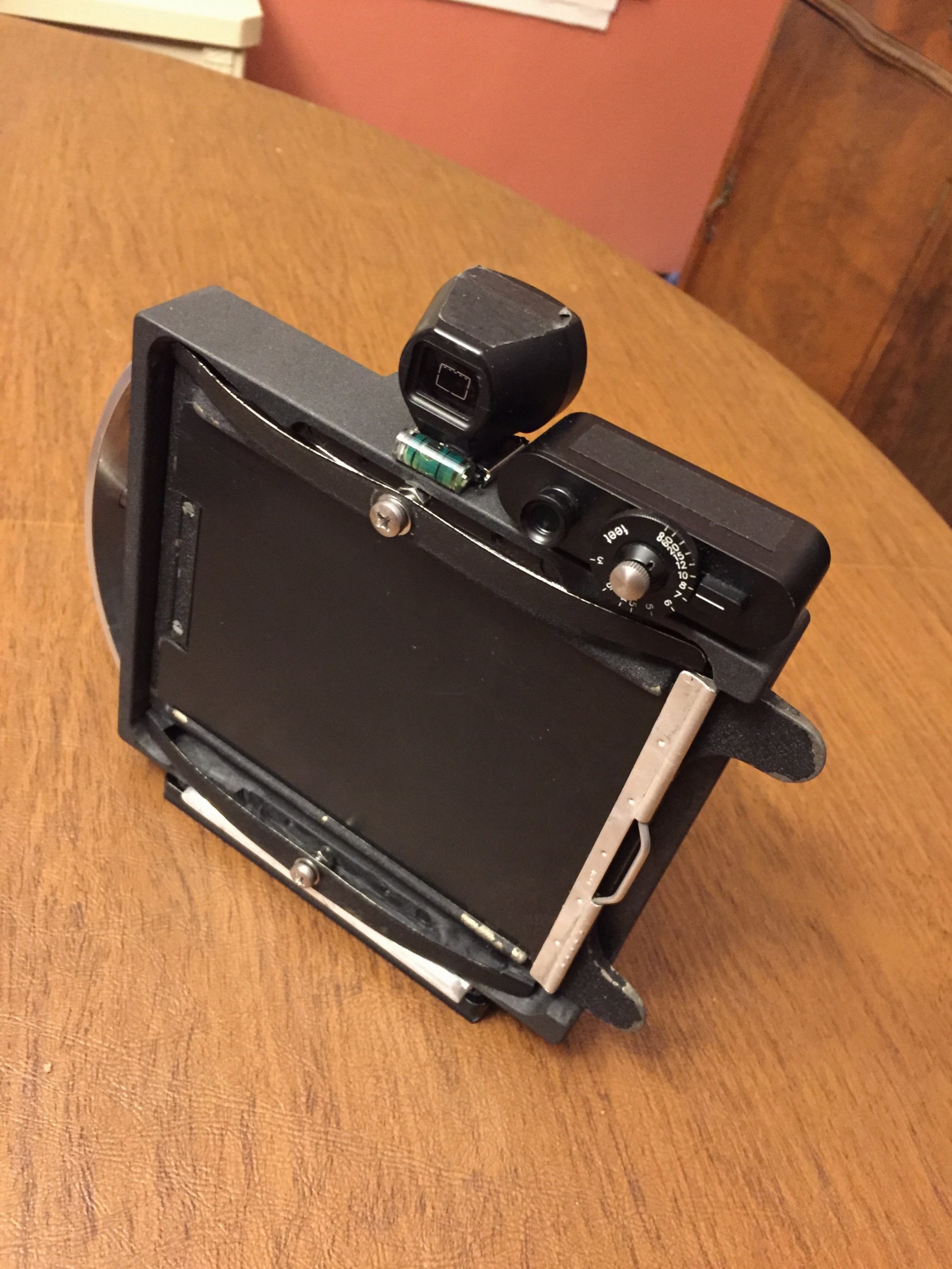

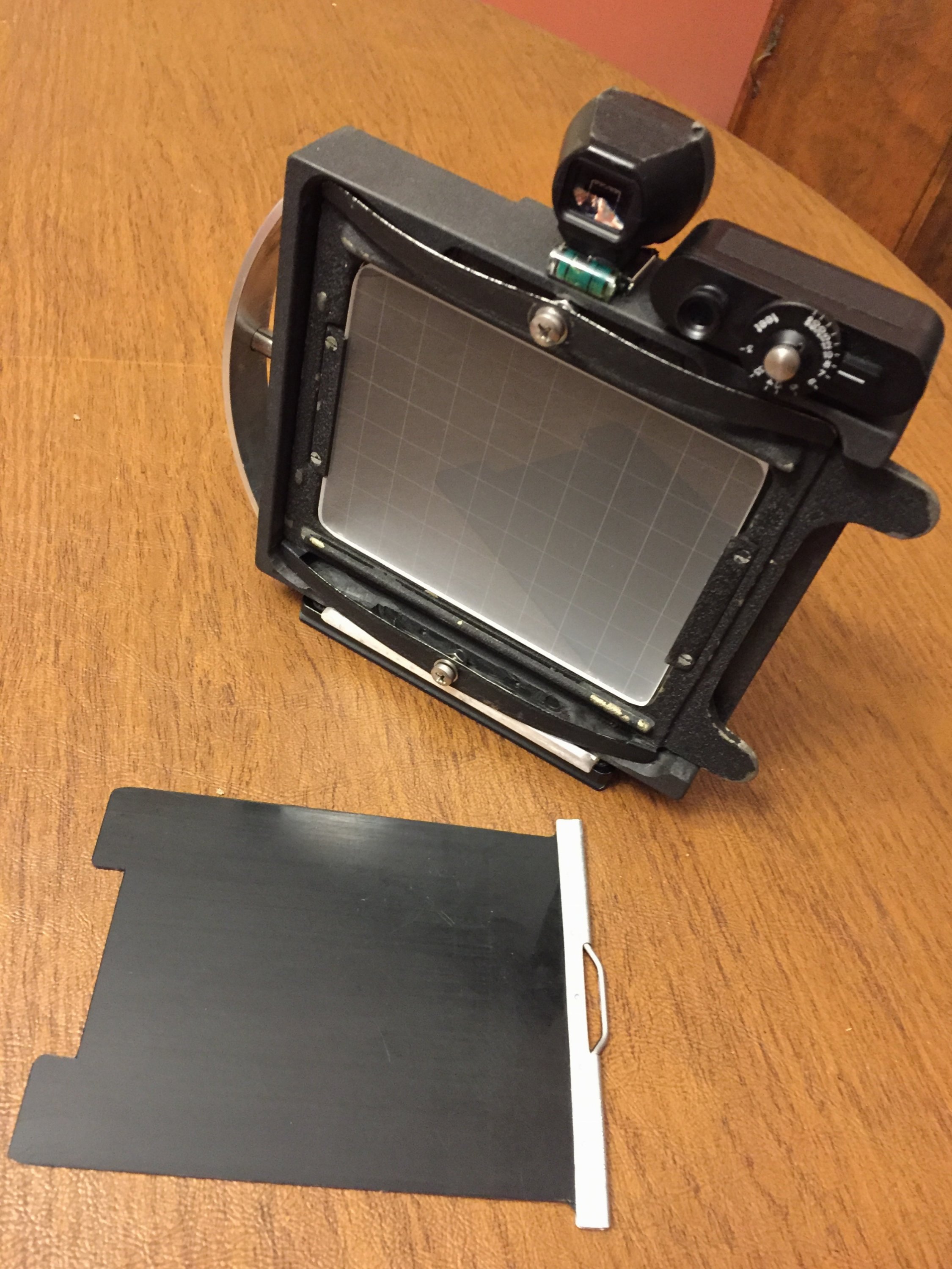

When I photographed the camera the ground glass back hadn't been made yet (Mike Walkers design used small plastic spring clips to hold a film holder in place) so I couldn't calibrate a focus scale. The back was completed this morning so I'll be adding a calibrated scale for the 125mm and a second scale for the 65mm.
Here is how the back turned out if you are interested.
