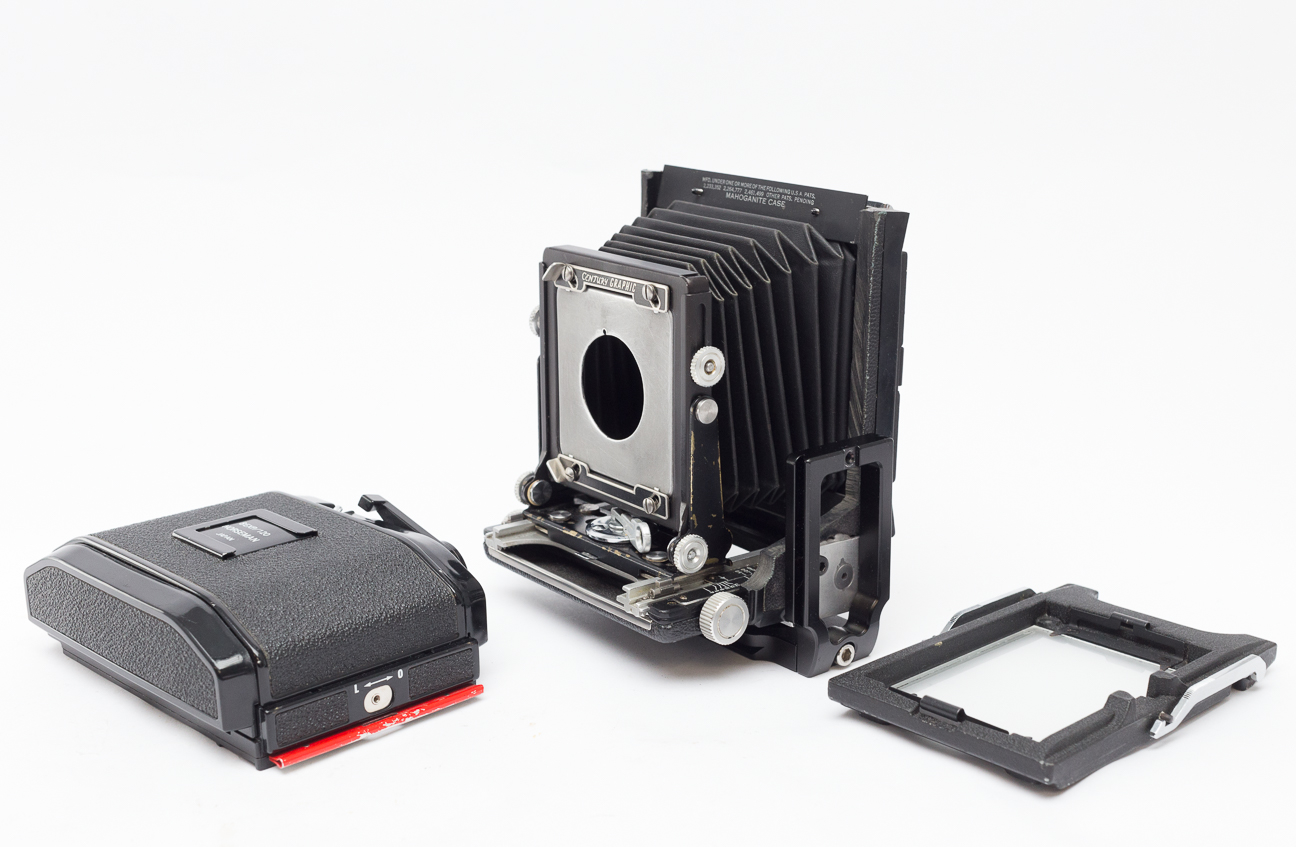

Here is a 2x3 camera I built using a rack system from a 2x3 Century Graphic that works quite well. I've never had an issue with focus but I do tend to shoot stopped down.

Not to be a complete idiot or anything, but what does your cute little cut down Century Graphic do that an unmolested Century can't do? I can see full rise with a short lens, what else am I missing? I mean, the shortest lens that covers 2x3 is the 35/4.5 Apo Grandagon and an unmolested Century can focus one to infinity.
Hey there,
Thanks for checking out my camera. We were using it set up with either the 35mm Rodenstock and a roll film back or the 28mm Schneider with a PhaseOne back and wanted something that was small and could be quickly pulled out, shot and and stuffed back in a camera bag as we were using it addition to digital and 4x5 cameras. Being able to focus 'inside the box' when shooting handheld is tricky and time consuming. Cutting it down made it crazy quick to shoot with and in all honesty, a heck of a lot cheaper then an Alpa which we just couldn't afford.
Thanks for the reply. I'm not sure which 28 Schneider you're using (28/2.8? 28/5.6?). I don't mean to be a nattering nabob of negativism, but a Century as delivered by Graflex Inc. will focus both of them, also a 35 Apo Grandy. I just checked, the Schneiders' flange focal distances are >= 50 mm, per Leaf, and 35.2 mm, per B&H, respectively and the Apo Grandy's is 41.1. A Century's minimum extension is 34.9 mm.
Focusing on a ground glass is focusing on a ground glass is focusing on a ground glass. One of Pacemaker Graphics' advantages over many of their press camera competitors is that the inner and outer bed rails are linked. This makes focusing with a lens that makes infinity "inside the box" simple. Set the lens to its infinity position using bed stops on the outer bed rails and a spacer to put the front standard as far behind the stops as it needs to be. Lock the standard, rack the rails back in. Drop the bed. And off you go.
If you don't have one, look for a Cambo SF-320 in-line viewer. I use one on my 2x3 Graphics, it replaces the focusing panel.
All that negativism aside, y'r adaptation is cute and clearly meets your needs. Can't ask for much more than that.
Re the Alpa, they're lovely. Absolutely lovely. But expensive, absolutely expensive. A Century Graphic will do more and is much more cost effective. For this and similar comments Andre Oldani has denounced me as an ignorant barbarian.
Cheers,
Dan
An ignorant barbarian is prolb a little much, a Ferrari and an old Ford will both get you the grocery store and back...but an Alpa or my conversion can fit in a small pouch and let me shoot a frame here and there while shooting a tornado ravaged town where a Century is just too big. Too big to fit in a bag with the bed folded out and too slow to open the bed and pull the lens out each time I want to shoot a single frame along one of the Canons I'm already shooting with.
The 28mm is the f/2.8, I got it along with a Cambo X2 Pro, thank god I didn't take a hack saw to that...I'd never hear the end of it.
