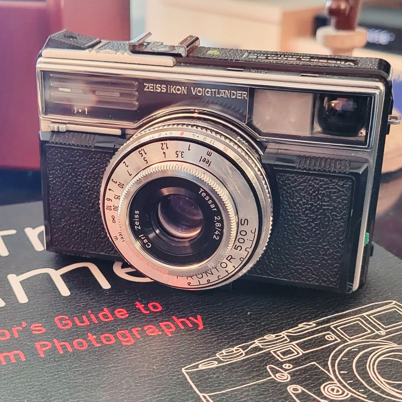

I just loaded this new addition with some expired Tri-x. 😁
I have done it several times for various reasons. I just mark the frame number when it comes out and then go 2 frames past that when i reload it.
Hmmm, that's a neat feature on that Zeiss/Voigtlander/Vitesse - hold the shutter down and crank away until you get to the right frame.
Features like that pop up and then disappear from the lingua franca of camera design.
I wonder if they didn't design the camera, found it behaved in that fashion, and then decided it "wasn't a bug but a feature" ((c) IBM 1957) and left it.
