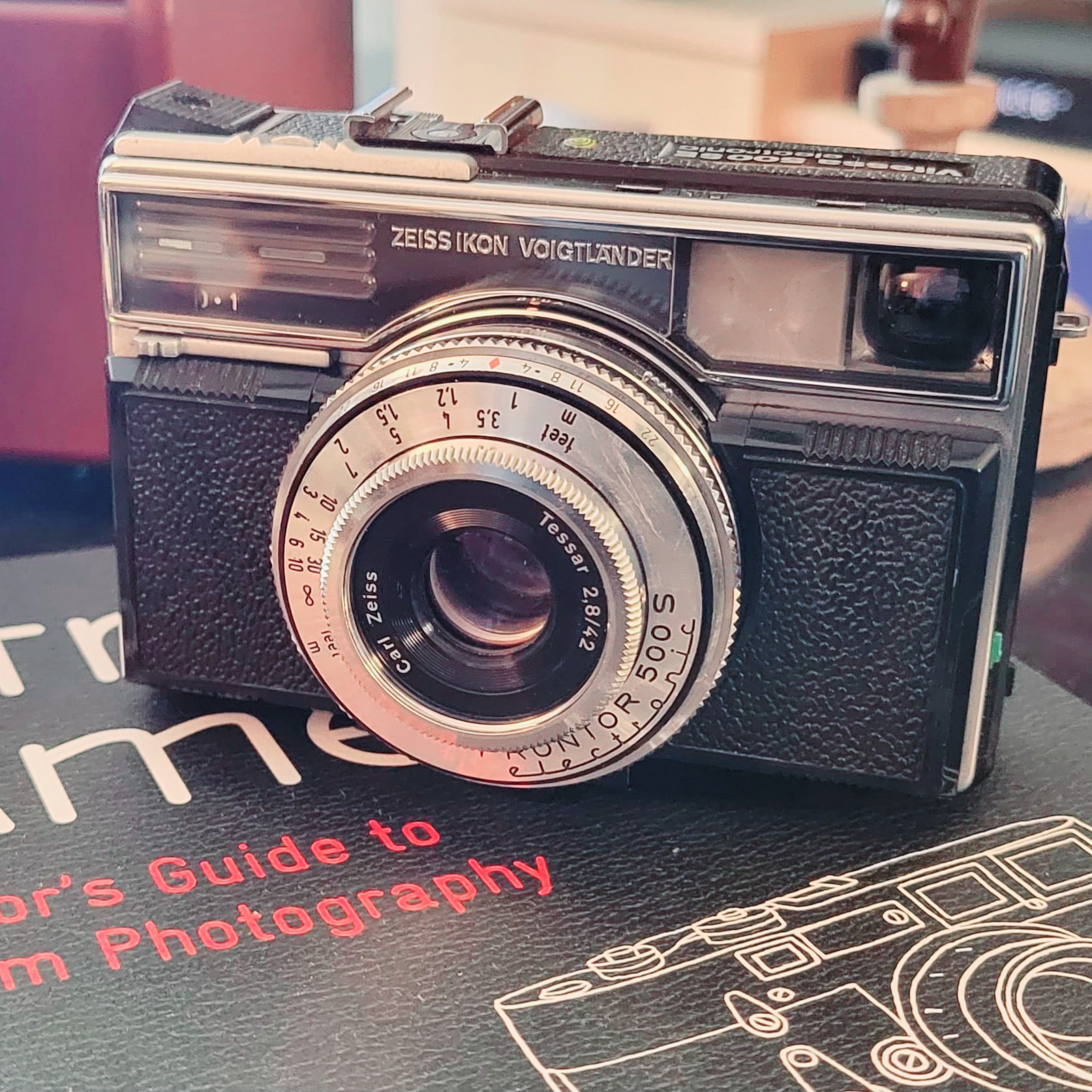

Does anyone rewind partially exposed rolls in order to switch film?
I'm very interested in experiences, opinions, and thoughts.
I just loaded this new addition with some expired Tri-x. 😁
