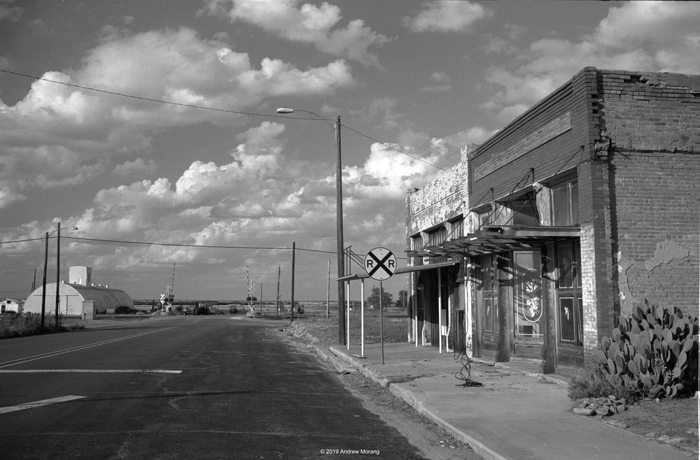

When I drove through the Texas Panhandle, the clouds and sky overwhelmed everything. Here is an example of a Fuji Acros frame from Chillicothe, Texas, taken with a polarizer. West Texas is fascinating.

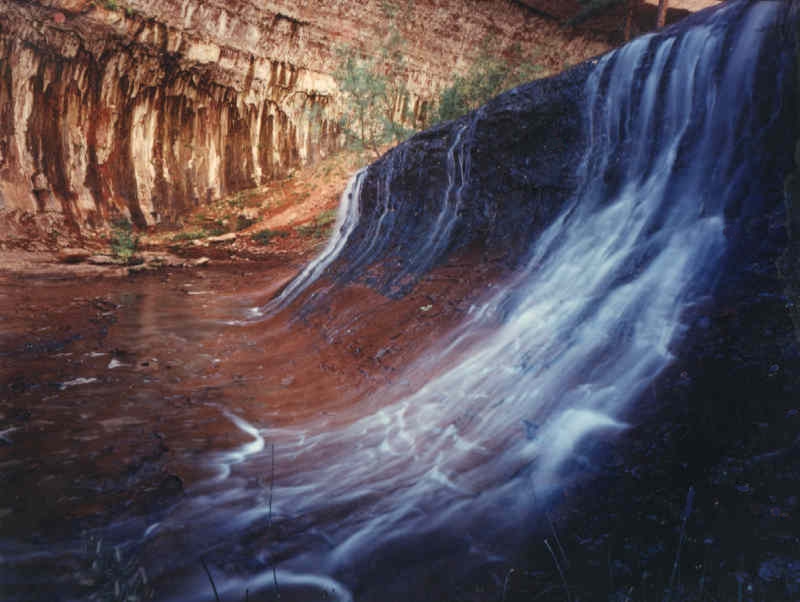

You don't know what you are missing. Here's a shot from the west side of Zion NP on Agfacolor 100 4x5"-- WITH A POLARIZER, of course!!! Fujinon SWD 65mm f5.6 on a TOKO NIKKI II. Somehow B&W does not do it justice.

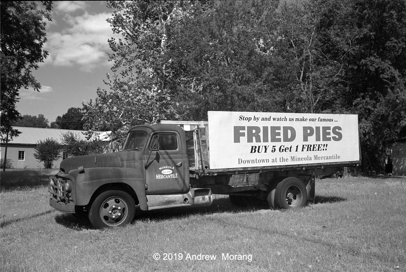

Here is another example of a polarizer with black and white Fuji Acros film, Yashica Electro 35CC camera with 35mm lens, Mineola, Texas. I think the polarizer is effective in this type of situation. And no, it is not especially hard to use on a rangefinder camera.
