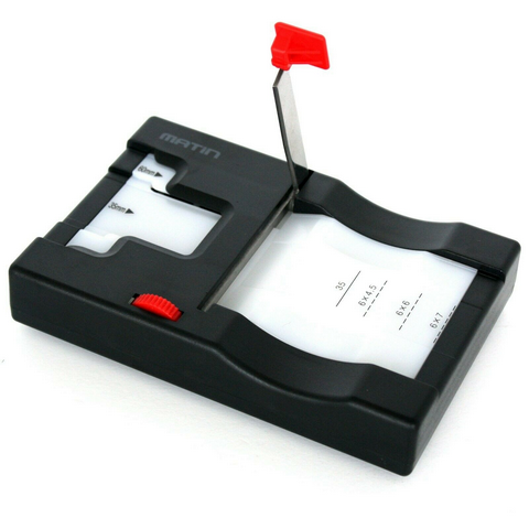

I use one of these:
https://www.ebay.com/itm/323831111499
Thank you Matt, such I was referring to.
