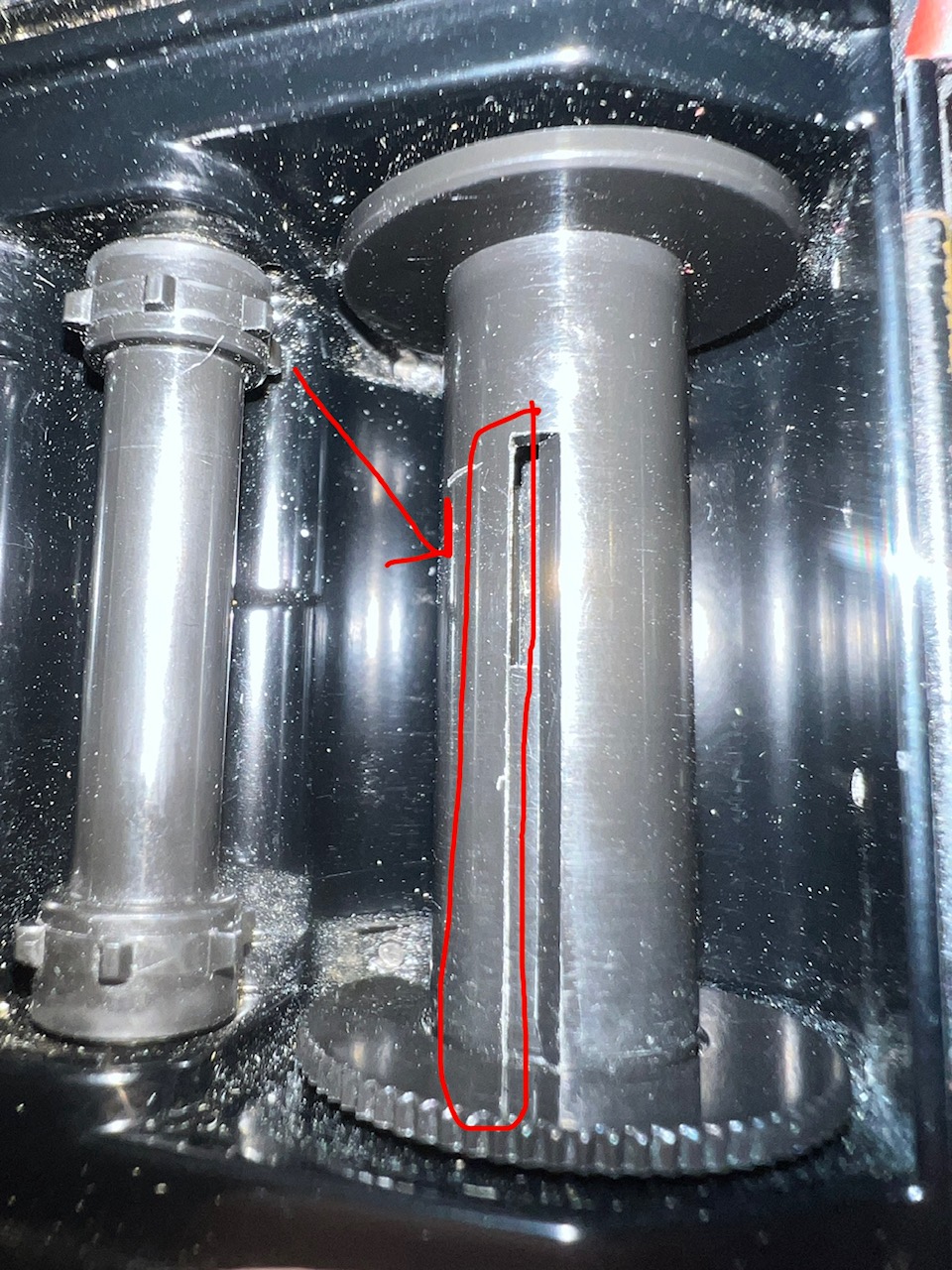

I am repairing a K1000 SE for a friend. He has stated that the film advance is rough, and he has experienced the film breaking on him a couple of times.
I tried some dummy film and did have the film break on me when inserting the leader into the take up spool. To fix this, I decided to take a razor blade to the take up spool and make some chamfers on some of the edges. I feel like this helped.

Can you clarify how the film is breaking? It seems odd that it would break right where it enters the take-up spool.

My friend stated that it broke in two different ways, at the beginning of the roll and in the middle of the roll. He didn't give me much context beyond that. He is an avid film photographer (uses an M6 and a Minolta X-700 very regularly), so I don't think mis-management of the film is the issue.
When it happened to me, it broke against the left side of the take up spool opening, circled in red in the picture below. The film I was using was old and expired, so I originally thought it was just brittle film causing the break. The left side of the take up spool was pretty sharp, so I'm hoping the chamfers I added help with this. When I load film, I take up all the slack in the roll, which puts more pressure on the left side of the take up spool. My theory is that is what is causing the breaks, not the advance.
For the record, I think his camera is fine. Just not sure how his film broke in the past. I don't think opening up his camera will accomplish anything. I shutter tested it as well and it has one of the more accurate shutters that I have tested. No capping!
@Howie1922 it's hard to fix something if you don't know what's wrong :smile: Surely your test film must have been quite brittle?
Braking film usually happens when the user forces it at the end of the roll. Or the sprocket holes get ripped out if the take-up spool clutch is too tight. That happens early in the roll.
If the film broke, check for fragments that might be lodged in the rollers. That film chamber, though, looks filthy…
