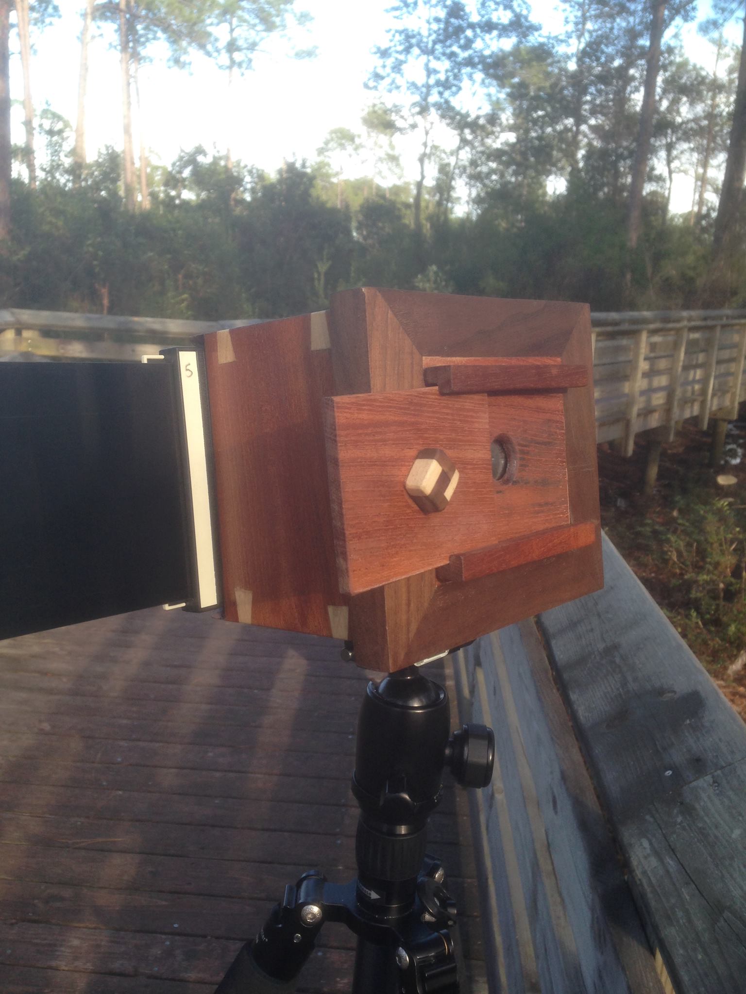

Thanks for the feed back. My current lens is aluminum foil blackened on one side. The hole was made with a tattoo needle. I damaged it this morning and will probably make another but I'm thinking about getting something a little more precise. Here's what I'm working with. Its mostly Spanish cedar(which is not Spanish or cedar) walnut, maple and mahogany. The front is held on with magnets to allow better access to the lens area.
Some nice woodworking there! I just dug back a ways where we had a thread that rambled quite a bit but covered a lot of ideas and philosophies of pinhole work. It was specifically about doing a pinhole adaptation for a Mamiya RB67, but most of the considerations are pretty generic. (there was a url link here which no longer exists).

Yes, very nice joinery!
