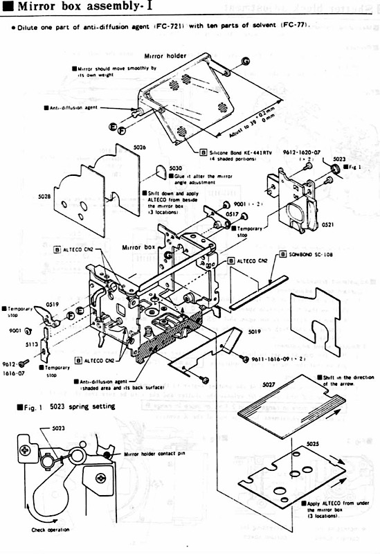

Removing the mirror box of a Minolta X-700 and disassembling it into its components is feasible ...
A nice, motivating idea
but there is a problem: even if I can completely disassemble a camera or lens and put it back together again, I also have to adjust it accordingly so that it works properly.
… also correctly assembling its components should be possible ...
This involves correctly set shutter speeds, aperture values, infinity, centering lenses or adjusting the flange focal distance. And this requires precise adjustments to the electronics and mechanics. Trim potentiometers have to be set, spring tensions adjusted, mechanical and optical components adjusted.
... but can you adjust everything so that it is set up correctly in the end?
A look
at the repair manual for the Minolta X-700, for example, gives you an idea of this. You need the right measuring equipment, the knowledge of how everything is connected and brought together correctly.
I think that is impossible even for a modern repair shop. Only the manufacturer and its service facilities could carry out such work, if they were not mainly just replacing prefabricated modules. If you don’t believe it, just ask a repair shop whether this or that work can be done or not.
