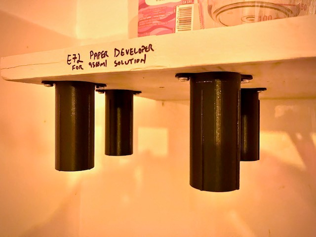

One gram per liter of EDTA did the trick. I put together a quick CAD drawing of a cylindrical container with two compartments so I can keep the alkalai and the non-alkaline ingredients from touching each other while they're waiting to be mixed up. I'm considering the EDTA an alkaline since it's the tetrasodium variant, which I guess has a pH of 11.3. 3D printed a few of these containers, so I now have pre-measured "capsules" of E72 ingredients that should theoretically keep forever. When I'm ready to print, I can dump a capsule into my 1 liter bottle, fill it up to the 750ml line, and shake it for a minute or so with the lid on. Everything goes into solution easy and the developer is totally clear.

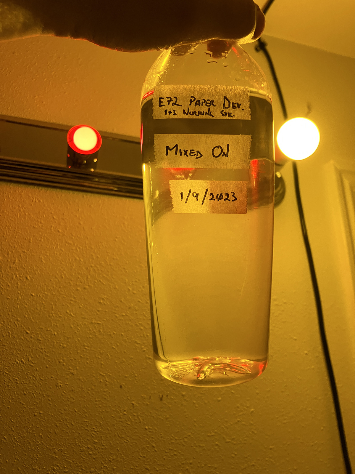

FYI for anyone reading this down the line, I mixed up a batch with the EDTA on January 9th and let it sit in the mostly-full plastic bottle until today when I was going to do some more printing. I ended up mixing a new batch of E72, but out of curiosity tossed a small test strip into the nearly 20-day old working strength developer under room light, and it still hit a very convincing Dmax in under 2 minutes. I'm continually impressed with this stuff.

The containers have two compartments to keep the alkaline powders separate from the non-alkaline ingredients. I've had zero issues so far using the powder after it has been stored as pictured for months. After mixing, the E-72 seems to stay good in the bottle for at least a week or two. I'm very aware that it's at high risk, at least on paper, of sudden death due to the Fenton reaction, especially using EDTA and my tap water (which does indeed have iron). But so far I haven't observed sudden death. If it's older than about a week when I come back to use it again, I'll toss a small scrap in under room light and confirm that I hit a proper Dmax before using it for any actual prints. When in doubt, it's very inexpensive to just toss it and mix up a fresh bottle.
My recipe for 950ml of working-strength developer (1:3 compared to stock solution) is as follows. Note that I"m using grains, because I find it easier to be precise when working with that unit (blame years of handloading ammo and weighing out gunpowder charges, which are generally given in grains). Feel free to convert to grams if you prefer.
