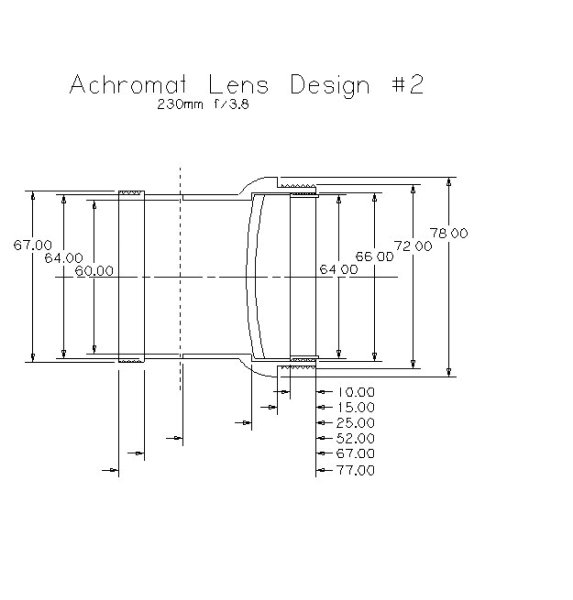

One design flaw that my drawing may/may not have is the way the lens faces. In looking throught the LVM, I only see two lenses that would be somewhat simular in construction - the Agfa Igenar f/8.8 105mm, and the Imagon. The agfa is setup how the lens in my drawing is; whereas the imagon has the thinner lens in the front.
I am thinking that I will have to wait and see what the lens profile actually looks like before I can make this determination; or trial and error. Unfortunately, all that I know is that the lens is 235mm in focal length, 60mm in diameter, and is a cemented achromat.
Also, I believe the landscape-type lenses have the concave surface facing away from the film.
Ok...
I found an old brass projection lens today, and picked it up. Upon taking it apart, I found it to have a 240mm achromat in the front, and a 145 in the rear. The one in the front is quite large (64mm) in diameter, and is of a good focal length for me; so I'm going to use it.
I revised the plans, and have posted them. The nice thing is that I also have the proper sized lock ring for the lens, so that saves me from making one.

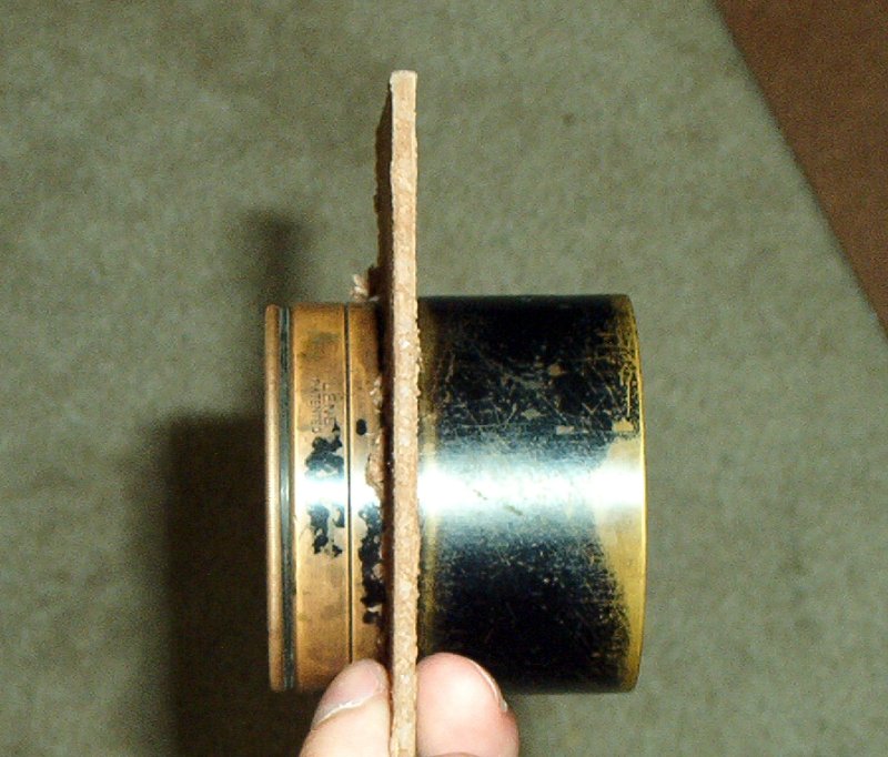

Nice. I've threaded several old brass lenses into tempered hardboard lens boards (made from 99 cent clipboards). Works great for relatively light lenses.

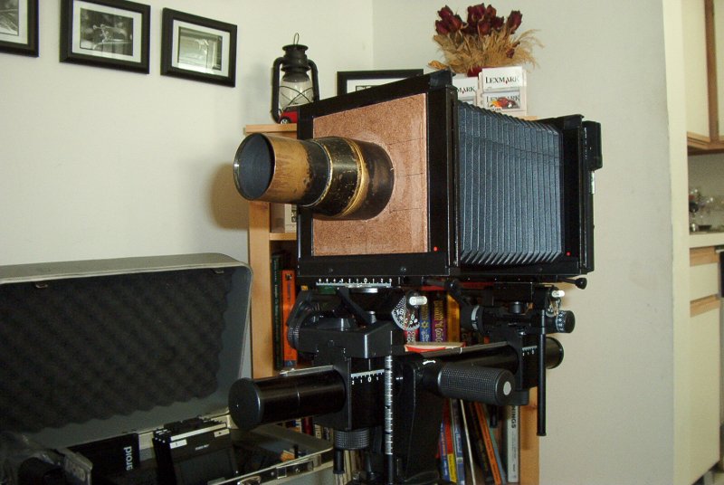

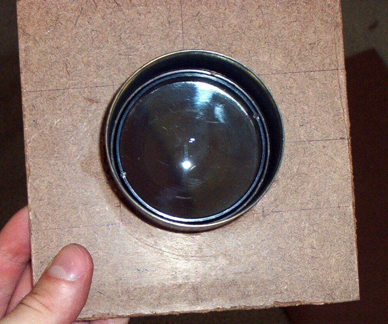

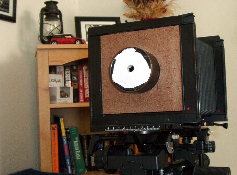

Today I made a quick lens board and tested the lens. Instead of using PVC I just used the old lens barrel, as a portion of it unscrewed. Thankfully, that still gave me 40mm of barrel to work with, as my aperture calcs placed it somewhere between 32-38mm away from the glass.
Taking the average of that number, I affixed the aperture 35mm away from the glass. I didn't see any vingetting. However, to be honest, I didn't see any when I pushed the aperture all the way against the glass either. Even with some big rise, there really wasn't much fall off until after 2" of rise or so. Could the image circle possibly be that large ? Did I goof somewhere ? The only time I saw some vingette was when I affixed the 'snoot' shown in the last photo; and even that didn't show w/o some rise.
I am pretty excited though, as the images on the GG look to be just what I was looking for :D
Anyway, here's some photos:

More....
I still wasn't sure what was the correct orientation for the lens to face, either ---> ((], or ---> [)).
So now that I have it mounted, I figured I'd give it a shot. This is what I found:
F=230mm
Wide open = f/3.2
Stopped Down = f/16
----> ((] Gives you a super sharp image stopped down in the center. The OOF areas aren't as 'hazy' as a typical meniscus would be, but rather everyhing swirled around the focused area. There is a pretty sharp cut-off as well between in and out of focus. Wide open its still really soft however.
---> [)) Gives you that typical meniscus hazy/dreamy look. Still pretty sharp when stopped down, but it slowly bleeds into hazyness.
Im going to go with the first one, as I think it would work best for me. If I were doing studio work however, I would probably go with the second one, as for tighter shots I think it would work best.
When I put that snoot on (f/4.5), it makes some real nice images on the GG. I think I may revise my plan and close up the barrel slightly to have that as my 'wide open' aperture.
Ok, final design which I will import into the CNC lathe. The only major difference between this and my first drawing is that I added provisions for a 67mm filter thread in the front, and I moved the aperture to the proper place.
I can say with certainty that the aperture on a meniscus sort of lens should be between 1/7-1/10th the focal distance away from the lens (if placing it in front of the element). I discovered this in some readings, and after confirming it with an individual on the Large Format board whom has done more than his fair share of reading.

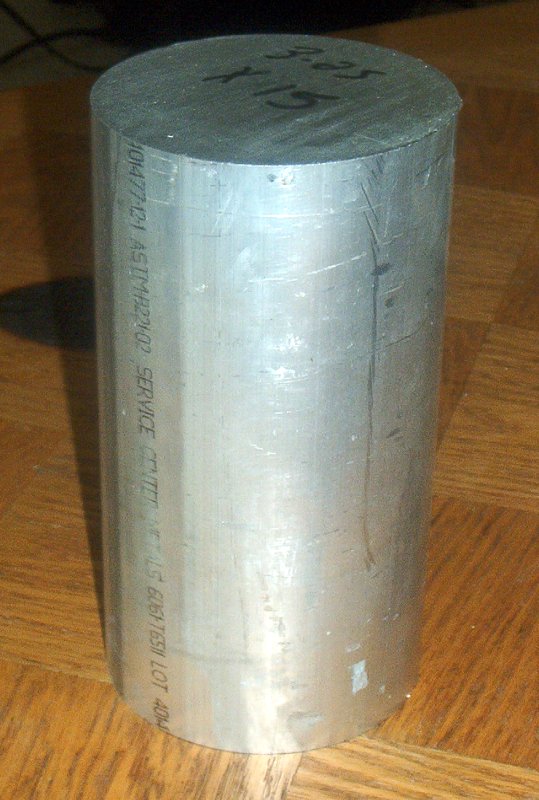

Ok, so my hunk-o-aluminium arrived today. I just couldn't justify paying 5x the cost for brass on a lens design that is really untested. I still haven't decided upon which shutter system I am going to use (electomechanical packard or Ilex), so therefore I won't be cutting the barrel until I do so.
Thankfully I am on vacation, so I have some free time to think about things before I return. Either way, I hope to be cutting the barrel the first weekend of next month.
