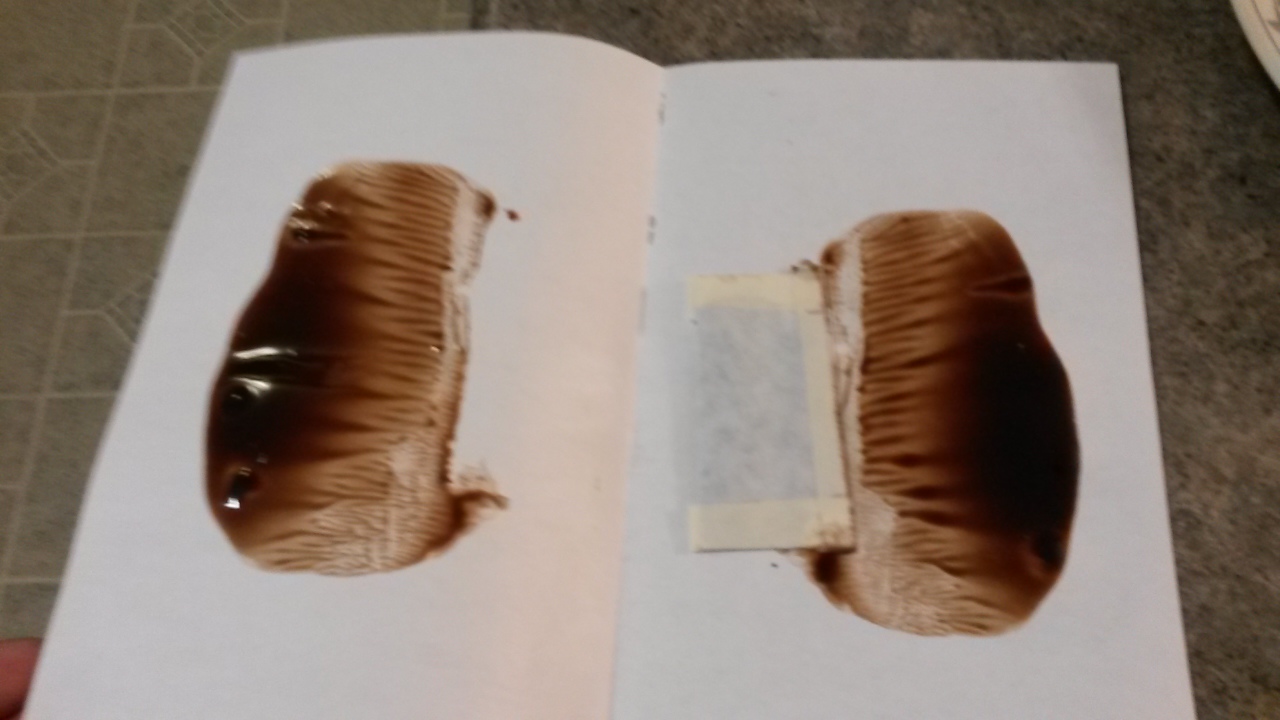

So I've been playing around with the idea of hand making some experimental film that would fit in the 30 and 40 series Polaroid cameras (just scaled up/down between the two), but am having trouble with making a reagent pod that will burst evenly and without excessive force.
So far I've tried using mixes of tin foil, plain paper, tape, and waxed freezer paper, and for the bursting seal tried simple folds (on the foil, not very airtight), two separate pieces of tape, adhesive side together (that will separate under pressure), and several heat seals with the freezer paper. They all seem to either not seal enough and leak, or seal too well and not burst at all, or unevenly.
Chemistry and film materials are secondary right now as I figure this out, so please don't tell me it can't be done.
Also, I've already seen this: https://www.instructables.com/id/Making-instant-film-at-home-polaroid-55-/, and tried following his pod making but it hasn't worked. The "reagent" I'm testing all of these seals with has been chocolate syrup because, as memory serves, it has a similar consistency to the reagent of FP-100c pods. I'm too young to have used real Polaroid materials before they were long gone.
Any ideas out there for different pod materials or building techniques?

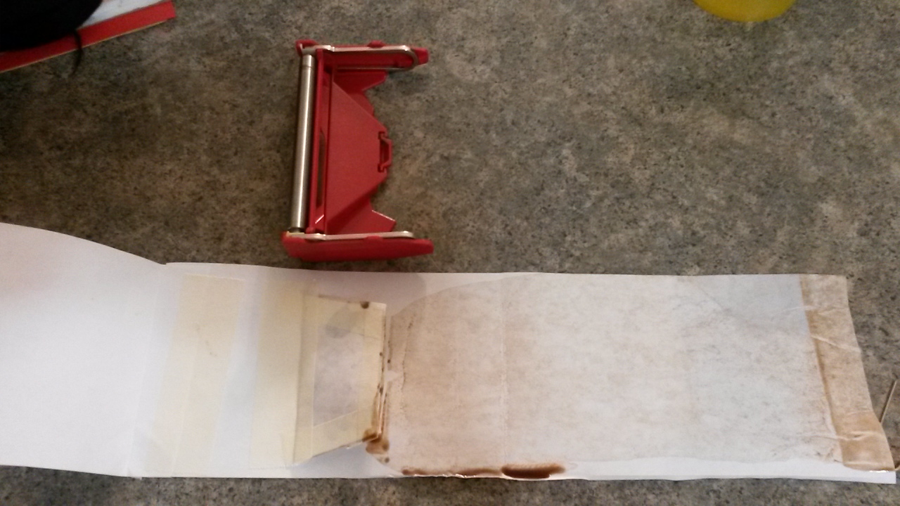

Its not so much that I don't know how to imitate the original construction- I have used film right here that I'm basing dimensions off of- its that I don't have the capability of creating an exact replica. For that I would need the special plastic coated foil they used, crimper for the side seals, and a heat sealer with very precise control. I have tape, paper, freezer paper, a wood burner, and the heat sealer from a vacuum packer that I've used so far. The heat seal would seem to work best, but it seals too well or too thickly, and so can't burst under pressure from the rollers.
By the way, for rollers right now I'm using a round pen and rolling it over a sheet of paper folded in half with the pod inside. I know it has comparable pressure to actual camera rollers because I did do a few tests with some rollers out of a pack film camera (the removable type).
Have you tried using the roller back off an old Polaroid camera for your experiments?
I'm not sure what you mean by the roller back, I've been using the removable roller assembly used in the rigid bodied packfilm cameras. For making a good seal it doesn't really matter what kind of roller I use, so long as it provides consistent pressure across the whole surface. The distance between them, or their size, is only important to getting the thickness of reagent correct between the film sandwich, which is why I've been getting by using a pen on a flat surface.
Maybe instead of trying to get it to all break at once, and start off with a even flow of developer across the pod, set up a few weak points in your seal, so that it breaks at 3 or 4 points. That would be easier to engineer. Then give it a bit of space to flood before it hits the film, to even itself out. The trick will be setting up the exact height between the rollers, and keeping a low ceiling over the film, inbetween the front and back papers, so the volume is forced to occupy more horizontal space. You don't need the developer to spread evenly across, just coat the film evenly as it passes. If you throw in some extra developer and exactly control the height of the roller in relation to the height of the paper/film, you should be able to still get an even spread (and maybe have a trough at the end for the extra to settle into).
I'm just spitballing here. My closest analogy comes from coating paper using a glass rod. With that, you can pretty much make a puddle or two in the middle, and just push the rod across. Keeping the right pressure pretty much ensures it will coat evenly once you've pushed it a little distance, as the capillary action against the rod with spread the emulsion out on it's own. I usually run it back and forth a bit before rolling it over the paper, but that's mainly to ensure it coats evenly at the beginning without wasting paper and emulsion. One things for sure, it's never evenly spaced across the rod, but does get evenly spaced across the paper (if done right).
We found that the best spread was achieved by having a separator in the center of the long end of the pod, so that it broke in two segments, one on each side of the separator. The goo then formed two wave fronts that joined as they moved down the film. This joining happened almost immediately to give a solid straight wave.
PE
I didn't have access to the heat sealer tonight to test the center separated pod idea, but it does seem like I need to be testing using rollers rather than my more crude pen method. I made some better seals with the cut tape method (where tape is folded over the breaking edge, then cut so the fold is gone but adhesive is still holding it together). Also, looking at some old pods I noticed that the side crimps are angled, so that the goo gets pushed more toward the center as it gets squeezed out. I tried this in the first picture and it seemed to work well.
I'll keep updating as I experiment.

That looks vaguely like a viscosity problem. You might want to try getting some Carboxy Methyl Cellulose. It is sold under several brand names at drug stores in the US. It has many useful purposes that need not be discussed here. :wink:
Anyhow, by varying concentration you can vary the viscosity up or down.
