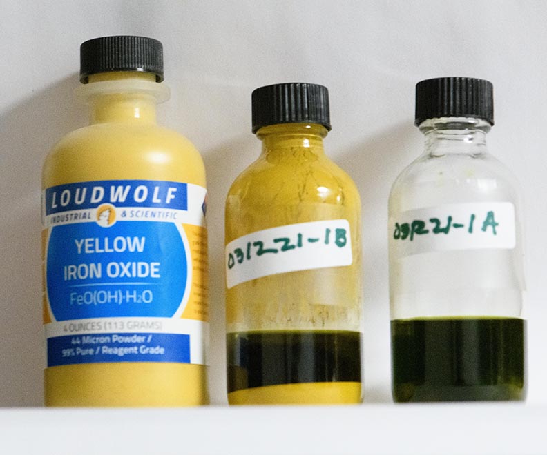

Years ago I was wondering if you could take commercial Yellow iron oxide, add oxalic acid and make FO. In one bottle, I used excess iron oxide (based on theoretical stoichiometry,) in another I used excess oxalic acid. I left them for a while. Nothing happened for days, weeks, months. I stopped checking after a while. Some 2 years passed and I happen to check on the bottles as I was cleaning out stuff for my move. Well, there was a nice green solution in both of the bottles. One with the excess iron oxide still had some pigment. The other one is nice and clear. Somewhere between 6 months and 2 years, there was complete reaction. Never did any printing or checked if this is indeed photosensitive. I still have the bottles. Not a very practical method but interesting!

I did a similar exercise a few years back with ferric oxide granules (used to purify fish tank water) and citric acid. The result was similar - I got ferric citrate, but it took a few months.
I think it might still be viable in some situations. I guess if you start the process when you already have enough for a few months, it will be ready when you need it. You'd have to deal with any excess oxalic acid if you're making kallitypes.

I couldn't tell you for sure. My notes are AWOL....🙂 If I have to guess, I would have wanted to make the same concentration as the commercial FO so 20% would be it. Some time ago I checked with K ferricyanide and got no blue so it seems to be stable too after all these years.
Wouldn't the synthesis be much faster if Yellow Iron Oxide is first reacted with Nitric Acid to get Ferric Nitrate and then react it with Oxalic Acid?
Yeah that would make sense, but I was trying to make a easy 2 part reaction without involving anything nefarious like nitric acid. I think I read about this an old journal mentioned by probably Namias, but forget now.
That's very encouraging. You can perhaps do a Cyanotype Rex with it. The one without excess of Oxalic Acid could be good for Kallitype too.
