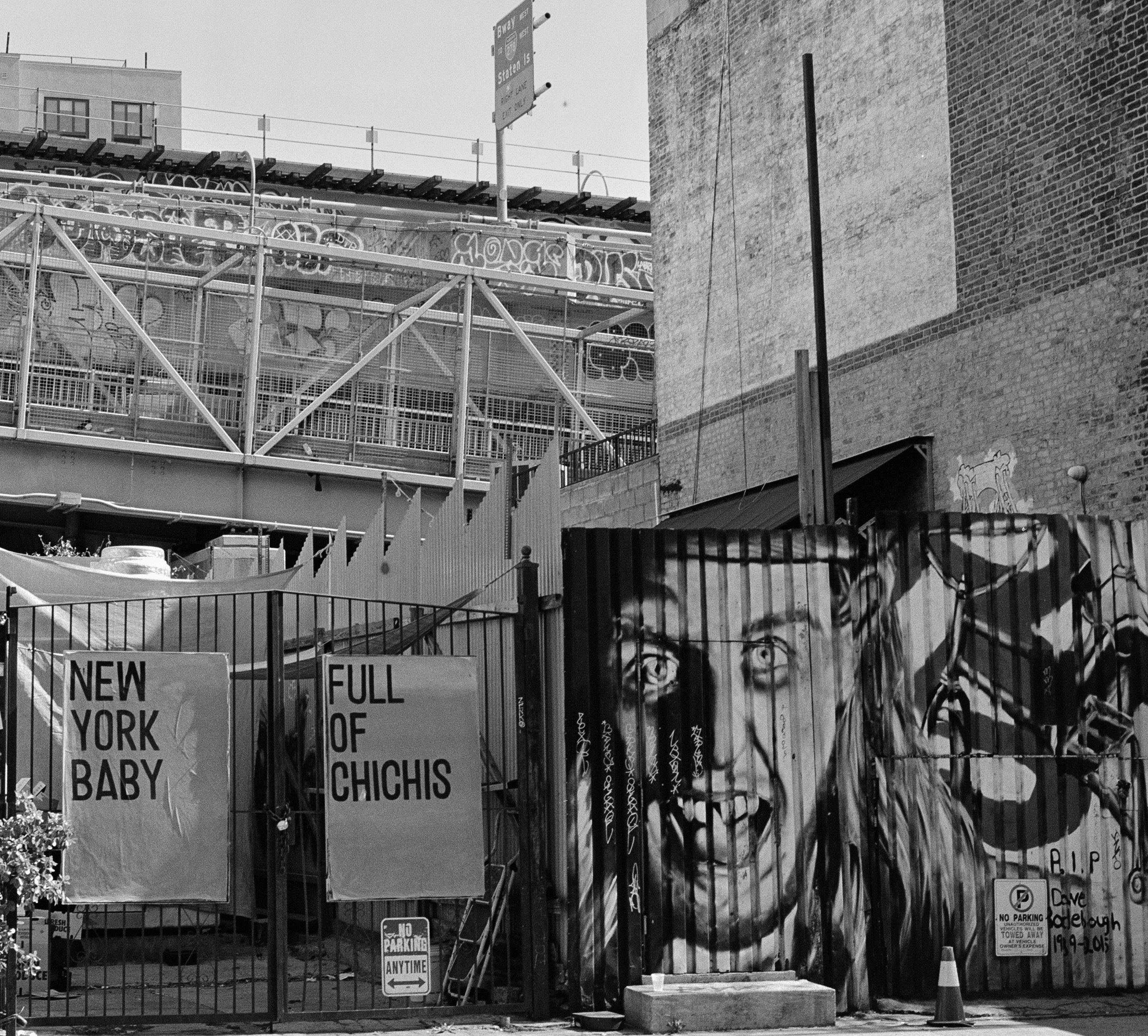

An oldie, but a goodie, but I haven't seen it much discussed lately.
Long time and happy user of Pyrocat HD at 1:1:100, I tried it divided for the first time yesterday at the usual formula: 75 deg F, 10:10:100, 5 minutes for both A&B: 1 minute agitation and then 10 seconds each additional minute.
Did 6 rolls of 120, which is all I had. This was with a Mamiya 7 80mm Tri-X, heavily cropped. In B&W Mamiya glass can render very sharp and contrasty (sometimes too much for my taste), but I think this developer/method manages that nicely.
Of course 10:10:100 turns an inexpensive developer into a very expensive one (I buy pre-mixed as I won't mix these chemicals myself). I'm also playing around with Barry Thornton's 2-bath, but need more experience with it.
Does anyone use Pyrocat HD divided with smaller amounts of developer? Wondering if it works as well.... Only one way to find out, I guess.
thanks!

As to preference, I don't know until I try. I thought that the divided I did use "tamed" my Mamiya 7 glass better, but of course that's completely subjective. Sandy King--a superb photographer--continued to investigate divided Pyrocat and so that stimulated my interest.
But certainly, it's both more expensive and more work (fun?).

As I said in my first post, I've not been completely happy with the way the Mamiya 7 renders, with whatever developer I've used, most recently and longest and closest to "happy" with Pyrocat 1:1:100. (Someone I know has gone back to D-76 for his Mamiya 6, as he thinks it helps soften the image a bit.)
But what I posted at the top is a slice of a photo developed in 10+, and, for my personal taste, it gets me where I want to be. So, for me, it does make a bit of a difference.

........... I thought that the divided I did use "tamed" my Mamiya 7 glass better, but of course that's completely subjective.
Is the problem too much overall contrast or conspicuous edge effects? If the former, less development as suggested by

Thanks, John. A little of both, actually. Yes, softer outlines are desired. Someone I know who feels the same about his Mamiya 6 glass has gone back to d-76 for it. Perhaps I will, though I'm so reluctant to give up on Pyrocat HD which, for many reasons, I'm a fan of. Anyway, all good fun!
