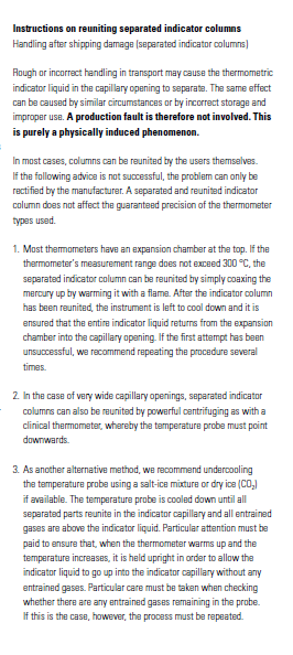

divided column in Kodak thermometer

it's a mercury one...is a fix possible or will it no longer end accurately?
When you say divided, you have two bits on top of each other? This happened a few times to me. I stuck the thermometre in really hot water, forcing the mercury up to the top. Then let it settle back down. Always seemed to work.

Here is the full text by Schneider:
I would first shake it down, then heat and finally cool. Repeating the last two if necessary.
