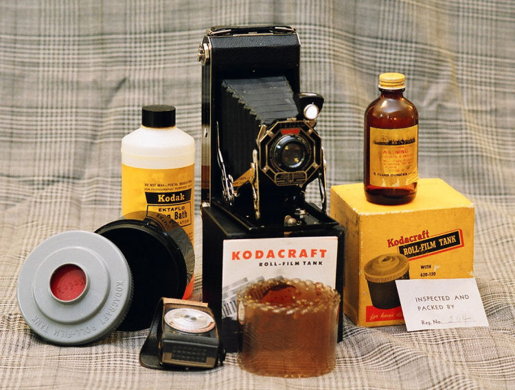

Has anyone ever used a whole bottle?
Yes, but it took more than a decade:smile:. You can see it in this MSA submission I made 3.5 years ago (it is on top of the Kodacraft Roll Film Tank box).
