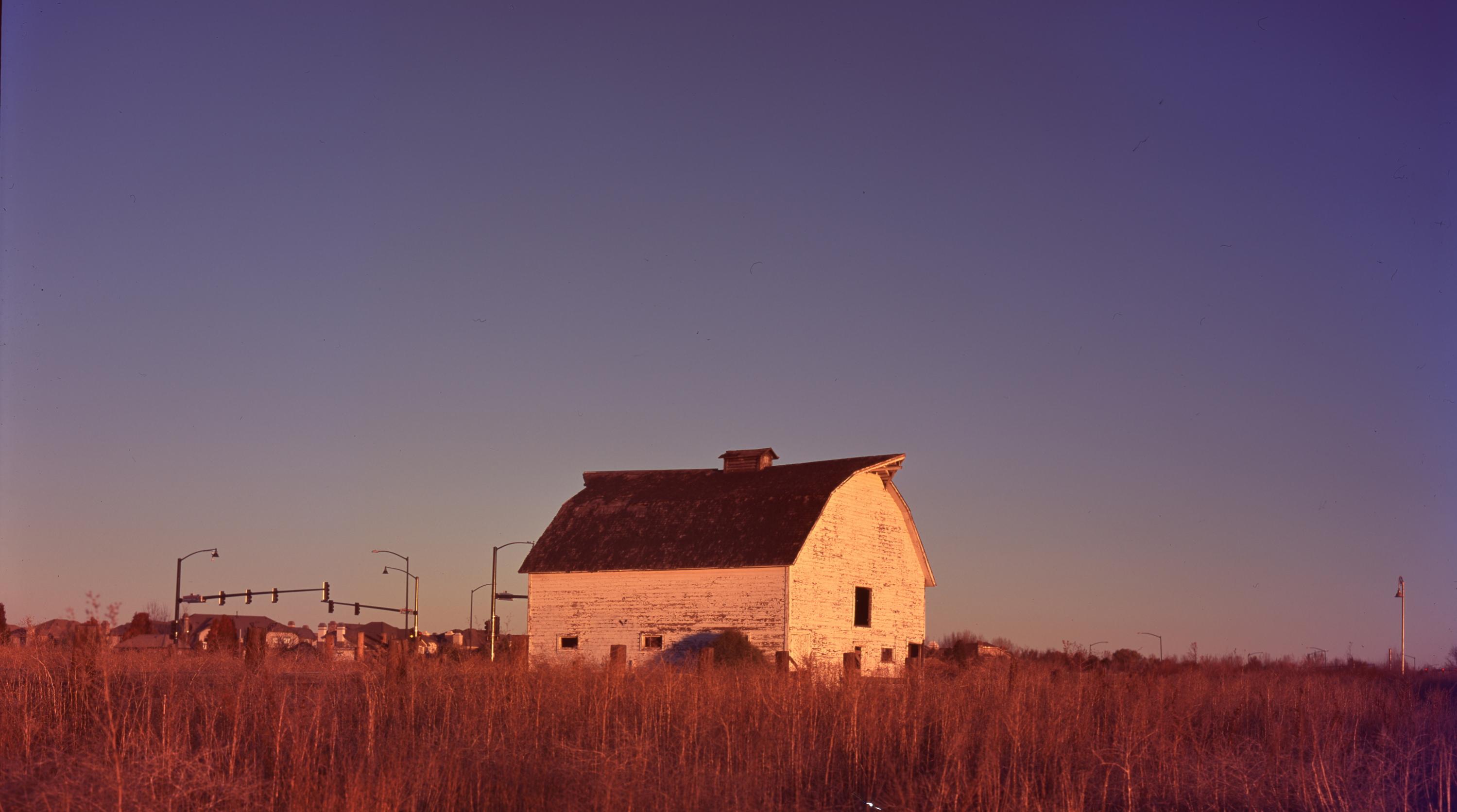

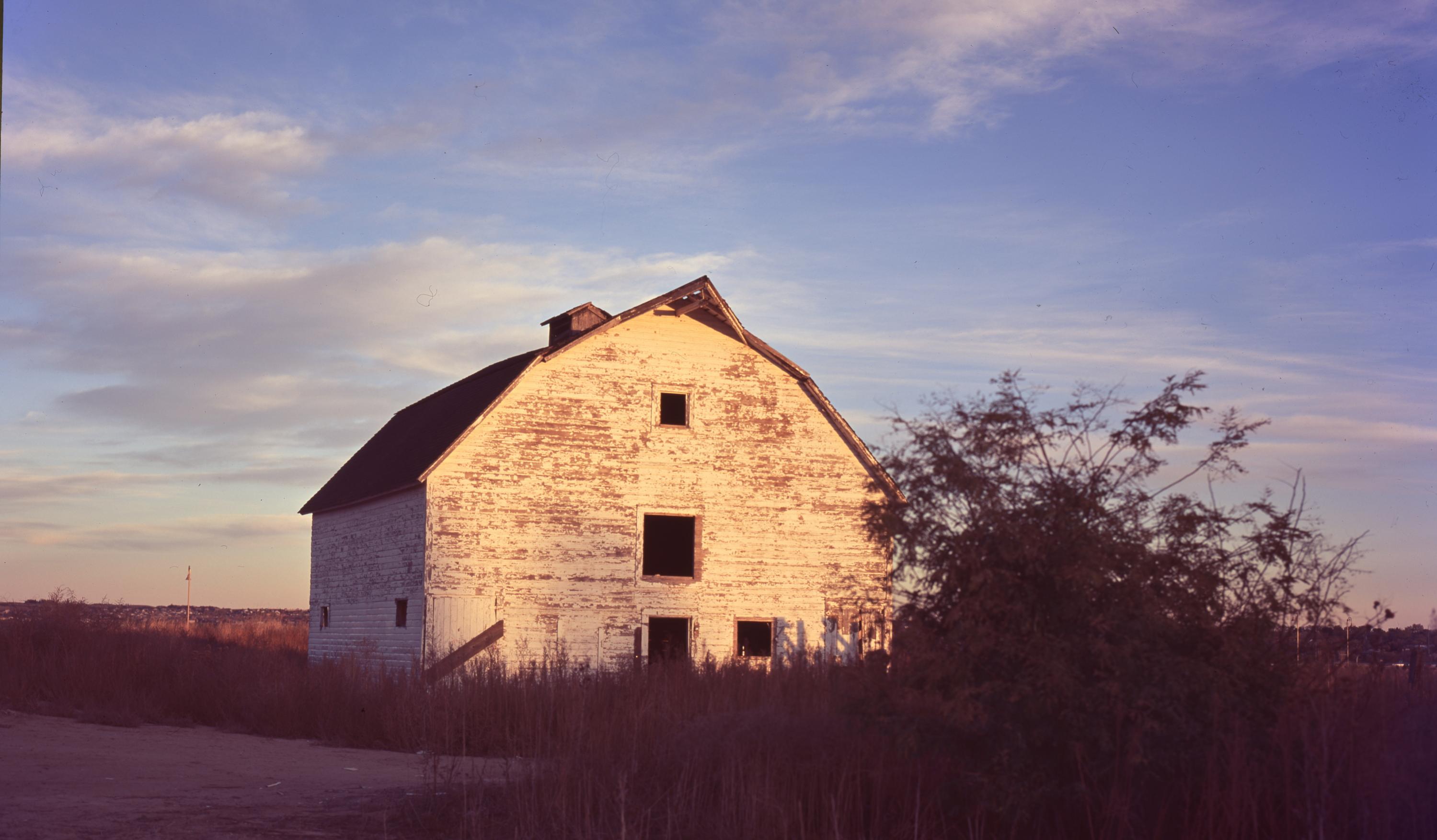

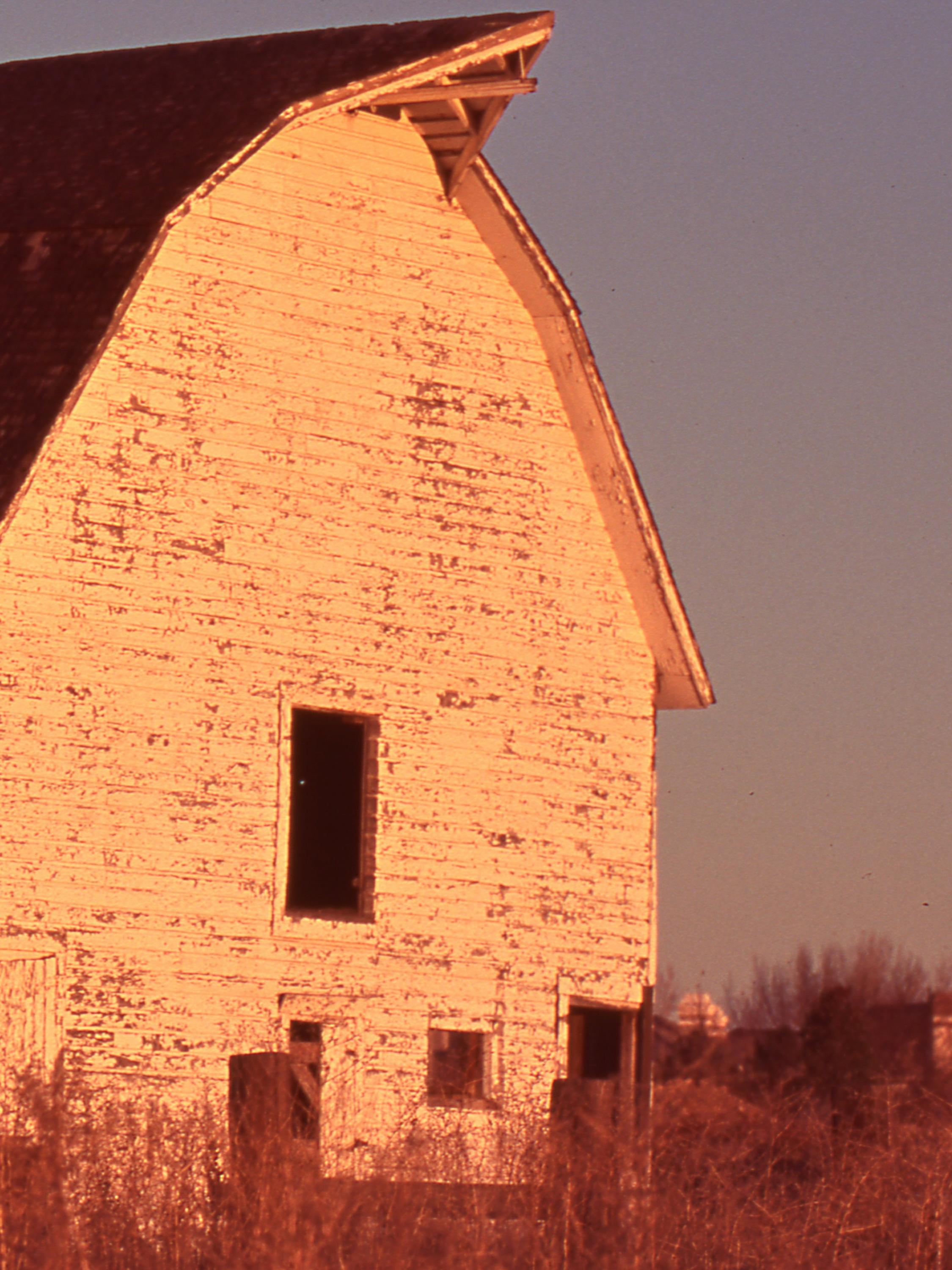

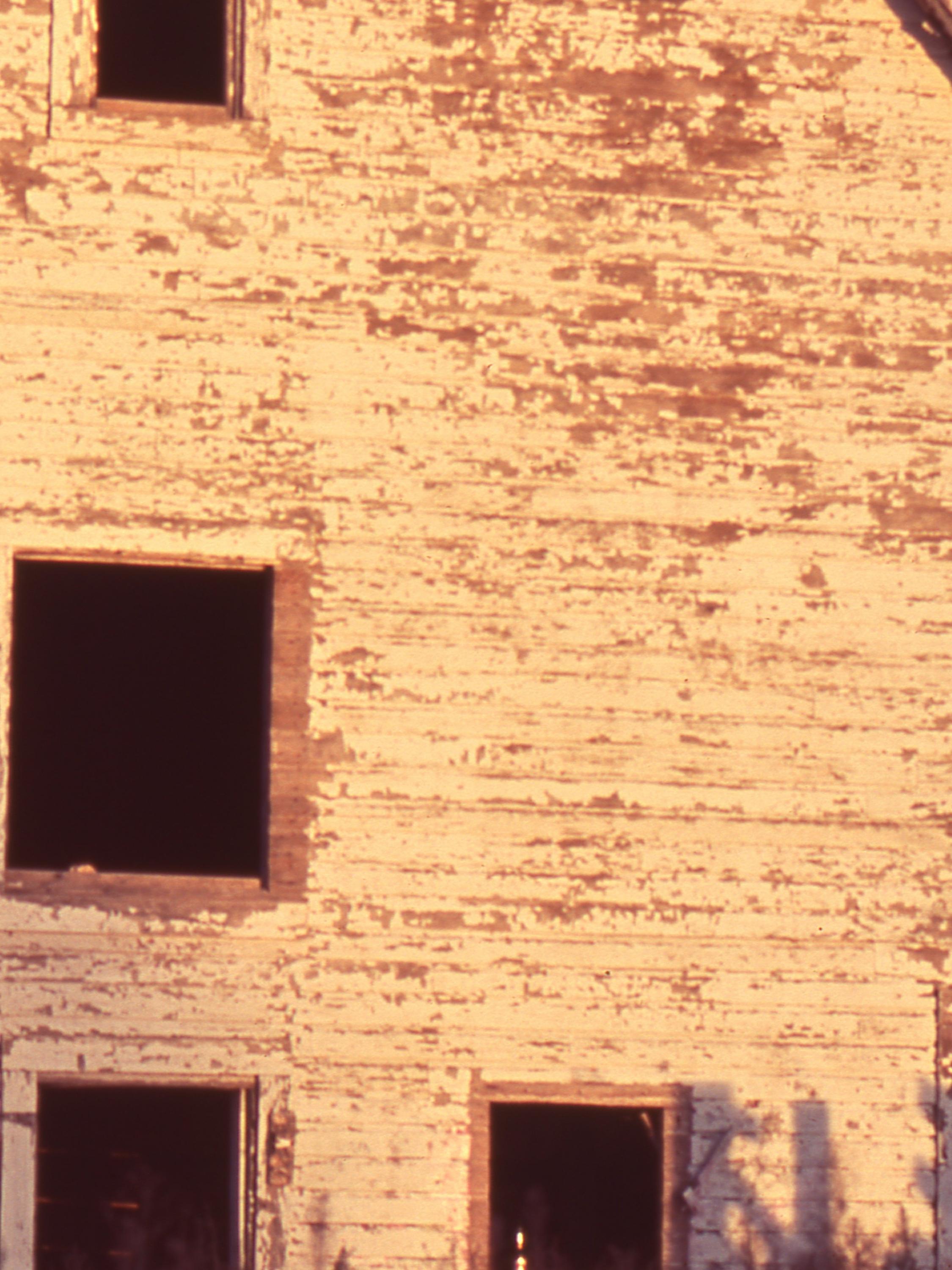

I've just started playing with a Crown Graphic with a Schneider-Kreuznach symmar 150mm/f5.6 lens.
I just can't seem to get a really "sharp" image.
I've attached some samples. These where shot on a tripod, f8, 1/100 (which is closer to 1/75 with this lens), 4x5 Fujifilm RVP 100F. The cropped sections are 1:1; I had to reduce the file size of the full image in order to upload.
I'm focusing on the gg (the range finder is missing the "plungers") using a magnifier. Images scanned on a Epson scanner at 4800dpi.
The only other issue: the ground glass is cracked but seems to be tight against the Fresnel lens. When I first got the camera the gg was between the Fresnel lens and the camera lens, (images were really fuzzy). It's now setup: lens > smooth side Fresnel > rough side of gg (the two rough sides are against each other).
I was expecting the images to be a lot sharper; am I expecting too much? Frankly, my Century graphic blows this away.
Any suggestions would be appreciated.

The rough side of the ground glass should be closest to the lens, the same place as the film plane. Do you use a loupe to focus? You should be able to get very sharp images.
rrocco
Sep 29, 2008
28
Southern Cal
Don't think the focus is your problem. You have your foreground and background both out of focus and the barn is in focus (though details are not sharp). I think your problem probably lies within the lens or technique. To test the lens you'll want to take a picture at a smaller aperture. This will increase your depth of field and sharpen the image. Another issue related to the lens may be due to shutter vibration or vibration in taking the photo. Try to use a higher shutter speed, use a shutter release cable and very importantly a heavy/sturdy tripod. Don't give up. With your setup and good technique you should be able to achieve astonishing sharpness and detail.

I wonder if this is a camera shake issue since nothing is in focus? They were all taken on a tripod but not a great tripod.
Going forward:
I'm going to shoot some "angled fences" to see if anything is in focus.
I'll also take some photos using the self timer and higher lens speeds.
I have another lens Carl Zeiss Jena 13.5cm/f4.5; but I don't think this is a lens issue, but I'll play with it.
Forgot to mention, barn016 waw shot at sunset; barn017 at sunrise.

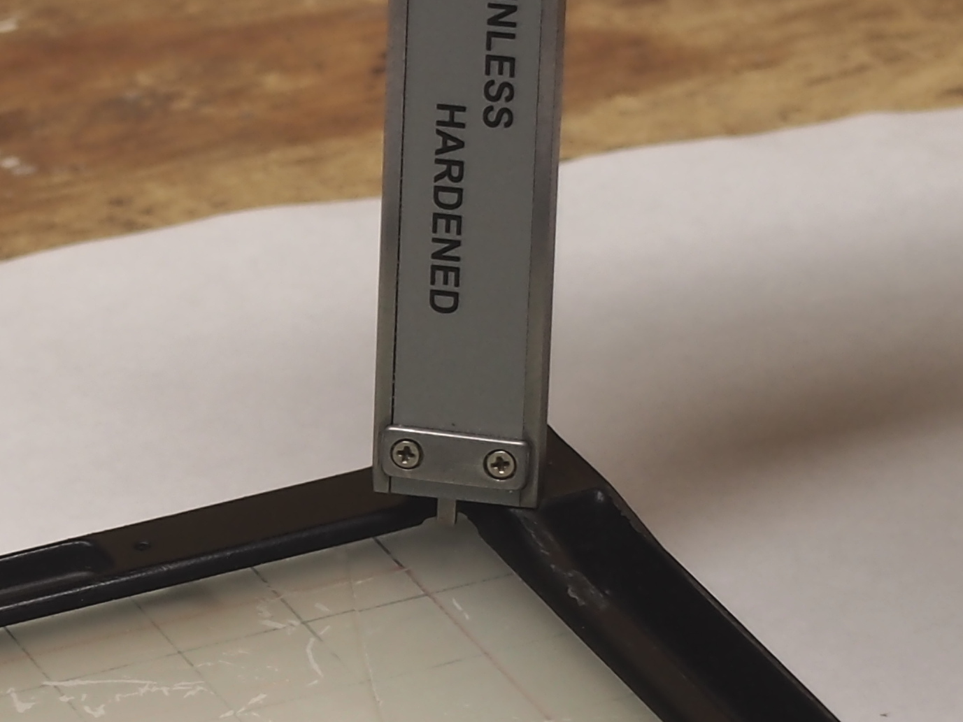

Just so I'm clear, here's a photo of what I think we're calling the "T" distance. It measures 0.141". Also, my Fresnel is only 0.068" thick.
attachment.php
