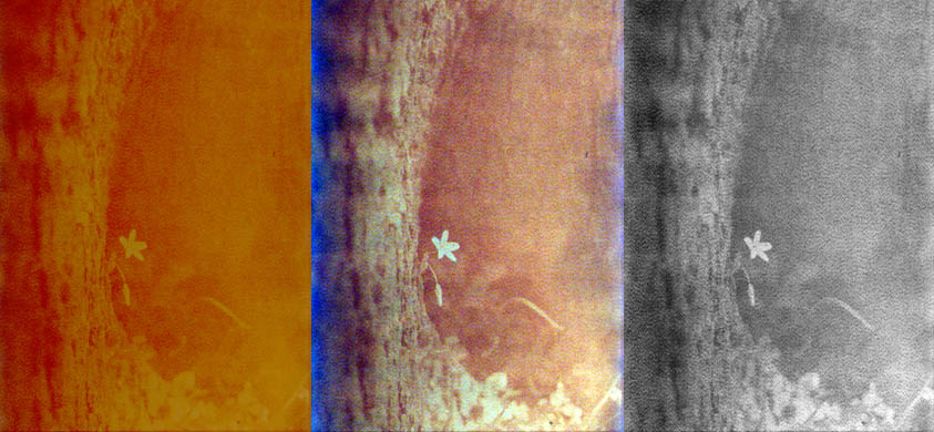

ok this is the shallot developer...second time I got a reversal....after 1 hour
from left to right....original image...."autolevels" in photoshop...desaturated image
...also got images after 2.5 hours, but my scanner doesn't work well with dark images so I didn't post them
