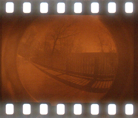

    here's one of the two images...if I had known this was going to happen I would have developed the whole roll...but i only processed a short strip of film

    Odd that I don't see any edge markings... but still that's pretty cool! I hope you measured carefully and wrote down your recipe.

    re: edge markings....the edges and areas between frames are actually pretty dark...dunno why edges seem so light in the scanned image...on the actual film the edges are much darker

    I suppose that's because of the auto-leveling software. It sees the sprocket holes and includes that white space in the exposure calculation. If you crop out the sprocket holes in your scan software, you may see a better result.

    thanks...I usually crop out the sprocket holes
