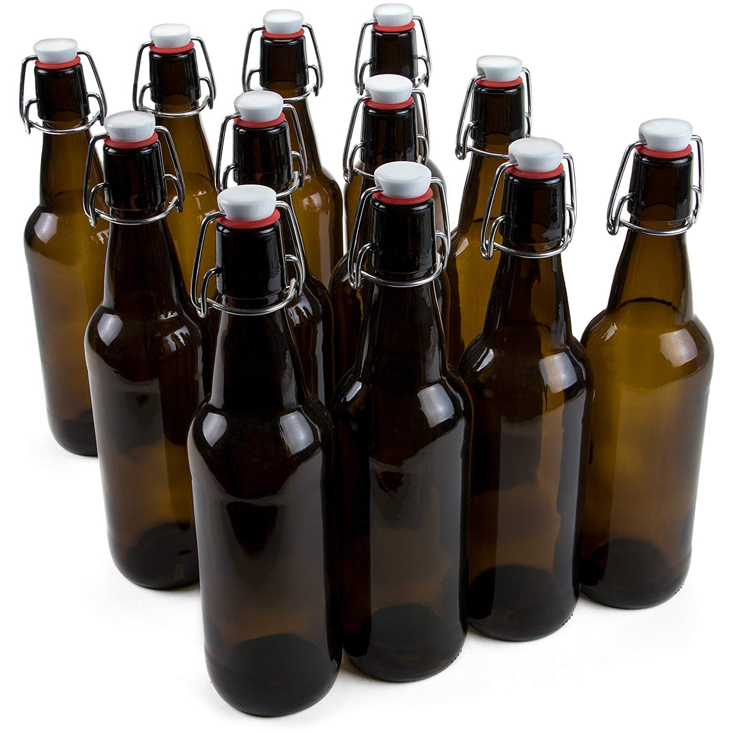

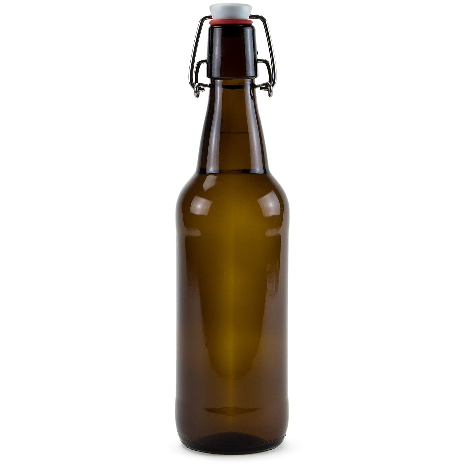

I mix up the entire 5L in a bucket and then store in 16 oz Groush style bottles filled to the top. As I use some, I drop glass marbles into the bottle until it reaches the top and then attach the lid. ZERO o2 in the bottles ever. I don't worry about it 'turning' on me.
