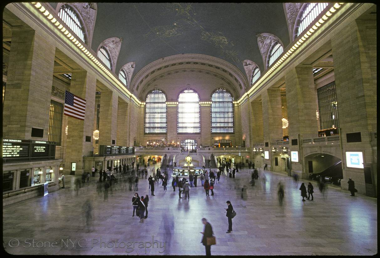

StoneNYC
Aug 5, 2012
8,345
Antarctica
8x10 Format
Kodachrome 64 (that's 2/3 a stop slower than your 100 speed film)
Probably the same amount of light you had to work with... (I mean the amount the people were exposed not the light in the window which is obviously brighter).
Just saying you don't know until you try...
Also, try and guess WHEN this was taken because you won't believe me :tongue:
Given that it's Kodachrome, I can 100% guarantee that it was shot on or before January 18 2011 :tongue:
