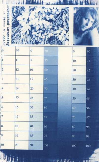

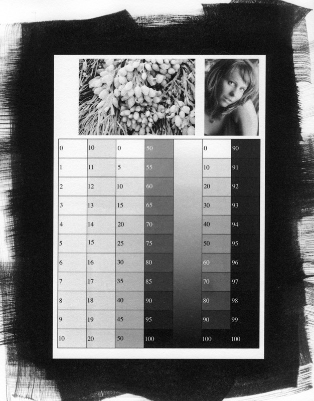

I haven't seen much about this printer and digital negatives, so I thought I'd share what I've learned. I'm just learning hand coated processes, so I've just used cyanotype so far. The Platinum kit is on the way, so we'll see how things work with that soon. At first I was having trouble getting enough UV density with the black and white mode but printing as a color image, with intensity pushed all the way up and with Matte paper selected, I'm getting pretty good density. My cyanotype curve, I've had to cut the density back a little actually so if I need more with platinum. As far as color density goes, a dark green and full black give about the same UV density. The color chart and one of my test pattern's are below, if anyone's interested.
Peter
Palladium update

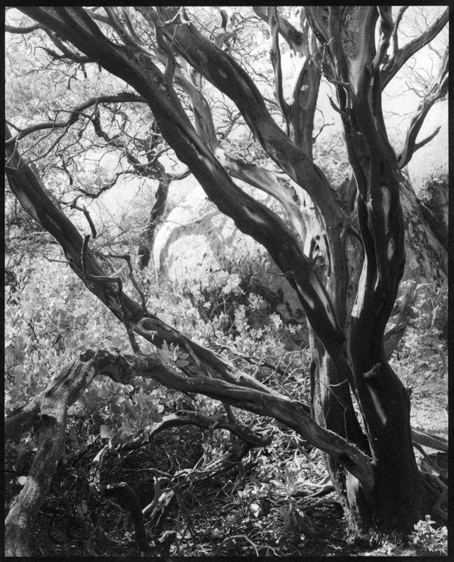

I've managed to get some good results in palladium using the B&S digital negative kit, which is Palladium with PT NA2. I've gotten more than enough UV density to use the high contrast formula, I could probably print with straight palladium.
If anyone's thinking of using this printer for digital negatives, it certainly is capable, at least for PT and Cyanotype. I'd be glad to share any details if anyone has any questions or is having trouble.
