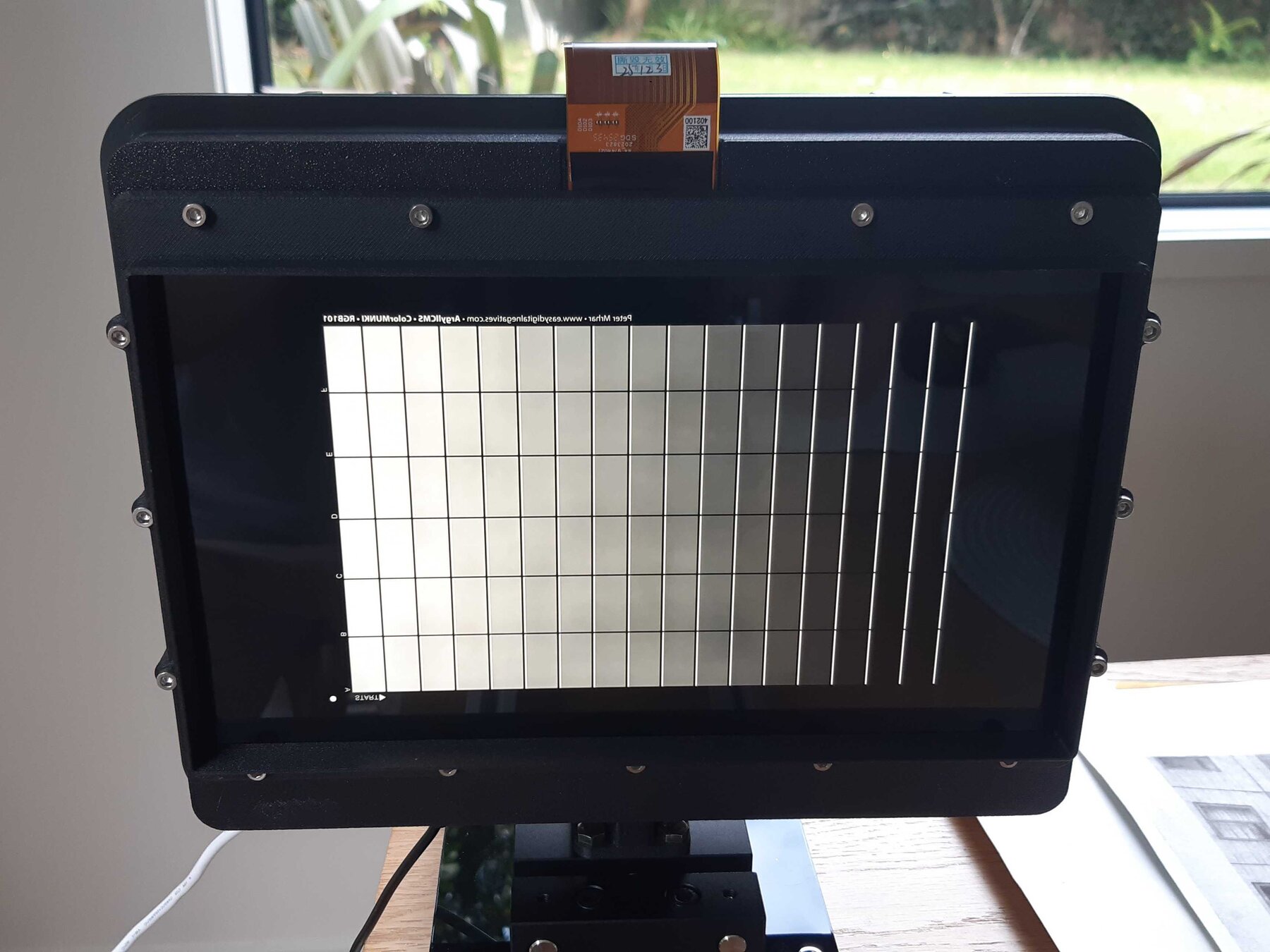

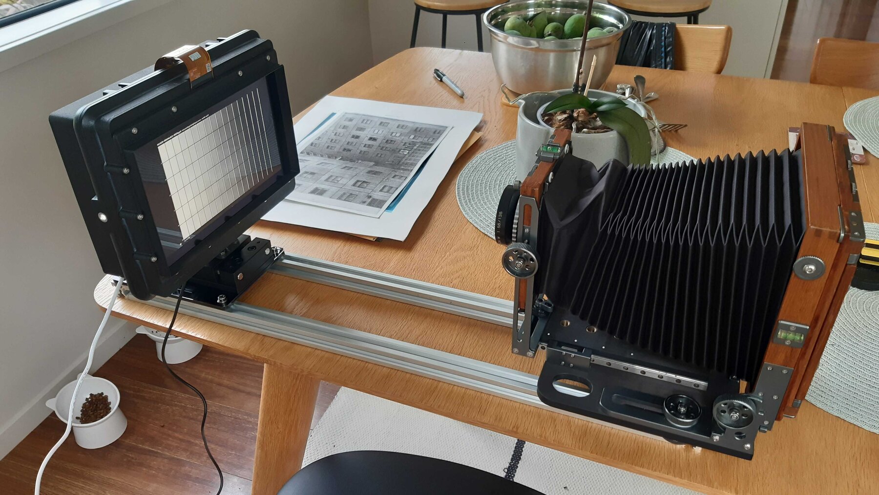

Been busy, but made some progress on my LCD-based 'digital film writer'. It's basically a fancy metal frame to hold my 4x5 camera and backlit LCD screen in alignment, which also allows for separate movement of the LCD and lens standard for changing enlargement and focusing (a very futuristic copy-camera).
The whole contraption
Test image displayed on the LCD screen.
Test image as viewed through the camera ground glass.

I made a somewhat dark box to go between the LCD screen and the camera to keep light out, the two parts can telescope inside each other to allow for focusing (the black paint coverage is better on the inside!)
I don't have the chemicals to make my pyro developer yet but I thought I'd have a crack with the LC29 I do have today just to see how everything works and at first glance I'm pretty happy with the results:
There are some lines outside of the image area from reflections inside my black box, clearly the black paint isn't matte enough (might need some black felt or something). The negative is still drying but it looks tack-sharp by eye, I'll scan it in once it's dry and also measure the patches with my densitometer to get an idea of dmax and linearity.
