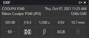

I've been using my P340 for bug and flower shots when out on walks lately. 2cm minimum focus distance @ 5.1mm, akin to the original 950. Flash sync at all speeds (to 1/2000) and built in VR.
(and -1.7 flash compensation)
