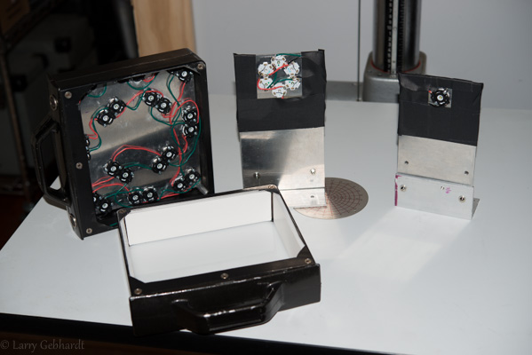

Yes, that's it. The pattern of the LEDs is important. Just putting them in a grid will result in a hot center. That's what I did for my first head, based off rmann's work in this (there was a url link here which no longer exists). It wasn't optimal and I needed make a mask above the diffusion screen. For the VC head I looked at http://www.huws.org.uk and then modeled the output pattern with gradients in Photoshop. I could then arrange the LEDs virtually in Photoshop. It came out very close to Huw's results. You can see the pattern I used for 5x7 in the array on the left (for white you would only need one of the LEDs where there's a pair in my head since it's VC). 20130712-202857.jpg
Rmann's thread above describes the wiring pretty well, and I can confirm that it worked very well. The biggest issue is the LED pattern.
