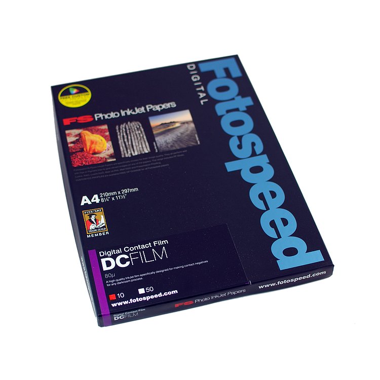

What do you think of this idea? Instead of making silver prints by projection from an enlarger, suppose I print a large negative from an inkjet from my digitized 35mm negative, and then contact print on silver paper? It would be one generation down, so, theoretically worse quality than projection, but on the other hand, a whole lot can be done in photoshop to fix that file up before printing.
Yes, you can do that. Quoting:
"FOTOSPEED Digital Contact Film A4
If you're in the unfortunate situation of having a great picture that you've only shot digitally, it's tough to make it into a negative so that you can print it on proper photo paper.
Not everyone has a Lambda or Lightjet printer in the garage, even though you can now buy them used for less than the price of the garage itself.
In this case, this Inkjet film comes to the rescue. It's an 80 micron thick PET film, which is coated on one side to accept ink from an inkjet printer. You can create a large-format negative from your digital files, then make a contact print from it in the darkroom.
Ideal for creating contact-negatives for alternative processes."
But you can order a lightjet of lambda light print on silver photopaper...
Many times they only print on RC paper, but some selected printers also print on FB with the Lambda printer.
Anyway, a genuine optic silver print, enlarged in the darkroom, with not digital manipulation may have an extra emotional (or economic) value, it is a hand crafted art object, you see the artist's hand in the craft. A sound optical print comes from a photographer mastering his tools.
High level Collectors usually buy only optical prints, but this is a difficult market, and YMMV.
