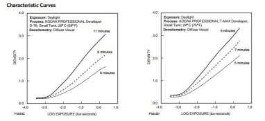

I'm new to B&W developing (35mm), and I'm trying to decide what my everyday film and developer will be. I have a lot of digital experience, and I do understand the fundamentals of film photography, exposure and processing. I'm digitizing with a Sony mirrorless camera.
I see that in Kodak's literature that Tmax 400's characteristic curve has essentially no shoulder. Tri-x has a bit of a shoulder. What does this mean for practical photography? I've read that Tmax has greater contrast in the highlights. What does that look like? Can anyone point me to an image that demonstrates high contrast in the highlights? And what would the converse look like, highlights using a film with a defined shoulder? Is that Tri-x's look? What other differences would you say there are between the two films?
So far, I've shot Tri-x, developed in Rodinal, Tmax 100 and 400 in HC-110. Tmax 100 is too grainless for my taste. I like some grain. Tmax 100 is almost like shooting digital. That's not the look I'm after. I'm not sure how much grain I like....I'm trying to figure that out now. I'm shooting with a Nikon FM2n, together with a medium 1 stop yellow filter. Yellow because I thought that would make my street portraits look a little nicer, more flattering skin tones for those subjects who care about skin tones (a year ago I would have written "for the ladies.") So, with the 1/4000 top shutter speed, together with the yellow filter, I can shoot at wider apertures in most all situations.
So I guess the biggest question is what are the real practical differences between Tri-x and Tmax 400, especially as it pertains to the characteristic curve, and also, what's the best method for exposure? I'm using the center-weighted meter of the Nikon, so there will be no precise spot meter measurements.

Before saying anything else, I have to say that characteristic curves depend not only on the film itself, but also the developer used, dilution, development time and agitation intervals. All these factors may affect curve shape. Now, one more detail about characteristic curve interpretation is that the contrast isn't constant across it. Drawing a tangent on any specific point will tell you about the contrast at this specific point (meaning exposure level). So, the more upswept the curve, the higher the contrast and vice versa. Having a shoulder means a reduced contrast at these exposure levels, so highlights are not as contrasty as the midtones before them. Is this a bad thing? Well, it is a matter of taste. A more pronounced shoulder can make highlights look "muddy", meaning that there's not much differentiation between light tones that are rather close in exposure levels, so detail doesn't "pop", there's no "sparkle", or brilliance. If you don't particularly care about it, then it's not a problem at all. In fact, it could make printing from such a negative a fair bit easier by compressing the highlights and preventing them from looking blown out (totally white). Now, if you want to have examples of shoulder, or lack of it, simply use the curve tool in any image processing software, it is IMHO the easiest way to get a good approximation of the effect. Just shoot a few photographs with your camera and experiment. While you are at it, try also the exact opposite of the shoulder, the upswept curve at the highlights.
Now, with all these said and done, since you have a hybrid workflow, much of it has not much value. It is just too easy to shape your curve as you please. If I were you, I'd be more interested in granularity and resolution, maybe even spectral sensitivity, but not that much in curve shape. And since you mentioned exposure, just make sure you give your negatives enough of it. It's much easier to get something out of thin negatives in digital post processing, but it will still look sub optimal.
Hope this helpes.

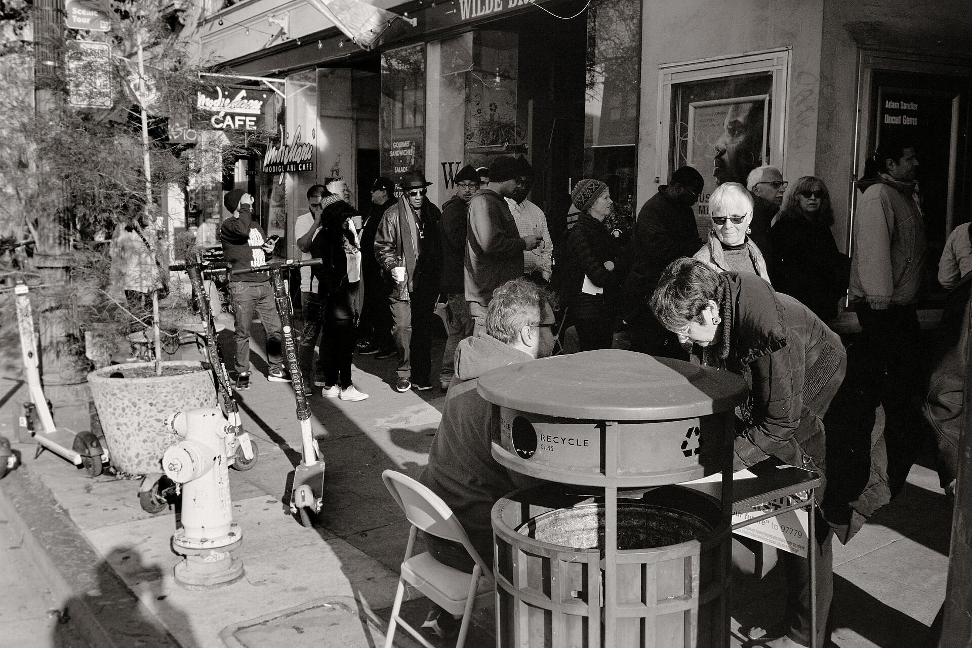

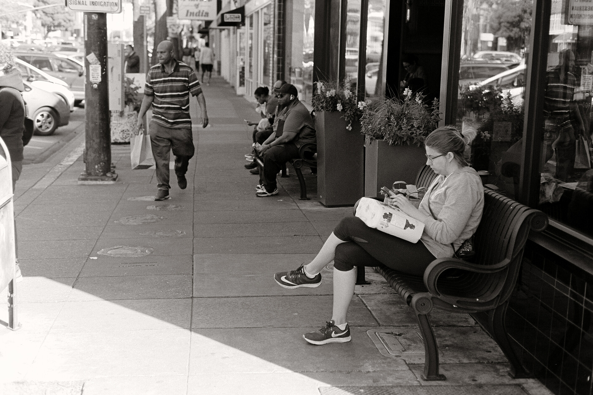

I found these two photos for you to take a look at. They're shot at the same time of the day, same light, on the same week, almost in the same location (my commute). Obviously this is not a test scene, but as close as I could find. Developed in the same developer "by the book", i.e. using datasheet numbers from Kodak.
Tri-X
T-Max 400
Sorry for the sepia tint, I was in the middle of a "phase" :smile:

Ah, ok, I understand your point that my digital workflow makes it almost a moot point, but why do you think Tmax is a better starting point? Also, regarding your images, can you describe the differences as you see them? Regarding pointing the camera down, I have done that too, but then what? You meter down and then decrease exposure two stops? Finally, suppose I wanted to start wet printing? How would you answer my OP? Thanks, I found your reply helpful.
TMax is not necessarily a better starting point, it's just often easier (fewer corrections) to start with a flatter image. Just a personal preference, nothing else. The images above, despite my best efforts to find something for you, are not easy to compare. The overall "look" seems identical to me. Looking at patterns across these two rolls, I think TMax preserves highlights a bit better, but that could be me just being less/more lazy with corrections. I did not spend much time per image, as these were junk/experimental rolls anyway, I moved on to Ilford films fairly quickly.
Regarding exposure, no - I just exposed for the shadows. Both shots were overexposed in the highlights on purpose. I do not wet print, that's the next level! :smile:
Tri-X 400's characteristic shoulder can make highlights in images made under contrastier conditions harder to burn in/ print with good separation (because the film curve is compressing them). You can try to straighten out the curve by overexposure & reduced processing time - but that will affect your midtone gradient. What T-Max 400 attempts to do is keep highlight linearity so when you burn/ fog/ mask etc those highlights in, they'll still have excellent separation without having to cut process time with its attendant midtone gradient consequences. On the other hand Tri-X's 'look' is a result of its curve, sharpness behaviour, visible granularity etc - and those are all visually significantly different from T-Max 400. This applies both in scanning and optical darkroom printing. In fact I would go so far as to say that if you aren't seeing those differences between the two films in a scan, there is something wrong with your scanning process. Attempts at correction in post-production of Tri-X's shoulder often look odd, no matter if in the darkroom or on the computer - but you may be able to dig a little more out of the extremes of toe & shoulder by way of the linearity of digital sensors (paper has a toe & shoulder that interacts with the film's shoulder and toe respectively).
Easy way to get a starting point for controllable results: set your meter to half box speed, knock maybe 20% (adjust up/down in 5% increments) off the recommended time for processing for box speed, iterate from there.
If you are to scan then this is mostly irrelevant, as you bend the curve like you want. If you are to print in the darkroom then extreme highlights in TMY reach higher densities that can be more difficult to print.
In both cases a compensating development may lower densities in the highlights, relatively to the the mids.
It happens that the highlights tend to clip to white in the print, a bit like in digital, but information is there and texture can be pulled like if it was TX. In the Hybrid case you simply bend the curve, in the darkroom there are several techniques for it.
Main difference is grain, TMY has little grain, TX has a particular grain structure, it delivers much more grain in the shadows than in the mids and highlights which helps a dramatic rendition. For example you see dark clouds in a storm with a lot of grain.
Regarding sensitometry (the curve) you control what you do with exposure, development and post-processing. And regarding spectral sensitivity what counts is how you filter.
TX is long toe, so -2 to -3 underexposed areas are more compressed, with TX you may want to expose a bit more to ensure detail in the shadows.

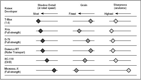

If so, can you recommend a developer that has little or no solvent action and give full film speed?
First, you can use a solvent developer more diluted to decrease the solvent effect.
T-Max developer is an "speed gain" developer and it delivers a powerful and nice grain.
Another one is BERGGER BERSPEED, like T-Max Developer it is also a high-energy developer.
Microphen is also an speed booster developer, in theory it retains a relatively a fine grain for the speed increase, but what it has is a good speed vs fine grain balance, more speed tends to more grain.
With TMY if you may want to make grain evident, you may use a high energy developer. For TX instead you may want to make grain finer, ar least in some situations, in that case Xtol is a powerful tool.
Let me suggest the excellent book Film Development Cookbook (2nd Ed), but first read The Darkroom Cookbook (3rd Ed. or so). You will get a lot of fun while learning solid concepts.
I'm going to try Rodinal tonight to see how that looks. Is it true that Rodinal and HC-110 don't deliver full film speed?
Read here about HC-110: http://www.covingtoninnovations.com/hc110/
Both Rodinal and HC-110 are considered low fog developers, and this has some cost in speed terms. You may loss some 1/3 stop or 1/2 stop, depending on film and on your reference.
Also speed boosting developers deliver a moderate speed increase, that usually do not surpasse 1 stop, 1/2 stop can be easy to obtain.

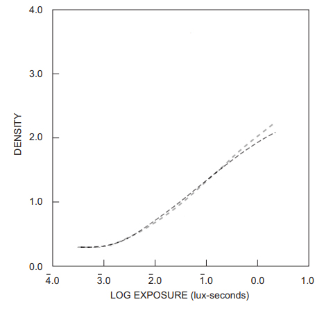

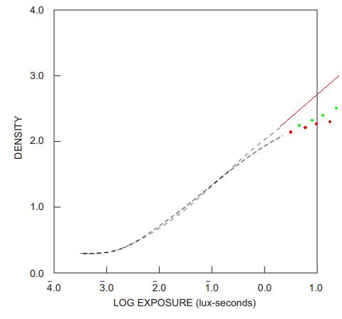

You sound like you're reciting someone else's comments on T-Max here without any experience based knowledge. 400TMY-II really does not have runaway highlight contrast at all if you follow the most basic means of process control
Guy, with ISO Normal development TMY is totally linear in the highlights, even at +6 overexposure, and this delivers difficult to print strong highlights as soon you want to ensure exposure for the relatively deep shadows.
Of course with any film you can control process to make highlights printable, but this is more difficult with a linear film.
TMY density skyrockets naturally, isn't it?
(Each H unit in the Hor axis is 3+1/3 stops)

An Image from Sherman, after strong compensation (Manhattan Skyine at night):
https://www.powerofprocesstips.com/nyc-northeast/

Nope. TX_TMYII.jpg TMY-II superimposed over 400TX in D-76. Both at manufacturers' times for 0.6ish CI. Scales corrected to match. The differences are pretty obvious as are the near identical toe characteristics

Why do you cut the Graph at 2.0D man ? The shoulder shows beyond that. I paint two hypotetic shoulders compared to linear behaviour:
