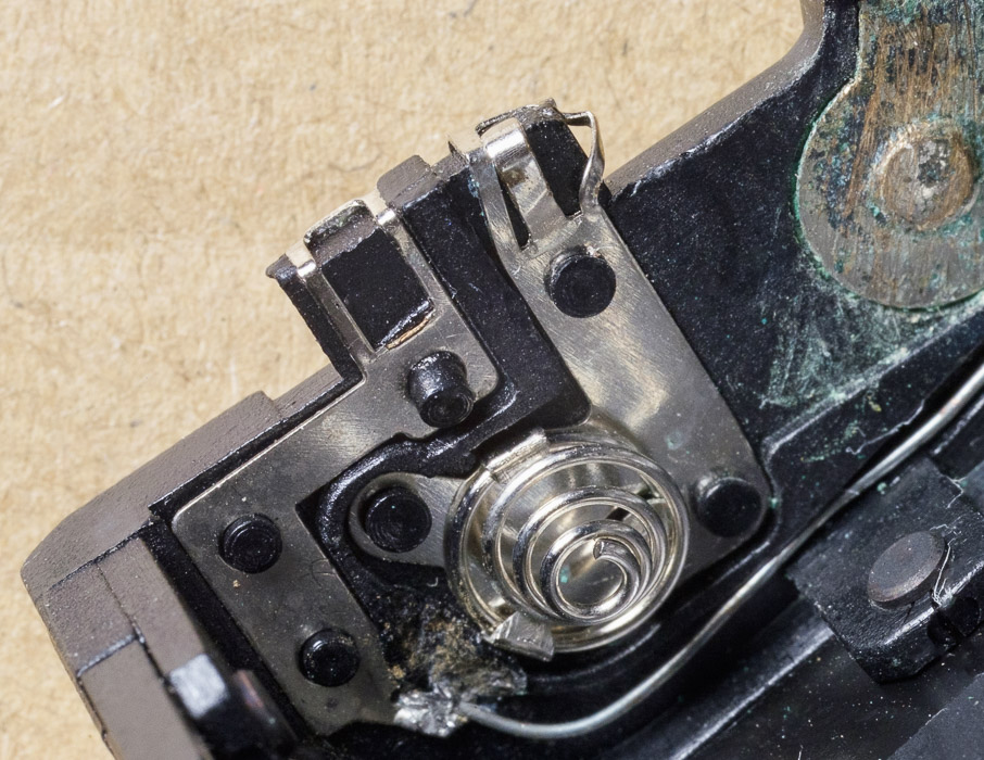

I agree, corrosion from leaky alkaline batteries is not Konica's fault. But corrosion is not the only problem. The electrical contacts within the battery compartment are delicate, and easily damaged. Here is a closeup of the battery compartment from a FT-1 I bought on eBay. I shopped for a Konica FT-1 camera for quite a while, and I noticed more than a few of them do not have a functional battery compartment.
