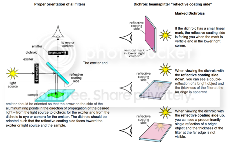

On the web I didn't find so many informations. The only document which allowed me to do some practical test and some progress is the following:

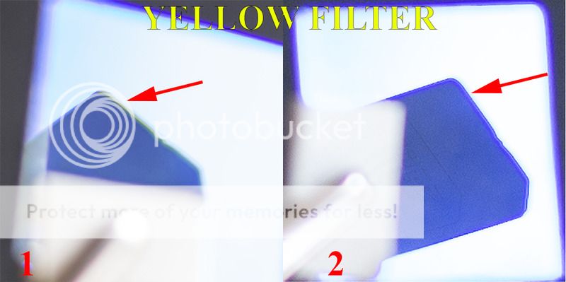

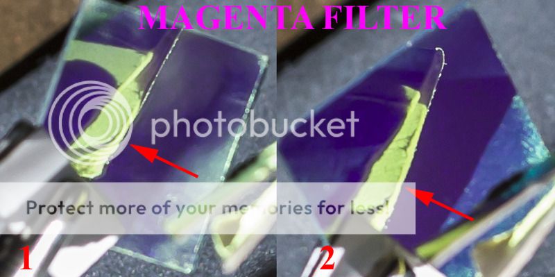

So, assuming that the presence of a double reflection of a source, on the surface of the filter, indicates that it is the rear of the reflective coating side, I made some experiments getting the following results (I apologize for the poor quality of the photographs):
The Magenta filter and the Cyano filter both show to have a similar and clear behaviour so I decided to post just the test for the Magenta.

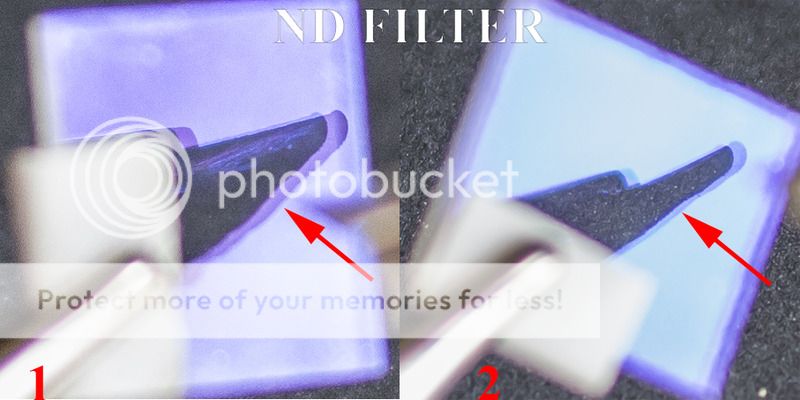

As you can notice, in the cases of the Yellow filter and the ND filter, we get a double reflection on both the sides. Regarding the Yellow filter it is not so clear but if you have a look at the picture n.2 you will notice an inner Blue reflection. On the picture n.1 you will find an outer Yellow reflection.
If we adopt the double reflection as parameter to identify the reflective coating side we can easily find the answer for the Magenta and for the Cyano but not for the Yellow and the ND. It is possible that those latter filters are not dichroic filters? Does it make sense?
My simply question is: how may I determine, without doubts, the side which has to be oriented to the light source of the enlarger head?

It does not matter.
The instructions above relate to a case where the dichroic filter is part of the imaging optics. In such case you have the old mirror issue of double reflection.
For lighting optics the orientation does not matter. In case of doubt just mount it in a deliberate direction, meter the colour density with your enlarging colour-meter, then reverse the filter and meter again. In case there should be a difference post it here.

In relation to the ND filter, as you can see, it reflected a soft violet/pink dominant. Is it normal?

As regards the reflections, it is perfectly normal that you see a coloured edge if you hold the filter with the dichroic side towards the reflected object, and not if you hold it with the "plain glass" side towards it: it is the very principle of a dichroic filter to reflect all the wavelengths it doesn't let pass, so the treated side of, let's say the yellow filter will give a blue reflection (complementary of yellow), while the reflection coming from the other side downstreams will be yellow because it is only reflecting the wavelenghts that the treatment lets pass. This effect is shown on all your images. In the applications that use semi-transparent reflection filters, the other side of the filter is coated to prevent these reflections from happening - but of course your filters are made to be used in transmission, not reflection, so the other side does not need an anti-reflection treatment. In summary, you don't need to worry about it, it is perfectly normal.
As regards your images of reflected light, I can only say that any difference would be caused by this phenomenon. But then I don't see any difference, which makes perfect sense since an untreated glass surface reflects only a few percents of the incoming light whereas the dichroic side reflects 100% of all the wavelenghts that it doesn't let pass: that's a huge difference, so the effect on the colour is minimal. I can't tell the colour of the reflection on the ND filter from your photos, but it is perfectly normal for a filter to yield coloured reflections, if it has received any kind of treatment, and it has no influence on the colour of the transmitted light - the front lens of your camera, or its multicoated protective filter, are other examples.

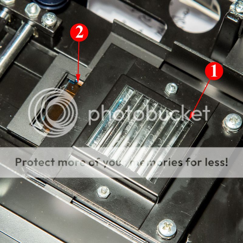

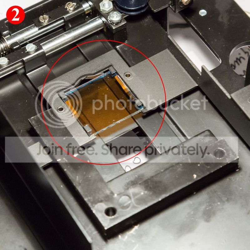

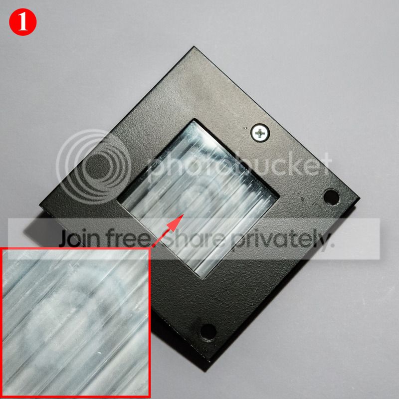

thank you all for the interesting contributions. Regarding my Durst CLS 500, just in front of the bulb, before the ND filter and the three dichroic filters (Y/M/C), there are two other filters.
It follows a photograph of the two filters (the bulb is placed in front of the filter N.1):
N.2 should be the UV filter which you were talking about.
Filter N.1 is composed by 2 elements: a unit of 9 small glass columns which are right in front of the bulb and, on the other side, a square glass plate (the side showed above is opposite to the bulb).
In my case, you can easily recognize some circular halos which are on both the sides of the plate (have a look at the spot on the left of the last photograph). In particular, I tried to touch the central one and it is very rough. Any suggestion?
Is it possible to clean it or, maybe, would it be better to replace the plate? I guess it is not so easy to find a proper replacement. Is there any schematic/manual of the Durst CLS500 (or 501) on Internet? It would be extremely useful for the identification of all the parts in the disassembling/assembling phase and in order to find replacements if necessary.

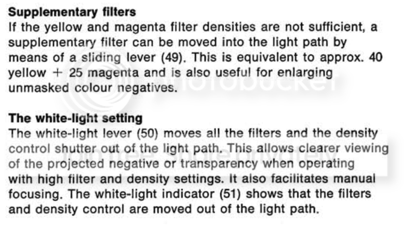

in relation to the previous post, I would like to clarify the function of filter n.2. In accordance with the manual of my Durst Laborator 1200, on the section related to the head, there is a mention about the command (49) which is supposed to be used to activate/deactivate that filter. Even though the head is a Durst CLS 501, it is different from mine, the function should be the same.
Have a look at the following photograph which is an extract from the mentioned manual:
The relative description:
It seems to be quite clear. What do you think about?
Any suggestion for the cleaning of filter n.1 would be warmly appreciated.

That filter is called here "mask substitute filter".
Thank you so much AgX! Do you know what kind of filter is it? I mean in constructive/behaviour terms.
All the best.
D.
All the best.
D.
From the look of it, it appears that it is a filter to add (yellow) masking to non-masked color negative films. So they print correctly.
I'm just guessing!! -- and that's what the Durst manual above say.
