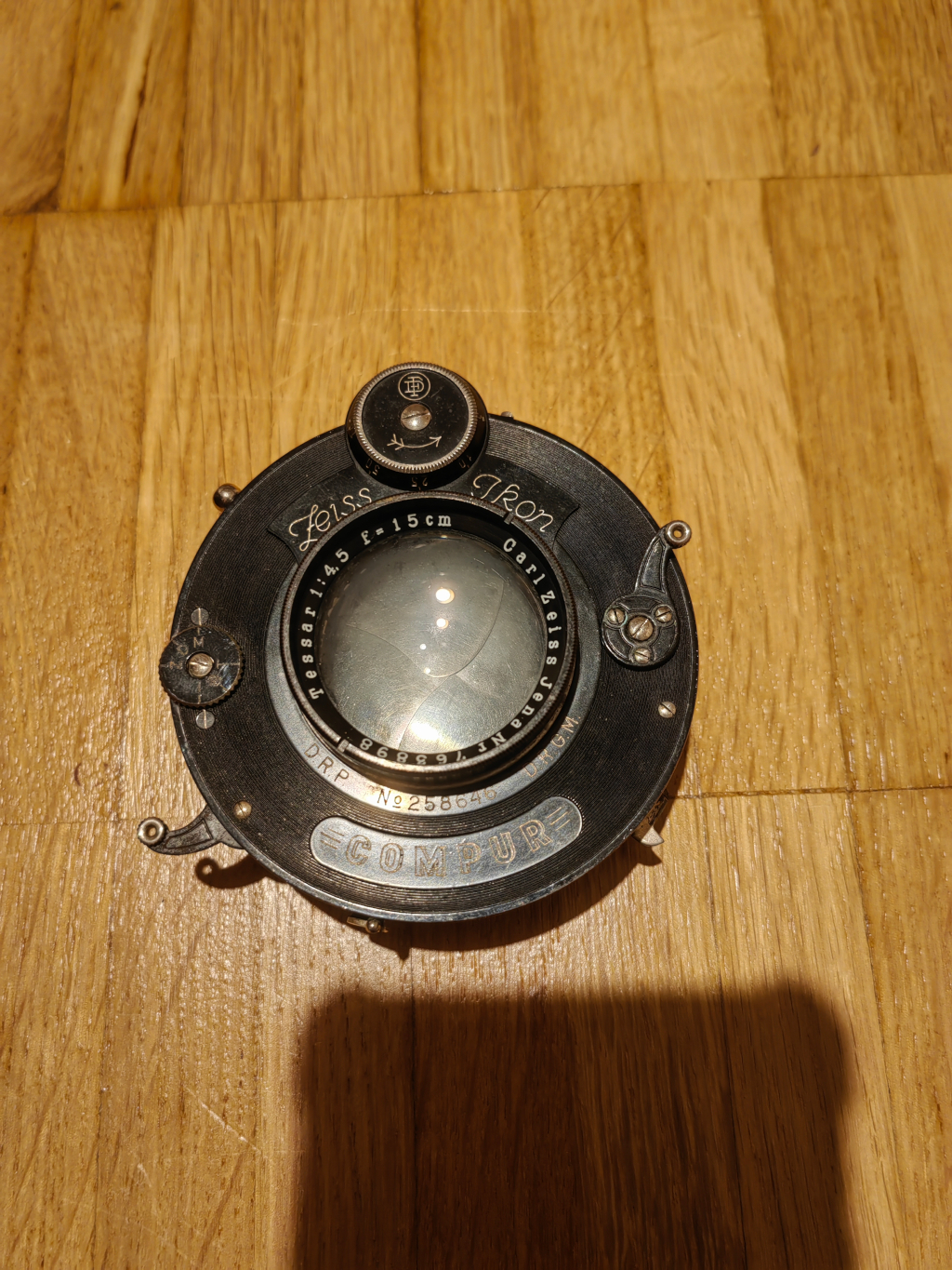

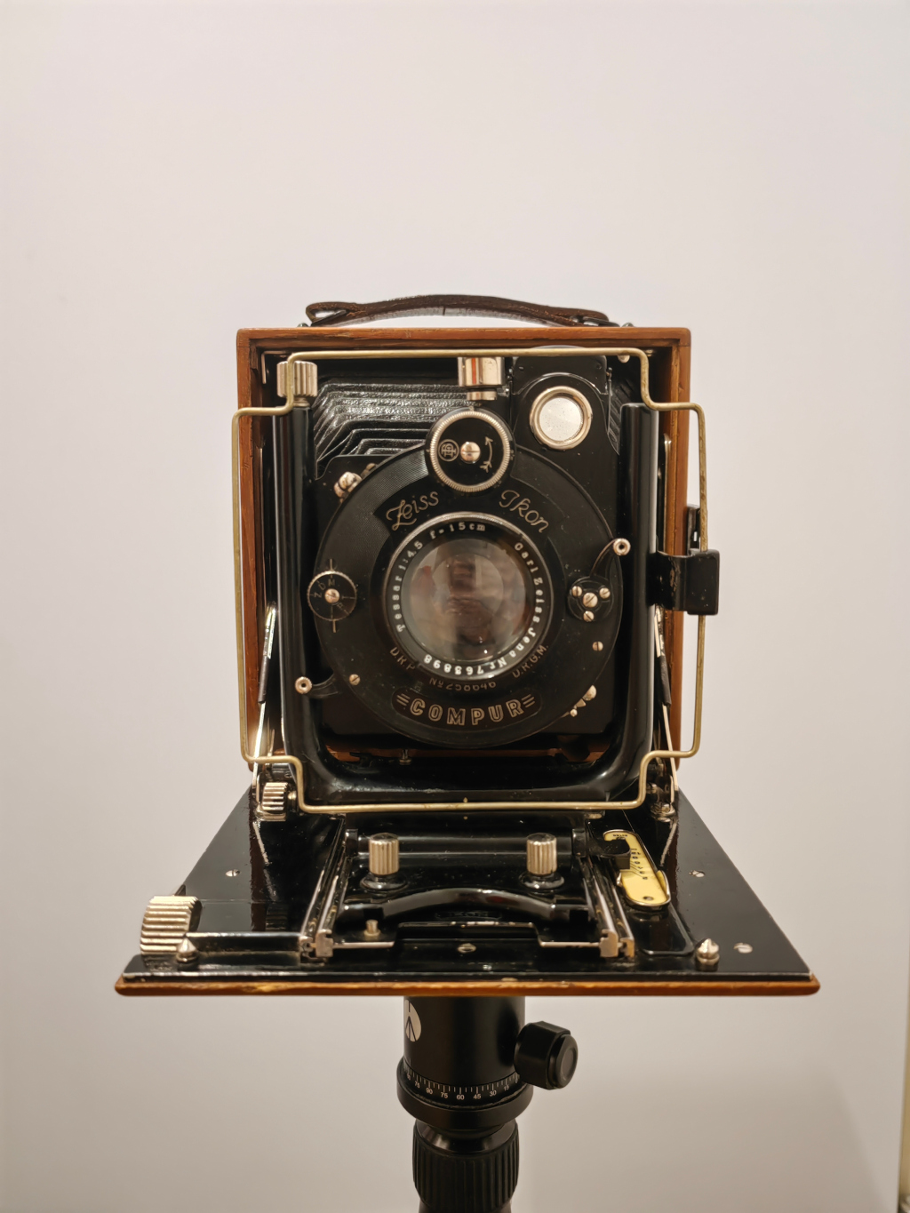

Hi Friends,
I was lucky enough to buy a mint Zeiss Ikon 266/1, the camera looks wonderful, unfortunately the shutter only fires at one speed, is there a shutter pro here who can help?
Thank you 🙏

If you want to look inside the shutter yourself, there is some information at
I got this information on the forum on plate cameras, and I've looked inside the shutters of two cameras and managed to get them working.

Although I'm a relatively nervous person, with the help of the information from your post, I dared to open the shutter and use some lighter fluid to free the clockwork so that it can run again. I managed to repair the shutter and now all the speeds are running correctly +-

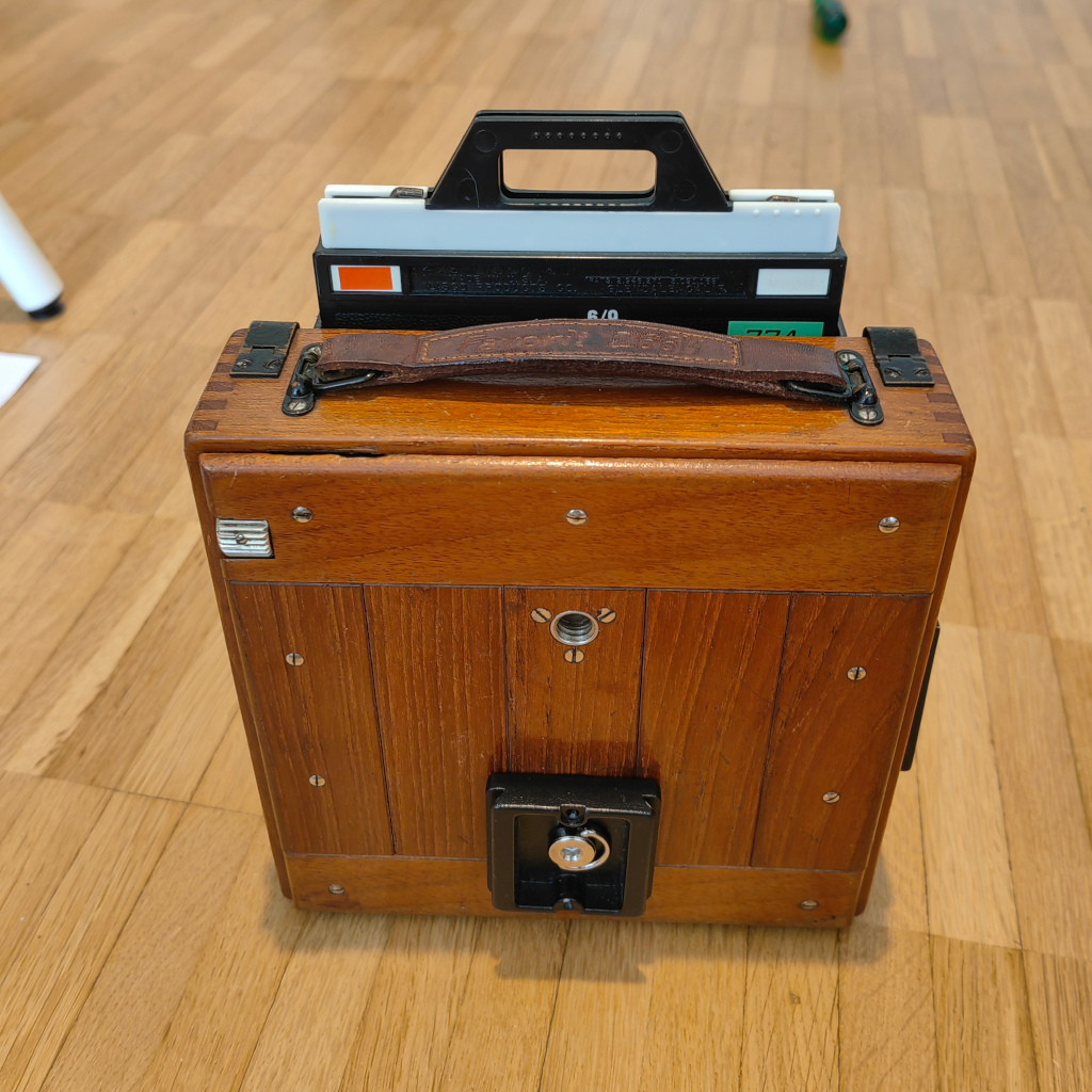

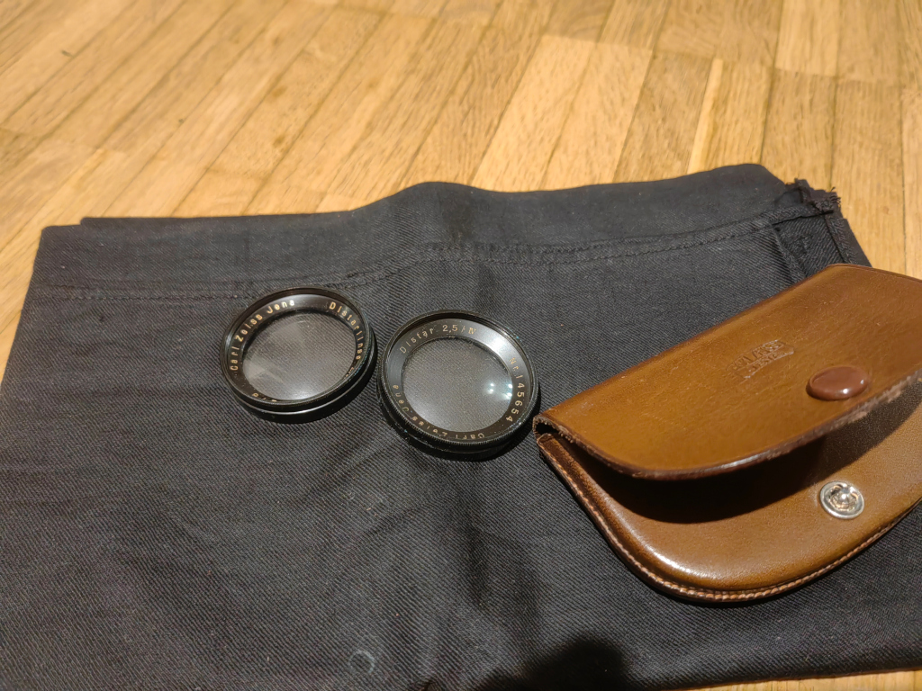

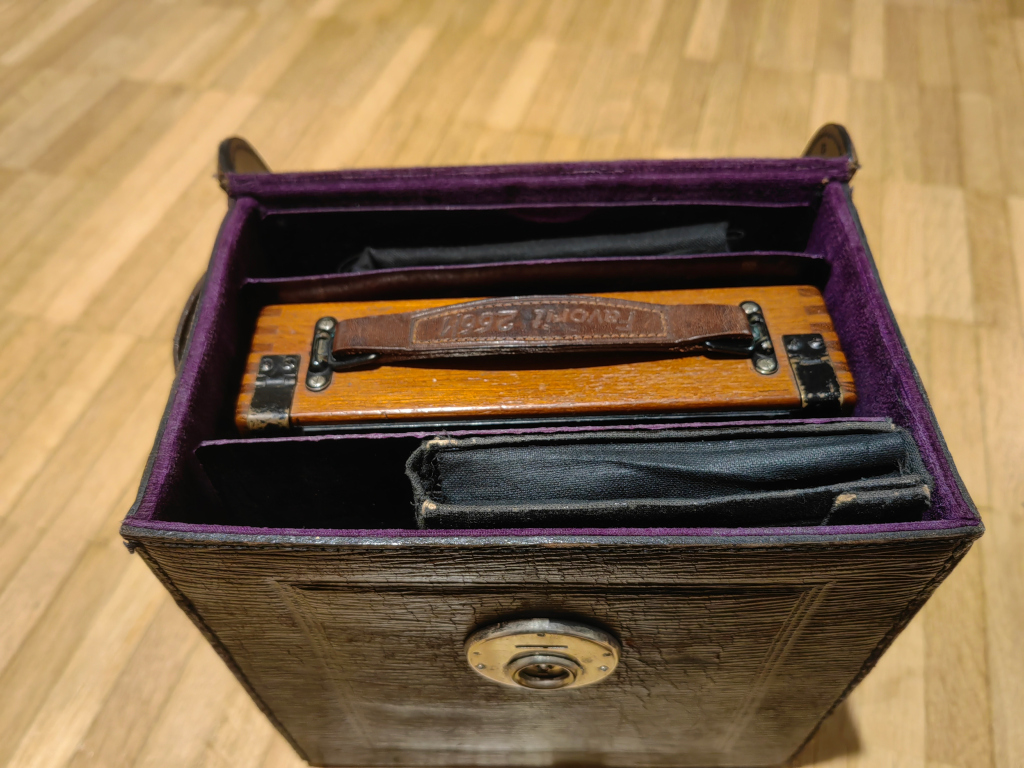

the camera comes with 3 holders 9x12 and with two kind of slip on filters/lenses darkcloth case for holder case for camera... complete, i am planing to use it

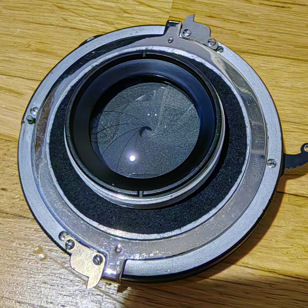

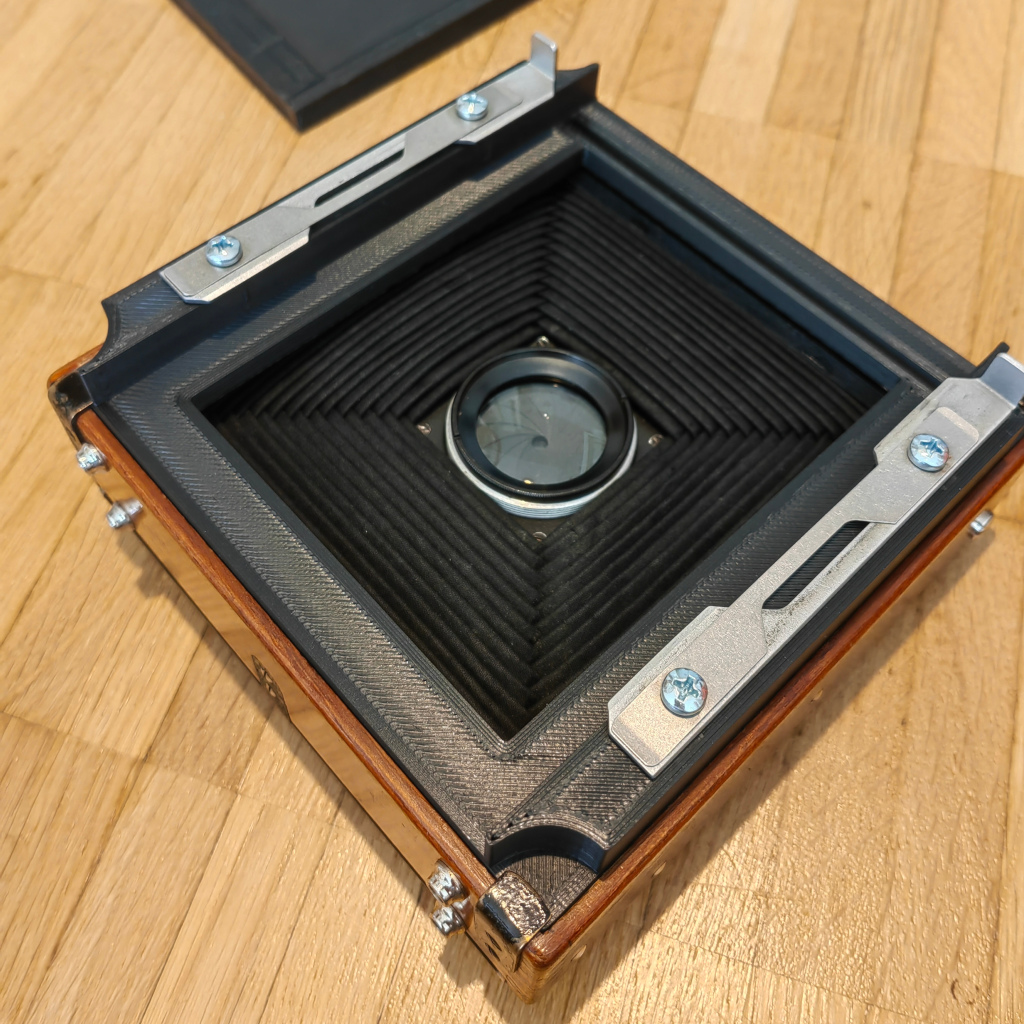

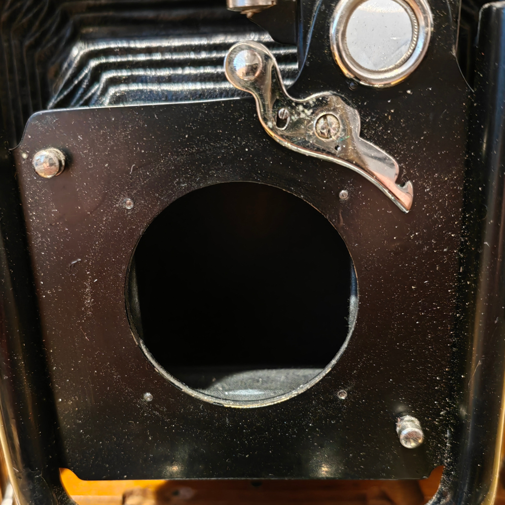

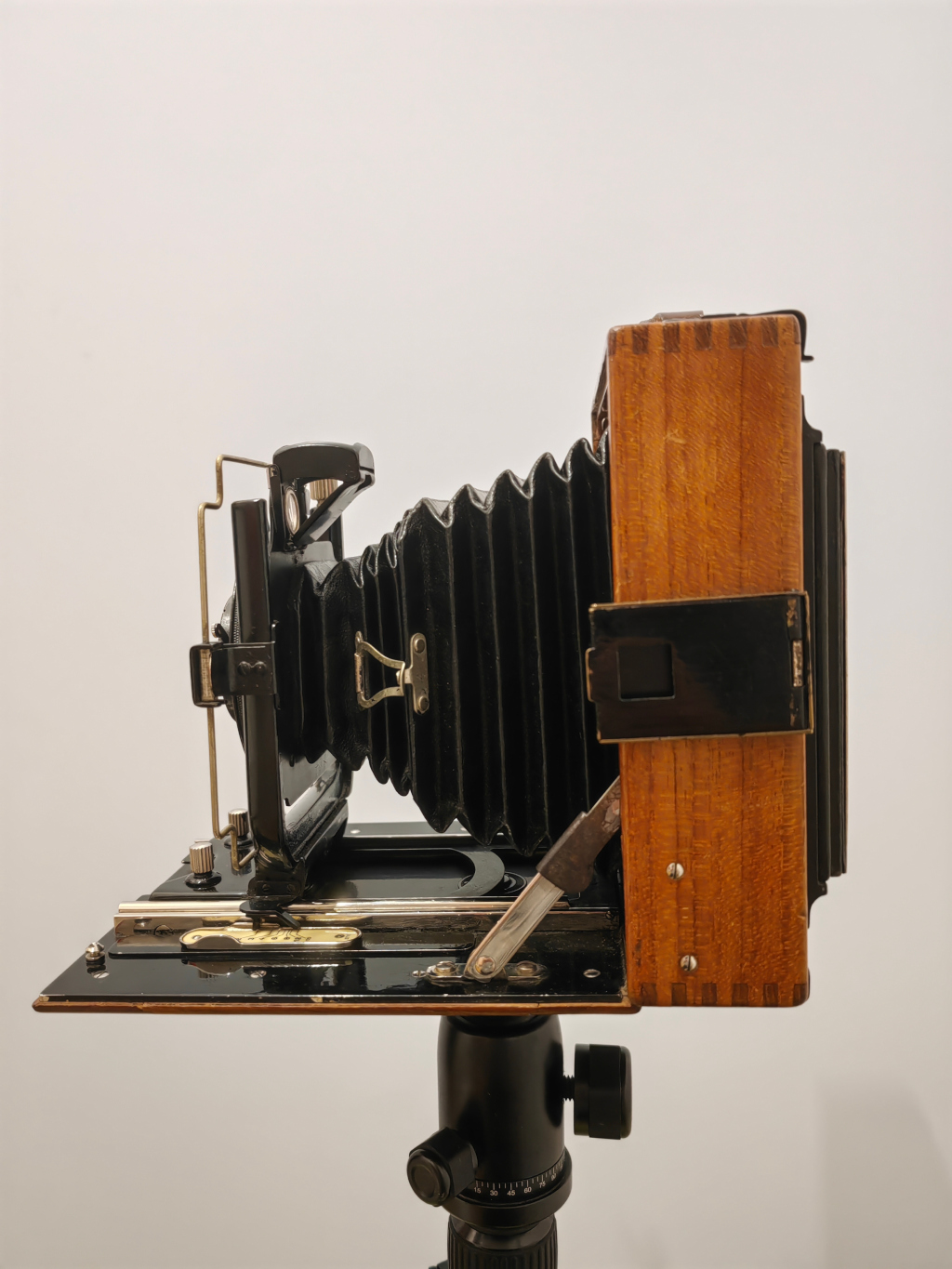

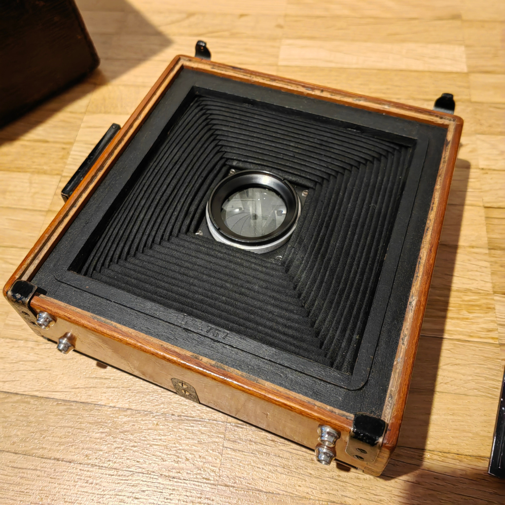

Some more Images from this Beauty

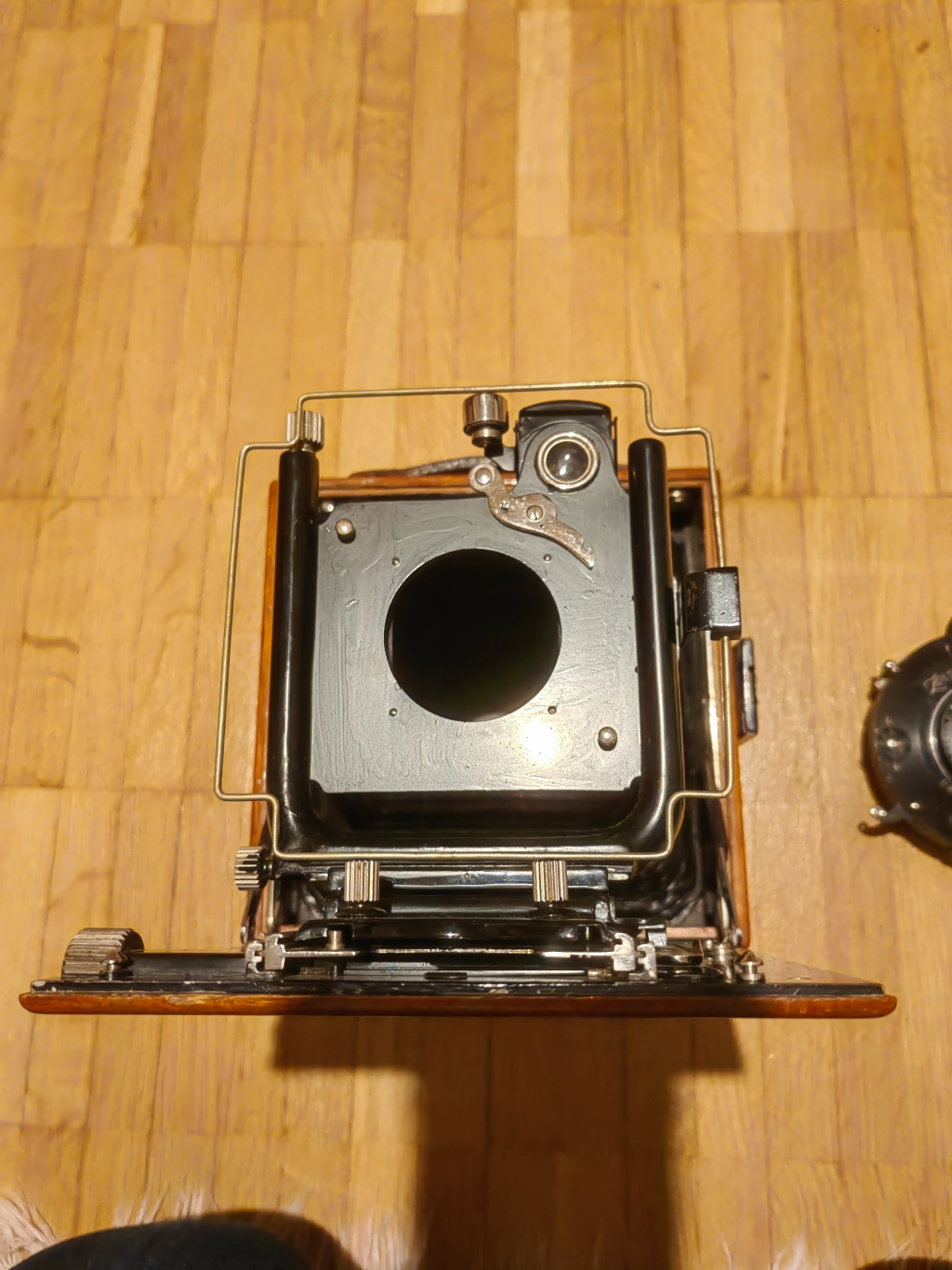

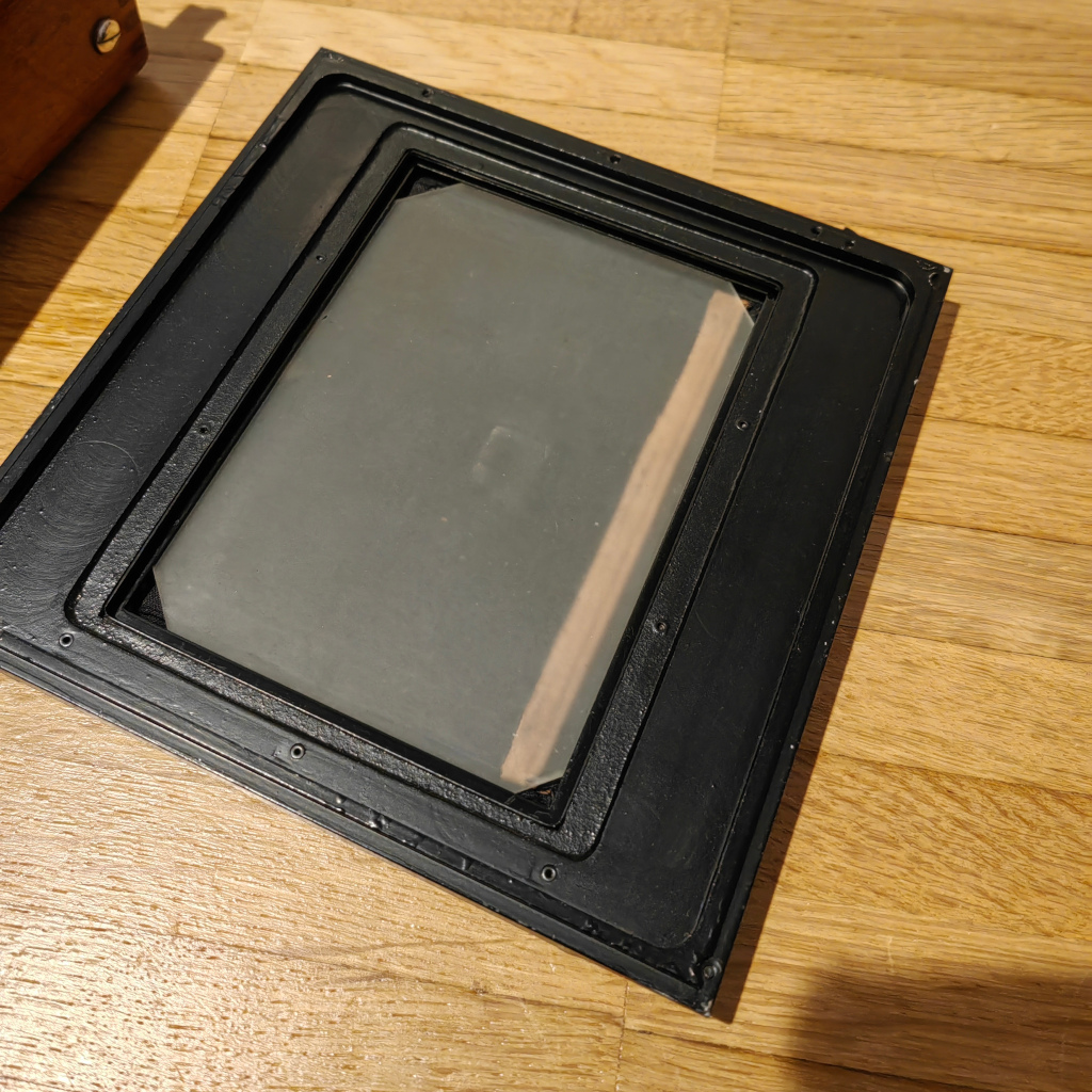

Could you please post an image of the back of the shutter/lens assembly? I am trying to understand how it is held in place. I see the latch but it does not feel substantial enough to hold the shutter in the lens board.
And to complete the picture, a shot of the camera back with the focusing screen would be very handy.
DraganB
Sep 23, 2023
96
Switzerland
Good point. It should also be possible to use a more modern shutter-lens combination on this camera with a proper adapter (I had one made for my Certo Super Sports Dolly).
Here the Images, its holding very good no problems, good system.

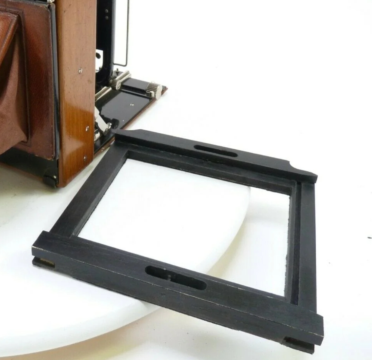

Almost looks like someone could make another back for that camera that takes modern 4x5 or 9x12 film holders.

I have a 9x12 camera from my grandfather that I recently refurbished. Not quite as nice as your Zeiss...
I use film with glass plate holders. Just have a glass plate in place, and slip the film between the glass plate and the metal that holds the front of the plate. Sure, you need one glass plate.

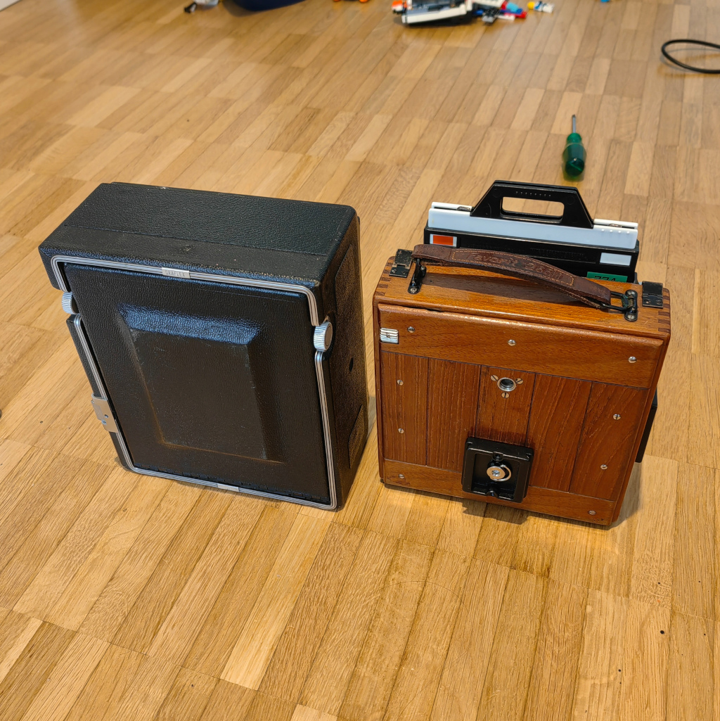

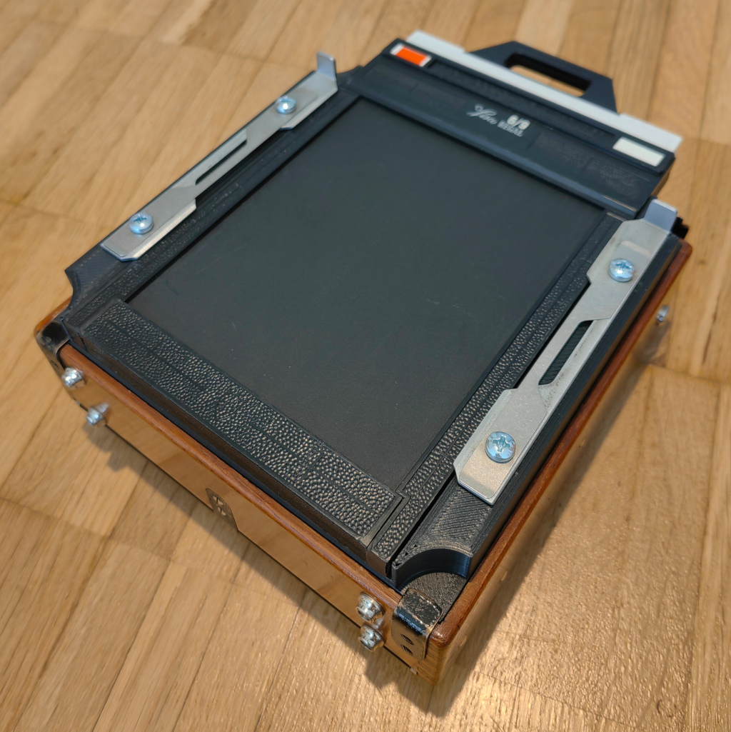

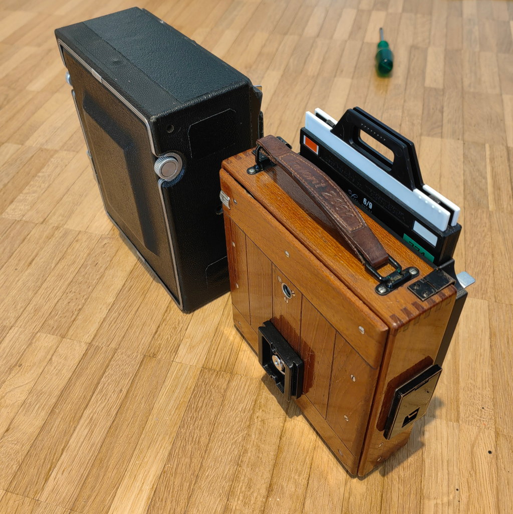

Finished :cool:
Its a nice litte 4x5 now.
Left the Graflex Crown Graphic 4x5 with the Rangefinder removed.
