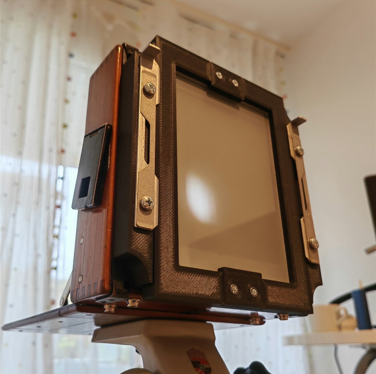

I used this with some modifications to make adapters for two plate cameras, a Bergheil and what I think is an ICA. The 9x12 and 4x5 modern film holders are the same size so I use them with 4x5 film. Maybe you've already seen this.

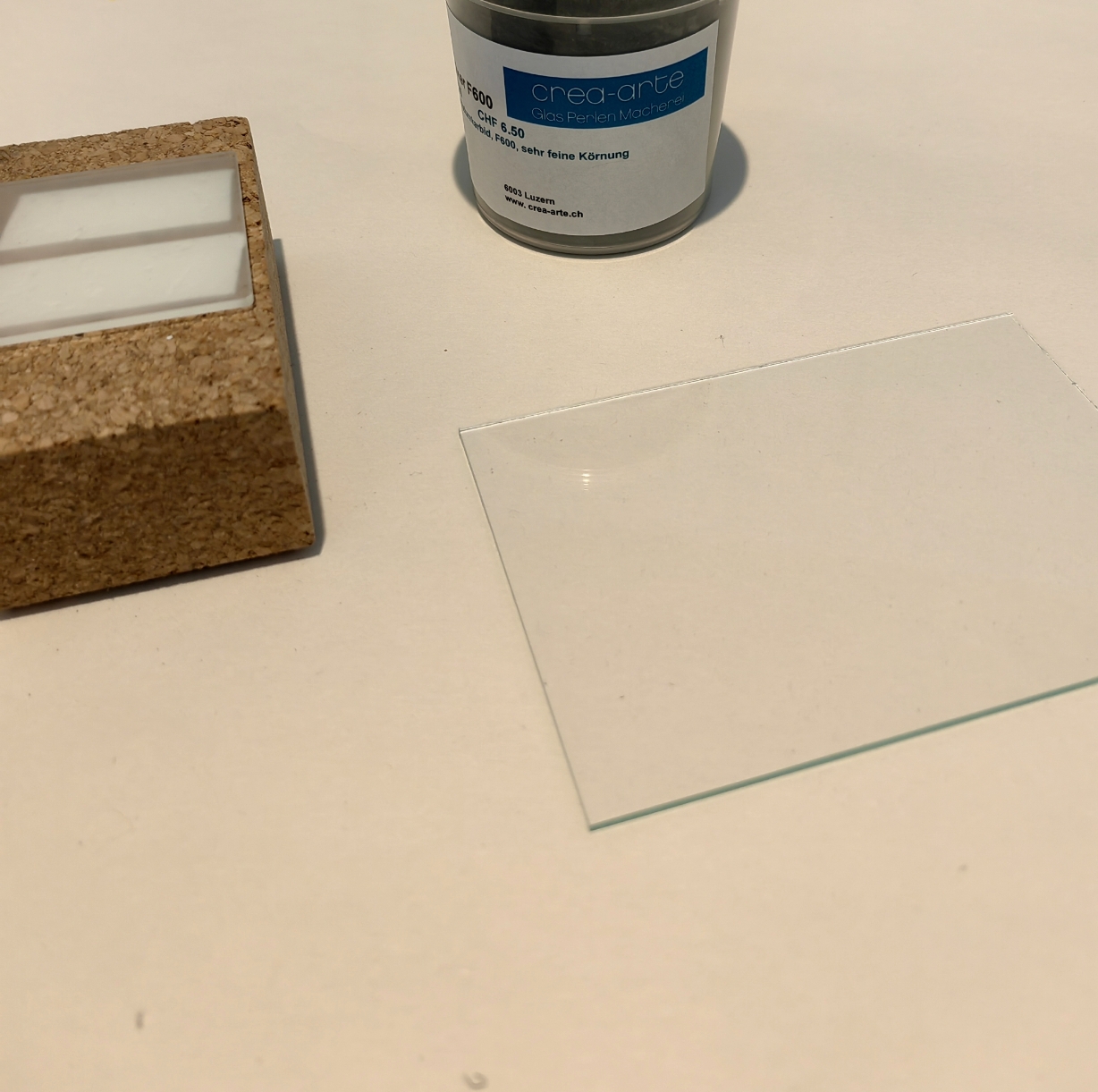

Finally found time to print the Groundglas Holder and make the Groundglas. Tomorrow first test.

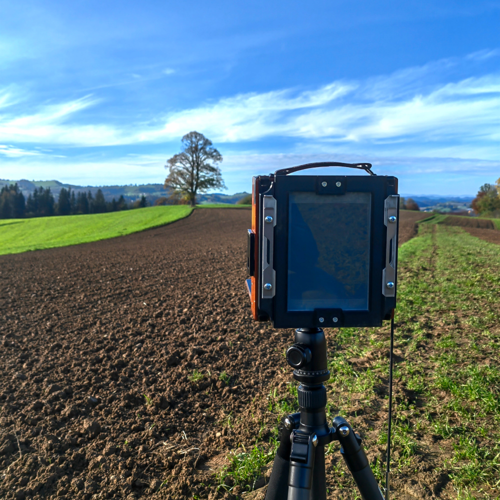

So this is the first image, it's fine, the sharpness isn't really good at higher magnification. I need to check the lens elements and try another film like fp4+ or pan 50.
The shooting experience was very cool.

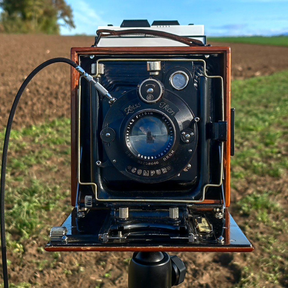

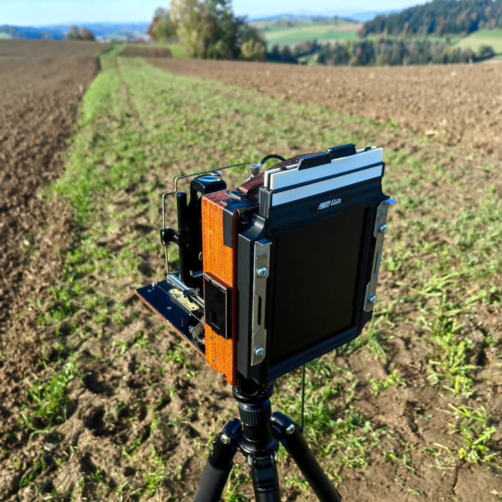

This is a great looking camera! I was afraid that the new back would dissonate with the rest of the camera but it doesn't.
I'm now looking at Gundlach Pictorial View Cameras that were produced in a 3.25 x 4.25 in format. They are less expensive than larger (4x5 and 8x10) models but have the same back design as your camera.
you could also make a 4x5 back for that camera, maybe the opening is big enough to cover 100%

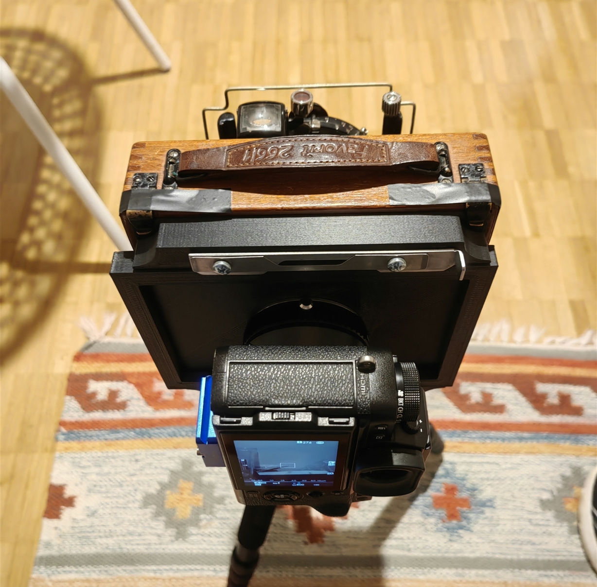

I built a digital camera adapter to test how sharp the lens is.
here is the result:
remember this is a portion of 23.5×15.6 mm from the 4x5 image!
I did not sharpen the image only resizing to 1000px.
f4.5, f5.6, f8
@ f/4.5:
@f/5.6:
@f/8
