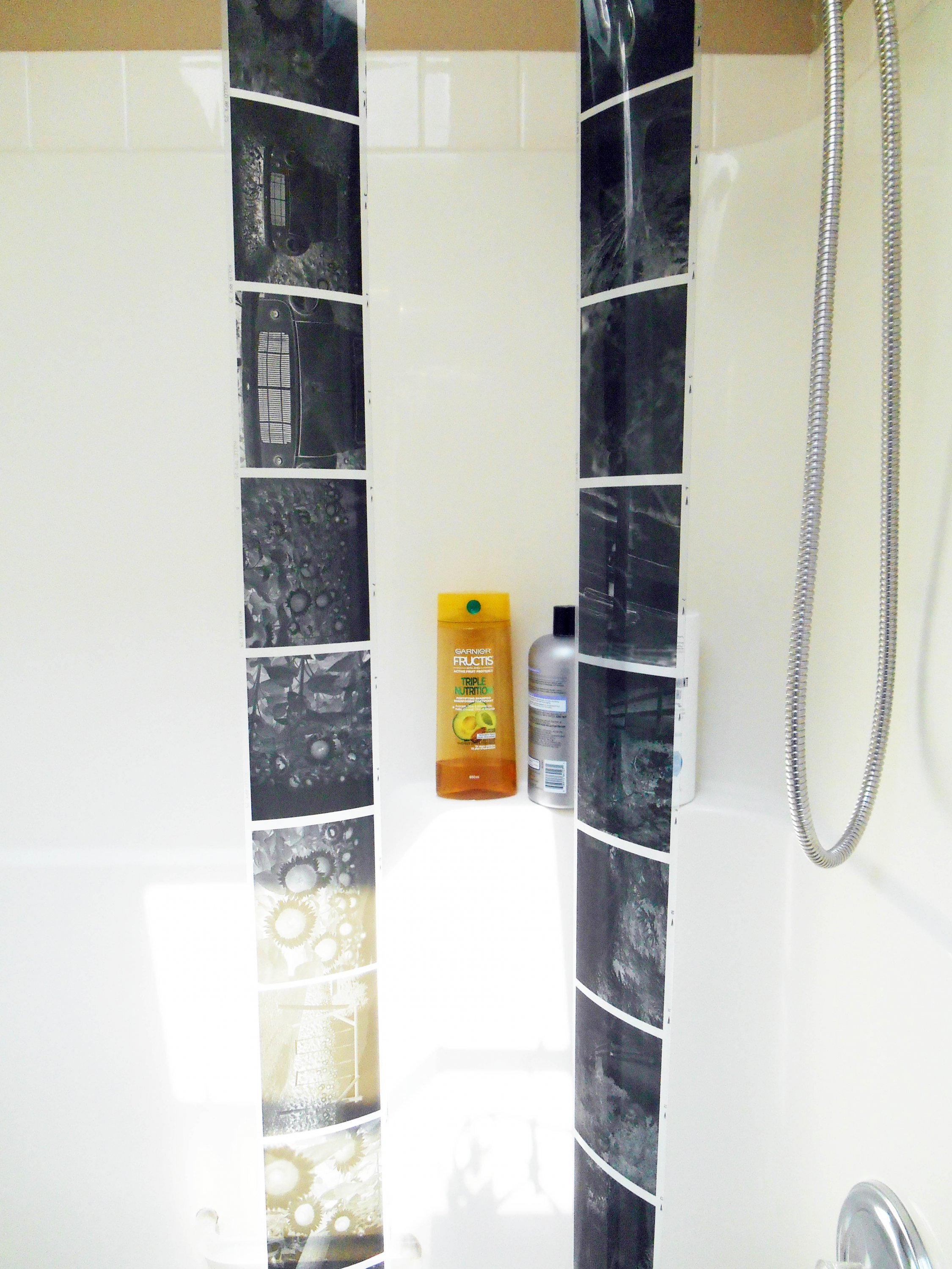

I just (a couple days ago) processed a roll of Finesse 400 in D76 at 4:30. The ambient temps were 82F! Looks ok, but it was a test roll to check for light leaks, nothing critical. Here's a scan from that roll, cropped to 5x7:
Edit: I should mention that I found a time/temp table online, on which I based my time. I'm surprised it turned out as well as it did, considering 5 minutes is the minimum recommended time.

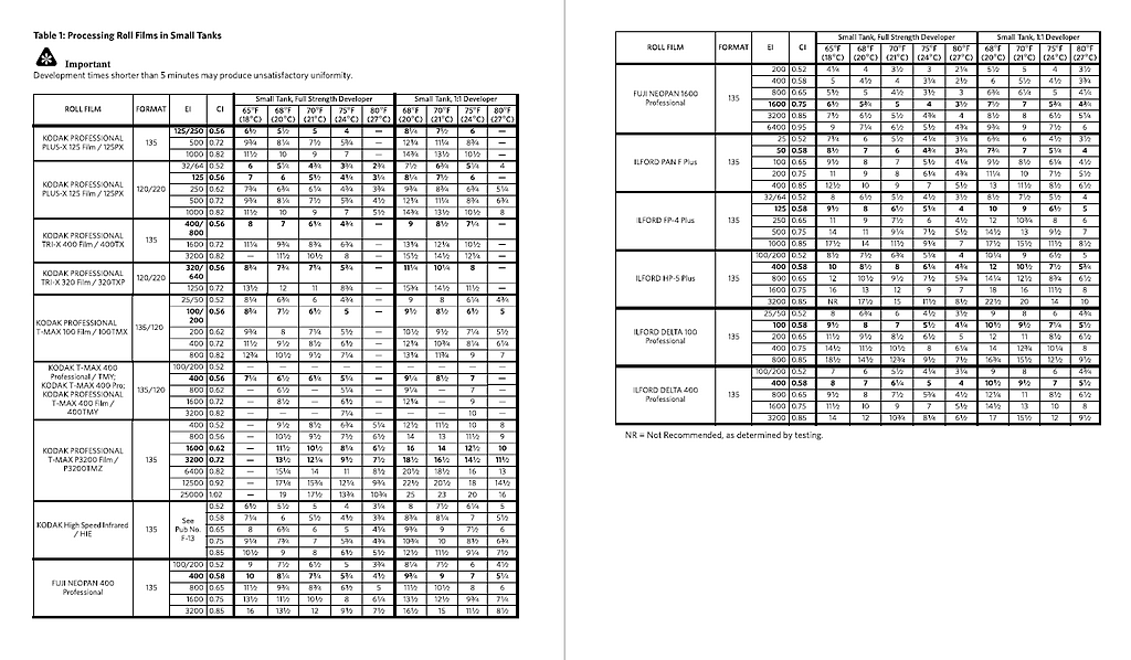

Kodak made the developing computer in the dataguide instead - plus the table in the applicable data sheet.
For example, X-Tol in small tanks (J-109):

The chart from the dataguide (in this case the 1980 version) isn't what you need, it is the development dial itself. The development numbers are easily determined by just reverse engineering one data point from the data sheets from Kodak Alaris/now Sino Promise for the developer.
The chart I posted was from the 2018 version of the X-Tol data sheet.
Here is the current link on the Sino Promise hosted Kodak Professional Imaging Solutions website:
https://kodak.sinopromise.com/uploads/files/chemistry/J-109_Feb_2018.pdf
