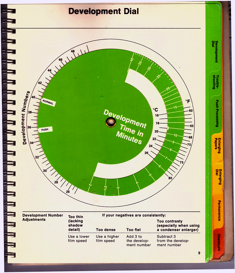

My starting point is to use the development dial in a Kodak Darkroom Dataguide.
I've seen some recent observations that, at least with the older dials (which relate to older films), it may be necessary to add a bit more time (10%) as you get higher than 24 C.
As long as development times stay longer than 5 minutes, there usually isn't any problem working around 25 C.

My 1970 Dataguide says that if 10 minutes works well at 68F, you should use 7' 15" at 75F.
The 1980 Dataguide says that if 10 minutes works well at 68F, you also should use 7' 15" at 75F.
I've reference degrees F because it is easier to read them on the 1970 dial. By 1980, degrees F and degrees C are equally easy to read.

The Dataguide dial would recommend 4:45 - so close to the same.

Those good old Darkroom Dataguides are like gold. Kodak, Ilford, Adox if you're listening here's a neat idea for an updated little cardstock computer I would pay 10 bucks for a nice one.

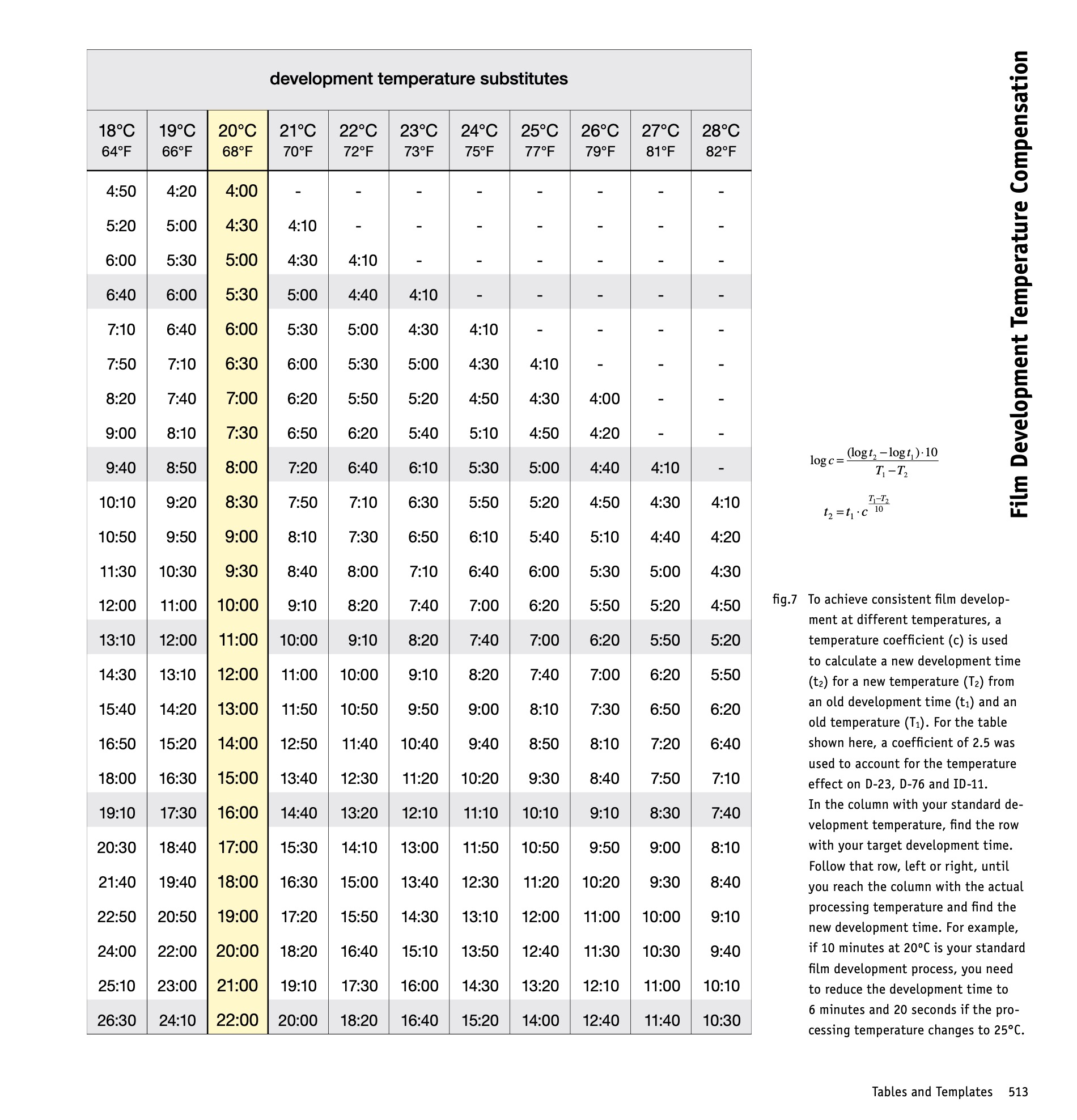

By the way, 4% corresponds to Ralph's temperature coefficient of 2.5.

I use the Ilford Time/Temp Compensation Chart easily found online.

I have the same film computer as Matt, the only current films listed are Tri-X and TXP. Developer choice is D-76. If you want to process Ektapan, Super XX, Royal Pan, or Panatomic X in Microdol-X or Polydol you'll be all set.
Just use the dial to reverse engineer a development number for current films by locating the manufacturer's recommended 20C/68F developing time.
Even better, if you have your own favourite 20C/68F developing time, use it for the reverse engineering.
I add my own custom development numbers to the list of films using a sticky note.
