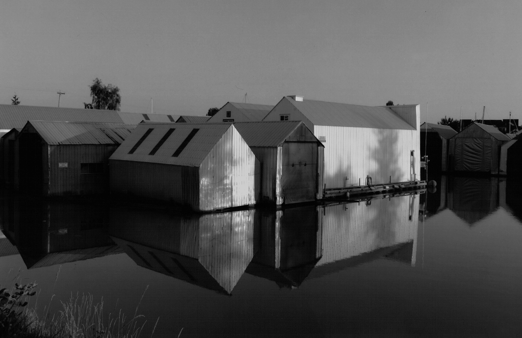

So your saying maximum black is black with some detail like the second image? And the last image wouldn't be maximum black? To me I'm still thinking maximum black is the bottom picture because it's more Black.
Both examples have some maximum black in them. The darkest parts of the second example are the same black as the darkest parts of the last example - they are both "maximum black".
But the goal is to achieve "maximum black" with the minimum possible exposure, so that only the darkest parts of the image are "maximum black". The last example has too much exposure, so parts of it that shouldn't be printed "maximum black" end up being that dark.

Let's see if an illustration might help. These are digital facsimiles of prints, but the middle one is very close to how the print looks on my wall.
First, this is how a print looks when you haven't given it enough exposure to for the print to have any fully black part to it - "maximum black" hasn't been achieved. Note that the darkest parts are more grey than black: View attachment 346120
The next example is a print where I have given the print enough exposure for the blacks to achieve "maximum black", without giving it too much exposure. Note how there is a wide range of tones, from bright highlights, to well rendered midtones, through nice, substantial and weighty shadows:
The final example is the one where the digital approximation is not quite as accurate, but it should still give you a sense what happens when you give the print much more exposure than is necessary to achieve maximum black. The details that should be visible in the near darkest shadows have disappeared, the mid-tones are more like shadows, and the highlights are dim and grey:
I hope these give you a sense of what you are looking ffo
I'm still not understanding maximum black. What is maximum black exactly? Where your blacks become completely black with no detail? The word maximum to me means to the max the blackest of blacks with no detail at all. Your second photo has detail in the blacks. Why is the third photo darker than the first one but as you said has the same blacks?
If you look at the very darkest parts of the second example, it is so dark that it doesn't have any detail, and it is "maximum black".
The same parts of the last image are equally dark - if you put those parts from the two examples side by side they will be identical.
The additional exposure for the last example means that there are too many parts of the image that are "maximum black". You need to remember that the goal is "minimum exposure for maximum black", not just the abbreviated "maximum black".
Why would you want the darkest parts of the image to be maximum black? Wouldn't that be pitch black with no detail?
Yes.
In the examples, there are areas at the bottom of some of the boat sheds that are supposed to be pitch black, and we shouldn't be able to see detail there.
Those (supposed to be pitch black) parts of the scene are the parts of the print that you want to be maximum black.
If you don't give the print enough exposure, or you don't develop the print long enough, nothing will get to that maximum black - it will never get past grey.
If you give the print too much exposure, or you develop the print way, way too long, parts of the subject that ought to have greys and detail in them will also end up maximum black.
We want the right amount of maximum black. If we develop the print enough, and we give the print the right amount of exposure, we end up with just enough maximum black. When we talk about wanting "maximum black" it is really shorthand for (an abbreviation for) saying we want enough development and the minimum exposure to get those really dark parts to maximum black.
It is easy to develop the print enough - just pick a convenient time within the range that is specified for it and the developer you use, and then use that time consistently. There are a number of times within that range that will work great, as long as you are consistent.
Choosing the right exposure is more picky - the paper is very responsive to changes in exposure. That is why you do test strips.
And then when you get the exposure at or near where it should be, you can adjust the appearance further by adjusting the contrast and employing a bunch of other more specialized techniques. Working on those makes more sense when you have gained just a bit more experience.
