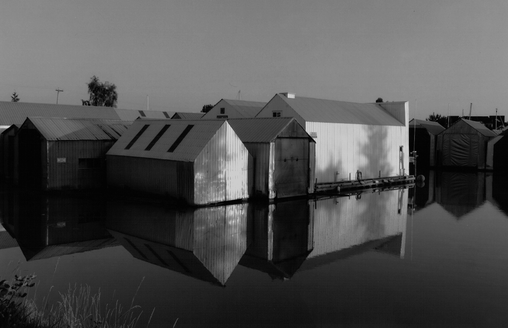

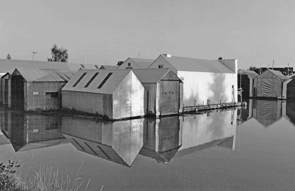

Let's see if an illustration might help. These are digital facsimiles of prints, but the middle one is very close to how the print looks on my wall.
First, this is how a print looks when you haven't given it enough exposure to for the print to have any fully black part to it - "maximum black" hasn't been achieved. Note that the darkest parts are more grey than black:
The next example is a print where I have given the print enough exposure for the blacks to achieve "maximum black", without giving it too much exposure. Note how there is a wide range of tones, from bright highlights, to well rendered midtones, through nice, substantial and weighty shadows:
The final example is the one where the digital approximation is not quite as accurate, but it should still give you a sense what happens when you give the print much more exposure than is necessary to achieve maximum black. The details that should be visible in the near darkest shadows have disappeared, the mid-tones are more like shadows, and the highlights are dim and grey:
I hope these give you a sense of what you are looking for.
